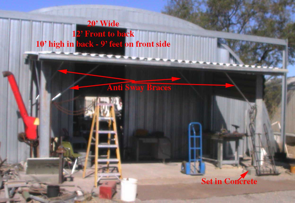

I am building a basic little pole shed for the tractor and mower..
I am setting some 3" pipes I have for corner posts, and was thinking of just spanning the 20' with 4" C Purlins that I also have and just screwing the tin to the top. Will the 4" purlins hold a span that long, or do I need to go to a larger purlin?
My tin is 26" x 12'. I was thinking of going 10 sheets wide x 1 sheet long. With like a 1' drop from rear to front. I want to just use the 4 posts on the corners without putting any posts in the middle to keep all of my space open if possible.
What say you folks ?

Daniel,
I'd say your pushing it with that large of a span. The purlins might hold it, but any bad weather, especially wind, and you'll have some flexing or worse.
If you build a truss instead of the C channal, you should be able to make the span fairly easily. Think along the lines of two horizontal purlins reinforced with a bunch of triangles along the length. The triangle shape gives it all the strength.

How about 12 ga? I have not seen and 11 ga purlin manufactured in our part of Texas. Anyway, I would have to agree with Eddie on this one, the span is much too large to span with a 4" C Purlin.
For reference purposes, I recently designed a chemical storage building for a water treatment plant in East Texas and the span between the roof trusses was approximately 17 feet. I used 8"x2.5"x16ga Z-purlins at 4'-0" O.C. to support the metal roof. The only load on the roof was that of wind and 20 psf live load from "snow." Ha yeah right snow in Texas, silly building codes.
So the Z-purlin used in my building is about "double" the size of your 4" C purlin and could only go around 17 feet in span.

With only 4, 3" corner pipe posts, your asking for trouble. Get some wind and your shed will look like a Hula Dancer.
Look at the picture, that guy spans 20' wide by 12' deep. Corners a 2 "C" channels joined into an "L". The corners are 5/8" red heads 4 on each corner. They go into the exsiting slab. Concrete was poured 18" below the slab and 5" above. Re-bar goes through the corners as well.
At the very least put on sway braces as shown in the picture. Those are 1" pipe 4' long, flattened and double bolted at each end.

More typical to nail a longer wood across the bottom chords, but if you have a pile of 17 inch pieces of 2x I don't see why it wouldn't work, uses more nails. I'd think you wouldn't want them staggered very much, or there will be flex between chords, like an acordian?
As to the old thread part of this, wow, us northern folk sure have to build a lot more than you southern folk can get by with! Four corner posts, 20 foot spans, 1 foot drop on the whole roof - that wouldn't last through most Novembers up here, much less a full winter. ;)
As to the picture of the shed awning; why in the world would someone build a 9 foot high awning in front of a good shed with a (looks like around) 12 foot high door???? What a waste of resources to limit the door to 9 feet.... (As a farmer, equipment keeps getting bigger, shed wall height is always a miserable limiting factor in what you can get inside a shed.)
