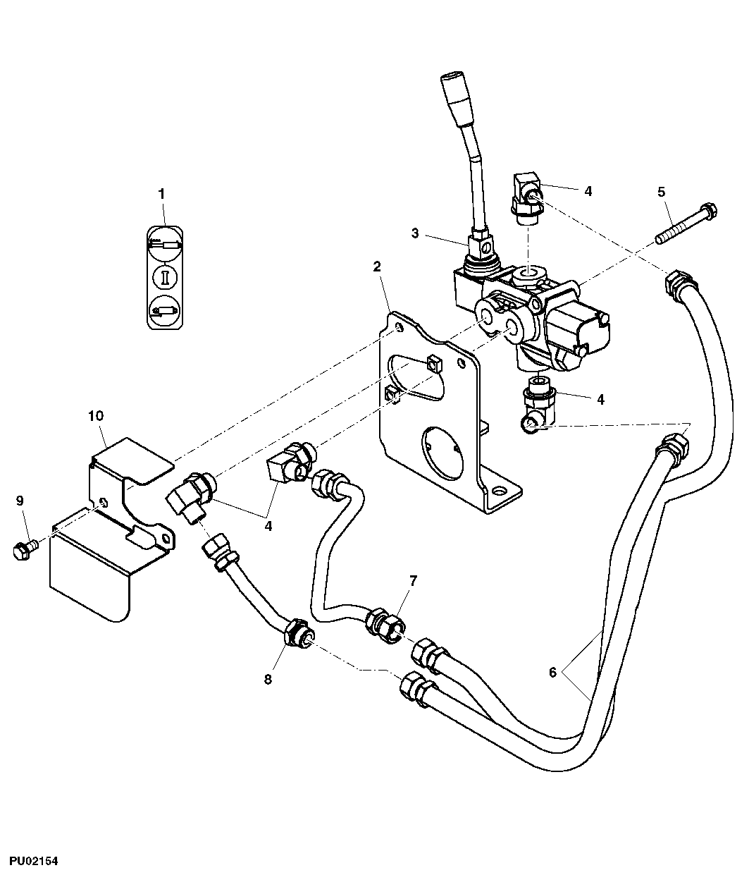

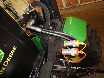

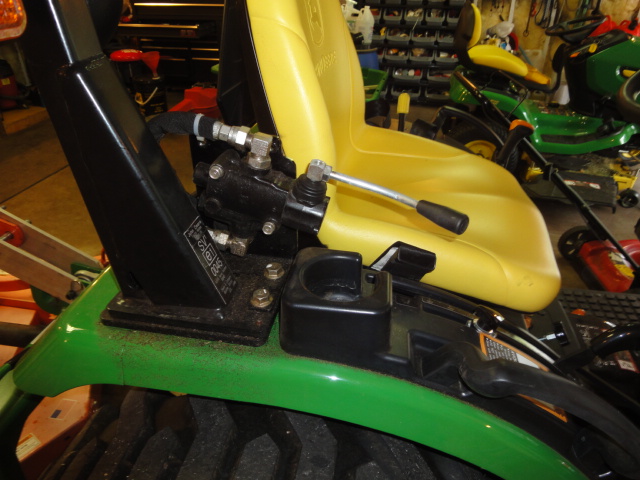

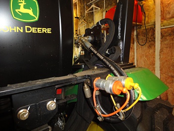

I have both power beyond and a 3rd scv installed on my 2520. Something just don't look right to me. I know the plumbing is wrong. Would any body have any pics or info on how this should look? Having to tie the 3rd scv valve open with something to get power beyong seems like a chessy way to design this. These are both options offered for this tractor and no where does it say you can't have both at the same time. This has been bugging me since I got this tractor. No straight answers from dealer.
Thanks.

You right, something does not sound correct. I do not see the fittings or bypass hose for the Power Beyond-I don't think it's installed;) Looks to me like only the 3rd SCV is installed.

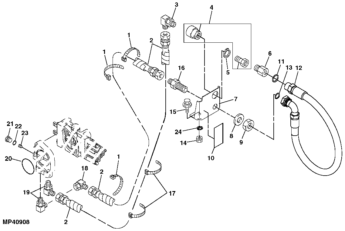

This is what the Power Beyond kit looks like:

The way the power beyond works on the 2x20 series is through a loop. When you have the BH on for example you open up the loop hose and connect the quick connect on it to the BH. The end you removed the loop hose from goes on the other BH hose. When you take off the BH you reconnect the loop hose.
So you should have a female connect on the back of the tractor and the loop hose (male end) going into it. (The other end of the loop hose is permanently attached) You remove the loop hose male end from the female and this becomes your power beyond access.
Rob

Possibly. The JDParts drawing is very unclear-it even shows all the hoses connected to itself, sort of a "perpetual" valve I guess.:confused2:
