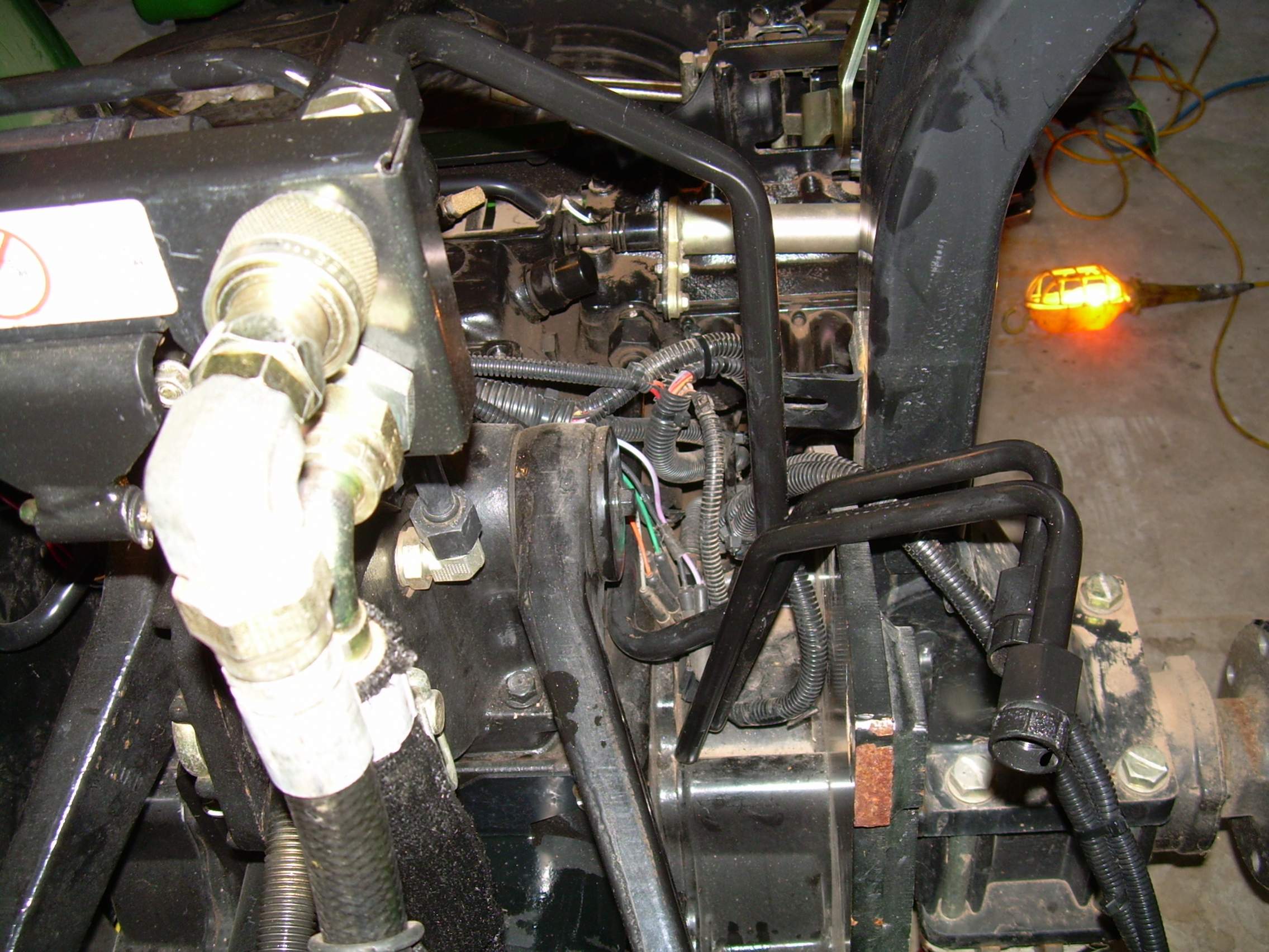

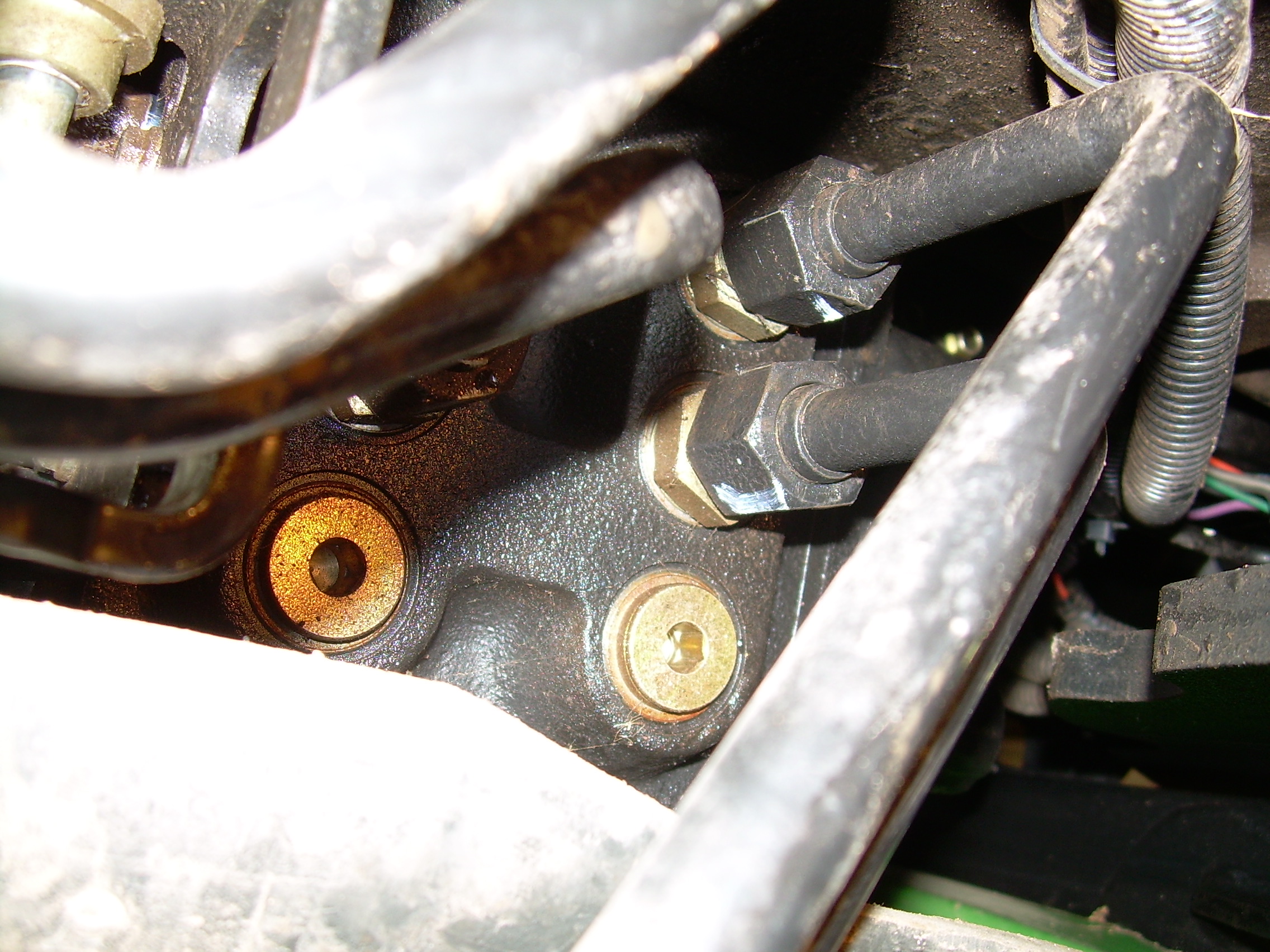

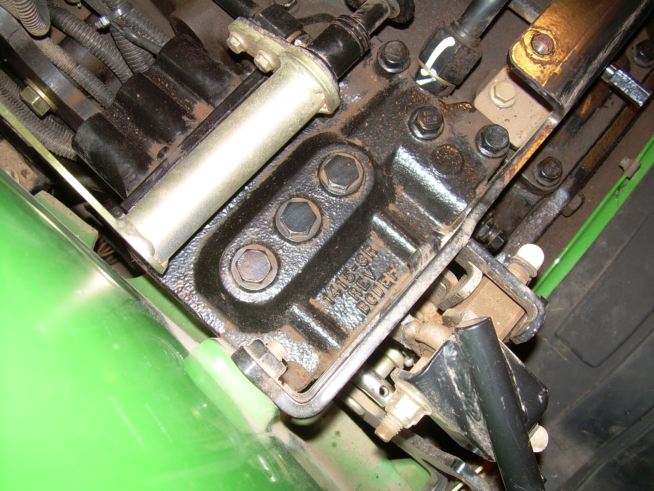

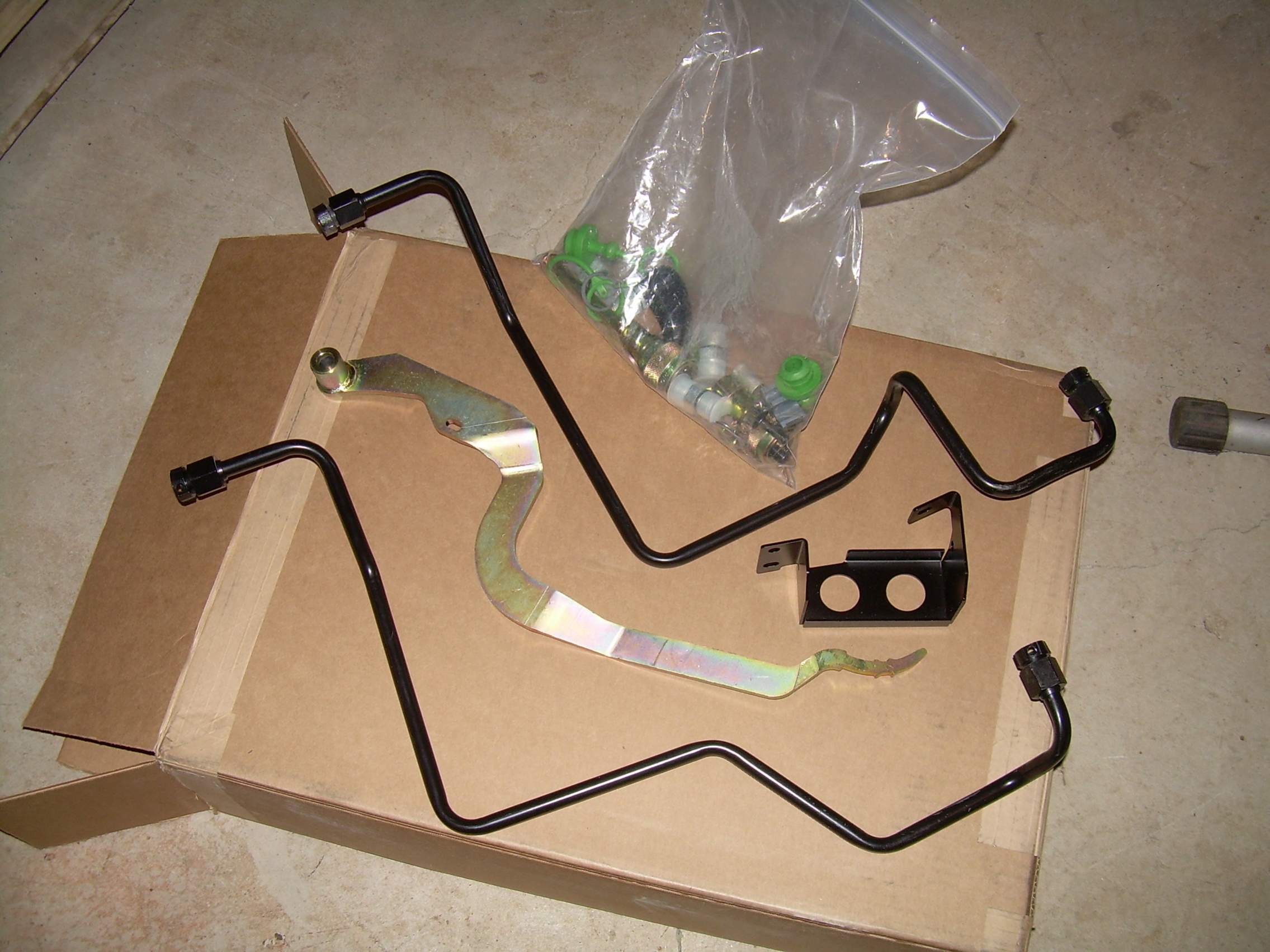

I just got a 3rd scv kit today for my JD 4310, and have a couple of questions, I only ordered the rear remotes for now as I'm trying to mount a western truck plow to my 3PT and would like to power angle it, I'll also be looking into a hyd top link for other applications.
The kit is pretty simple, only 2 steel lines with quick couplers and a lever. here are my questions,
1. when I open the boss plugs on the valve will much fluid flow out? do I need to drain anything?

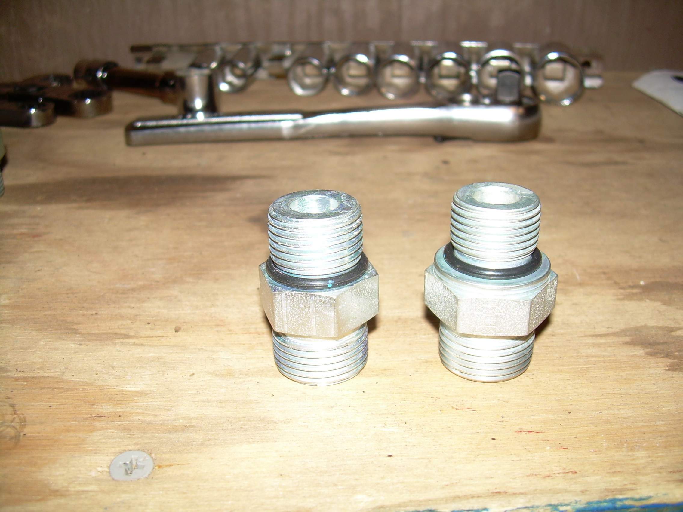

2. I'm a little confused on the straight adaptors, though I think I figured that out, there are 2 ORFS 8-8 and 2 ORFS 8-m18. all 4 have a common size thread on one side which matches the steel lines but on the other side of the adaptor 2 are one size and 2 are a little smaller and have a little shoulder between the threads and the hex part, I believe that's the side that goes into the valve?
3. Do I use teflon tape on any of these fittings or are they designed to seal with just the o-rings?
4. lastly, there are torque specs but how would I use my ratchet/socket type torque wrench on the steel lines, how tight should I make them with just an open end wrench?
thanks, JB.
Very little fluid will drip out, no need to drain.
Not sure I understand this?
No tape! The O-ring will seal the fotting.
thanks, JB.
A good "snug" will do. There is no need to bear down on them

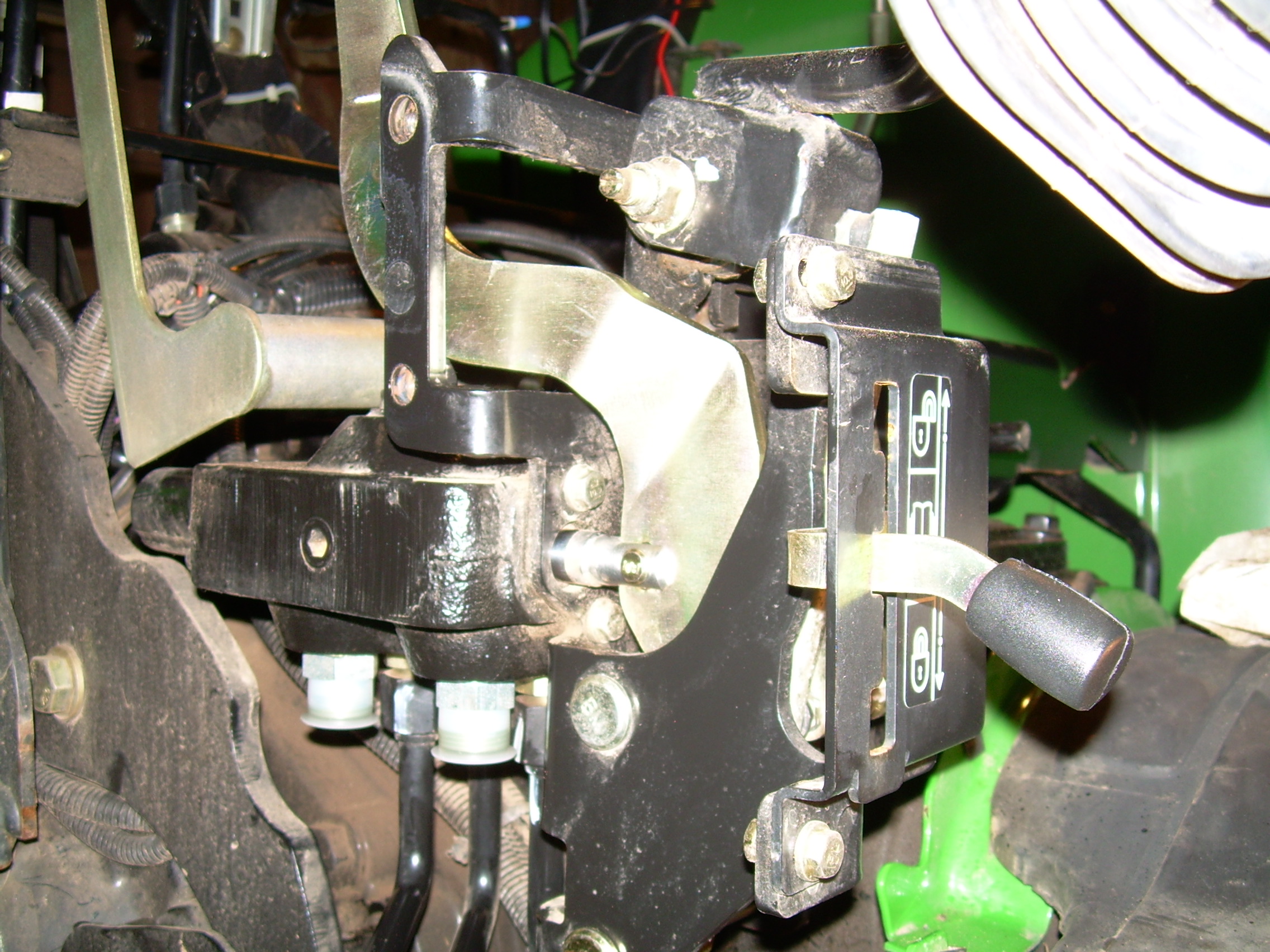

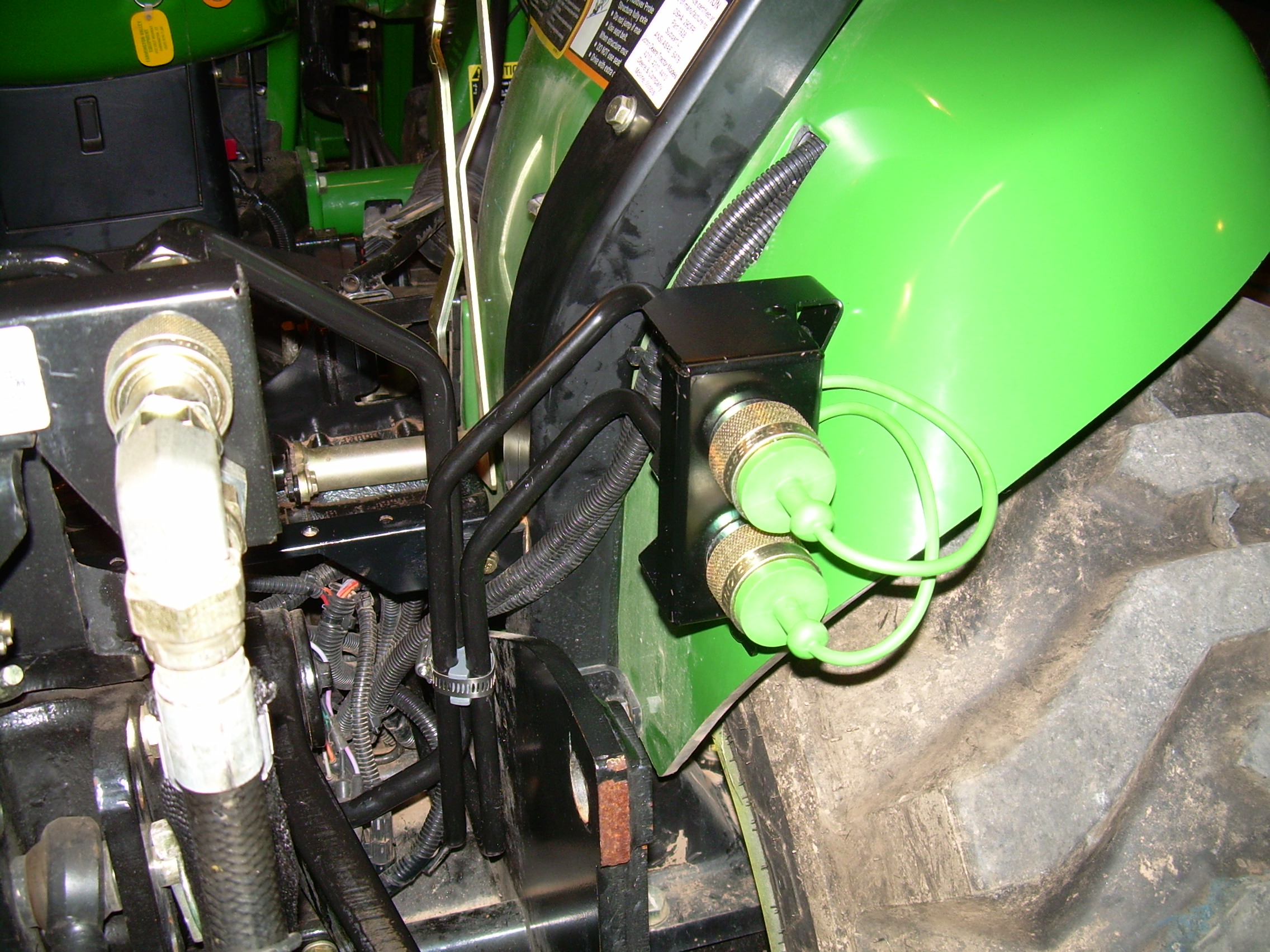

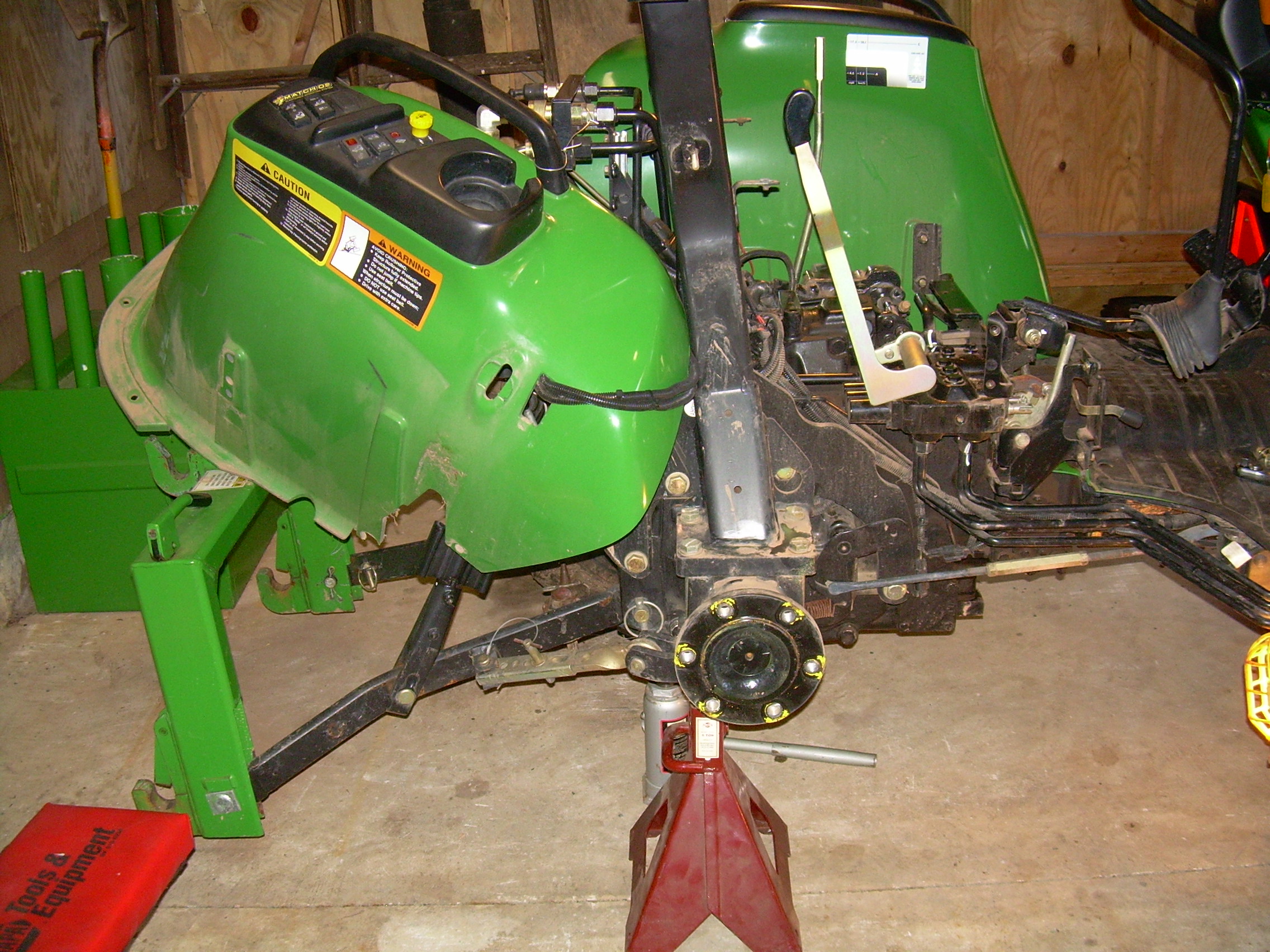

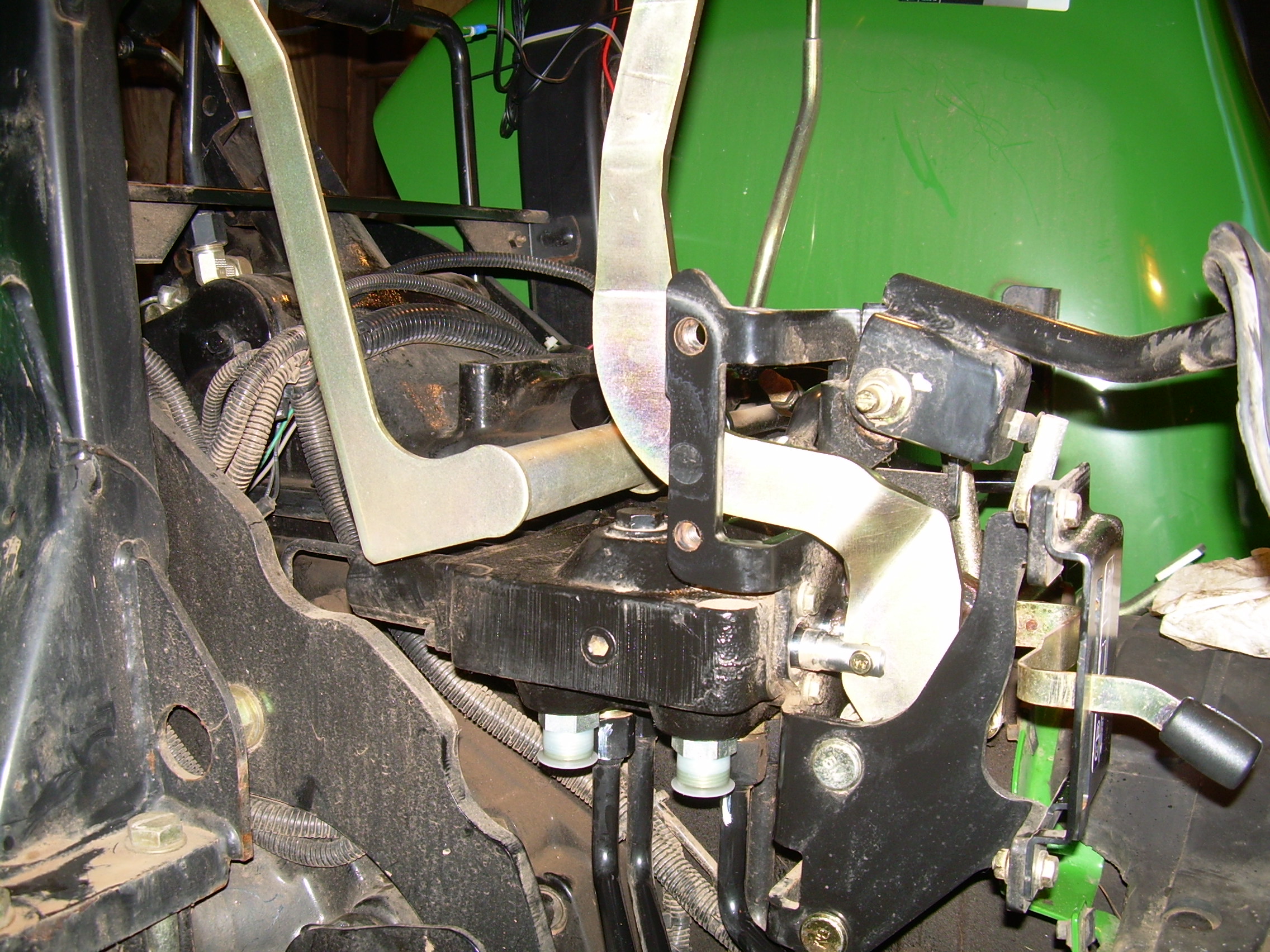

Thanks for the reply Kenny, my first post was last night but I know that's still being a little ambitious/impatient, anyway all went pretty good, I'll have about 8 hours into this but if I had to do it again it would take half the time. I did this all by myself, if I had a helper it would have been easier.
The seat was a pain in the neck and the worst part was placing the lines since I have the power beyond and the heavy steel side plates to hang the back hoe on, had to remove one of the PBY lines even then it was a trick to get them in there, the plumbing all went smoothly, good thing the bends are perfect and the surfaces matched up just right, I did snug them firmly but not crazy tight.
Still have to install the seat pan and seat so I couldn't check for leaks yet
I've heard that you shouldn't move the lever if nothing is attached to the remotes, is that true? now I just need some male adaptors for those quick couplers and some hoses to the plow cylinders, do you have a recommendation on the hose rating/type.
Thanks again, JB.

ooppss...I see know that it was in the AM...sorry to bust your chops-I could not get online this morning.
It's OK in very short burst's to test for leaks. Hold the lever in each direction for 1 or 2 seconds at a time-the tractor will bog down, that's a good sign
Just regular 1/4", 2-wire, 4000psi rated hose, do you have a hydraulic shop in your area?

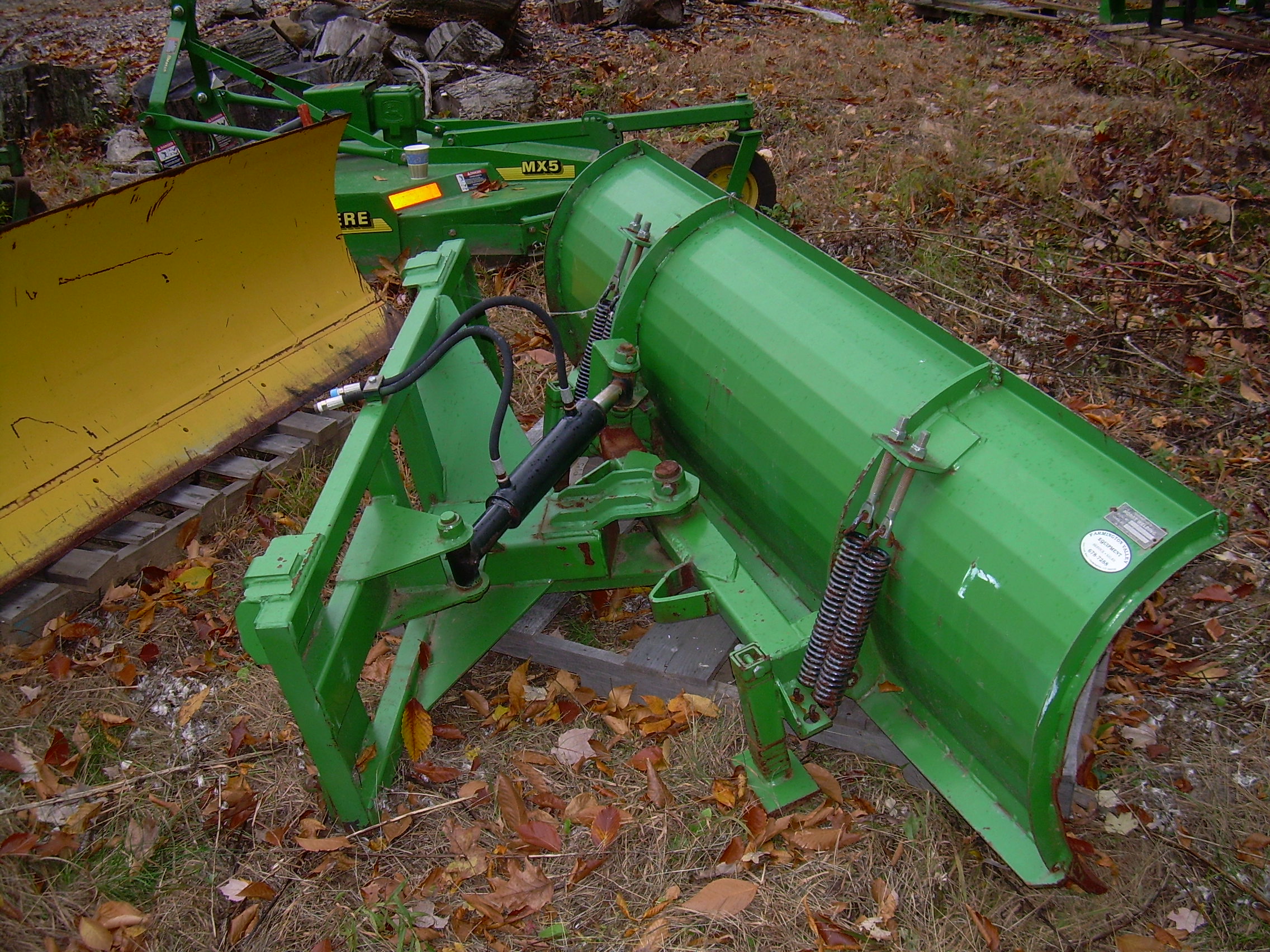

What do you think of my plow contraption, be honest, it's just an inexpensive experiment. I know from reading some of the other posts that you are no fan of loader mounted plows, neither am I, though maybe for different reasons.
I know you have a front frame mounted plow which is obviously the best way to go if you want to get serious about plowing, I had a chance to buy a factory frame mounted super HD plow/dozer for my model, the only problem was I would lose the loader and the posts though I could have modded a shared attachment with the posts.
I need my loader for material handling in even in the winter, and even with the shared attachment it would not have been an easy swap out, that's why the guy was selling it cheap, said it was to much trouble to change over.

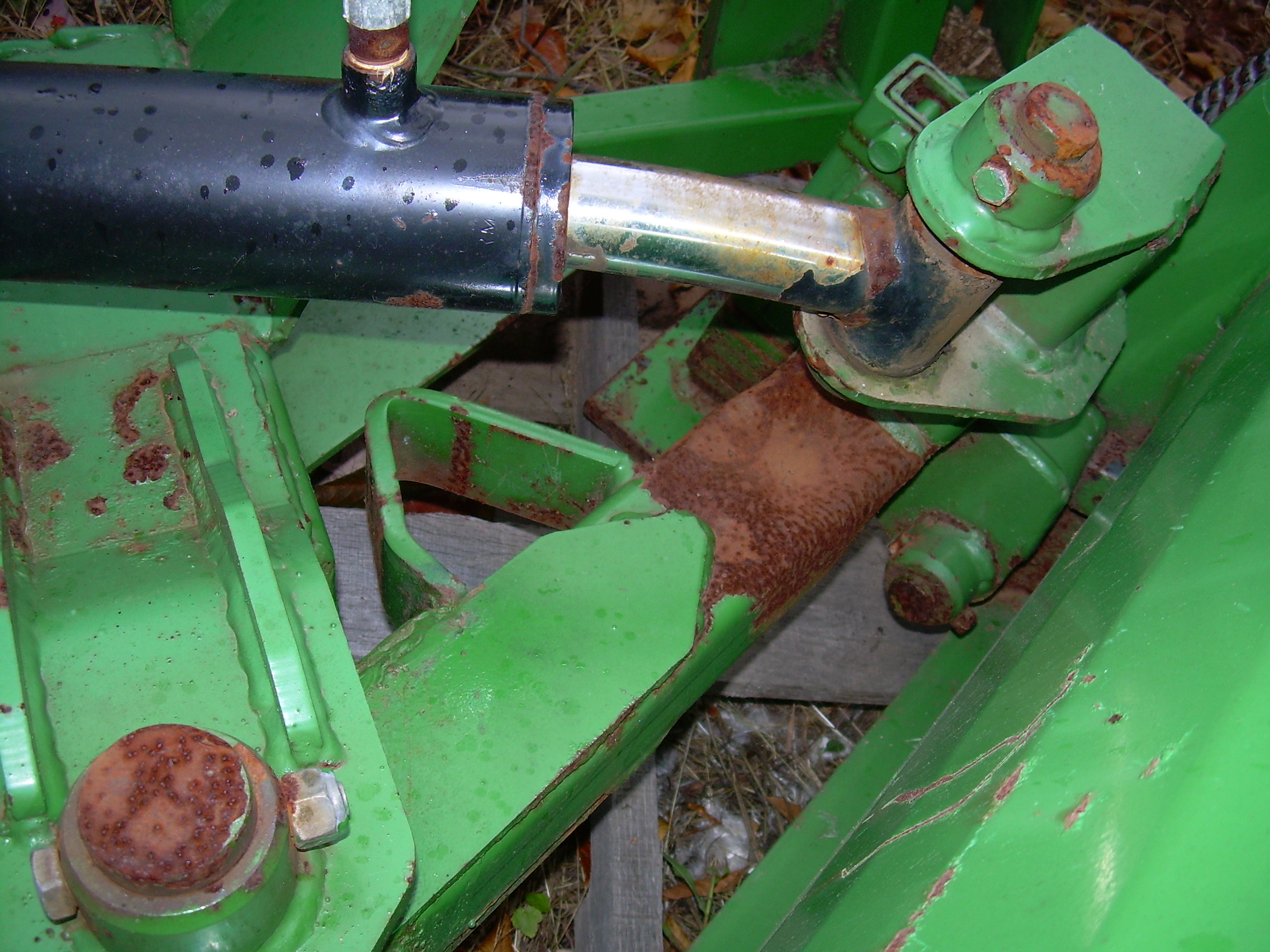

Here's a pic of a 6' 6" loader mounted plow at the dealer that was badly damaged hitting something solid, I just wonder how the loader fared. they said they would take $500. for it, made by Horst, looks heavier than all the others I've seen. cylinder is bent as well as the square frame tube.
Your plow looks like a good thought, but I think you will find it very clumsy to use. Looking backwards is no fun! I also do not think it will be enough ballast for you to properly use your big light duty materials bucket effectively. It also sticks out the back pretty far so maneuvering may be a problem. You may also have a problem with the 3PH raising up.
***You said be honest:D***
I understand the changeover issue all to well...Maybe it's time for a second tractor?;)
Yeah, I would like to see the loader frame also! He must have really slammed into something HARD to bend it like that! He can and probably will keep it for $500.
