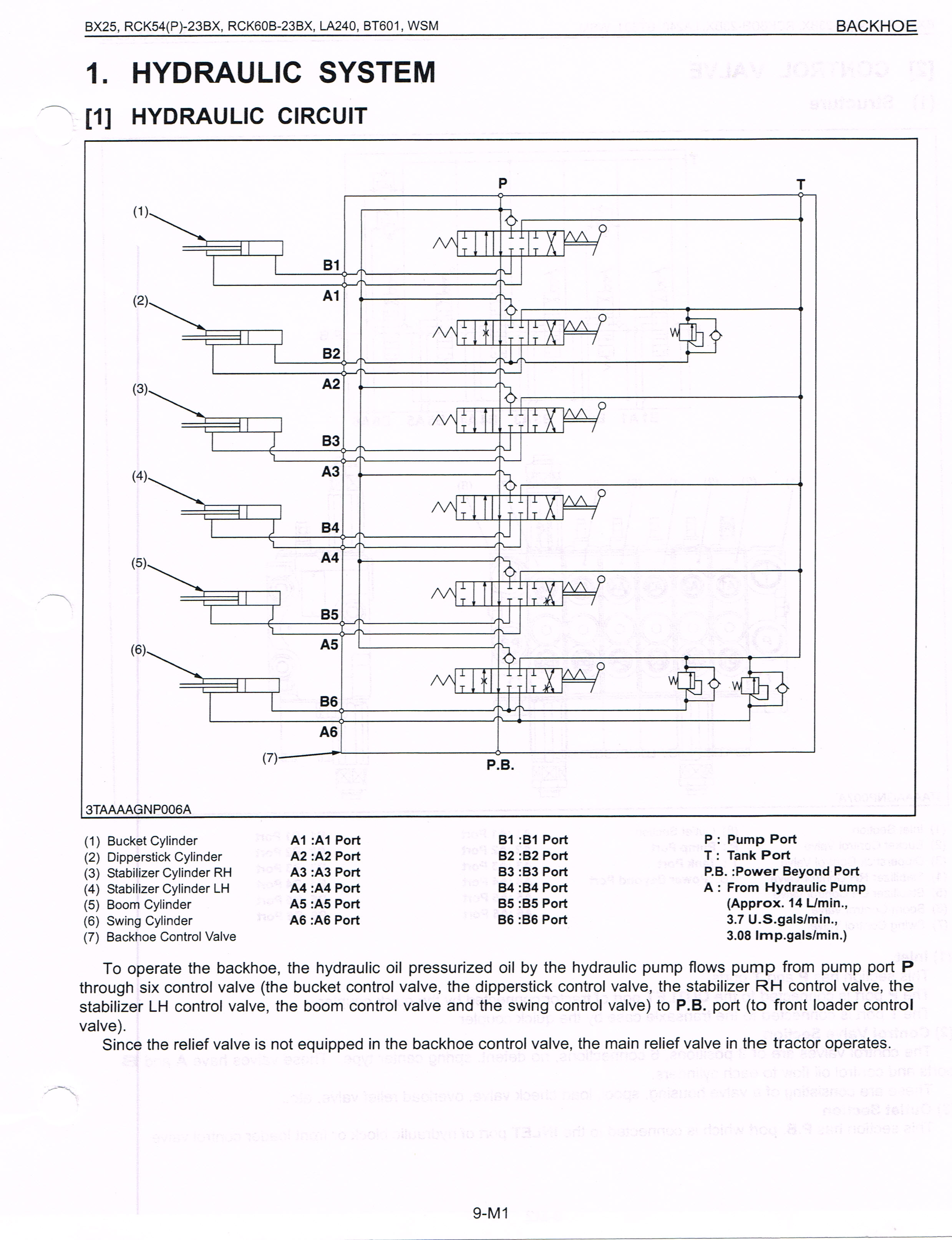

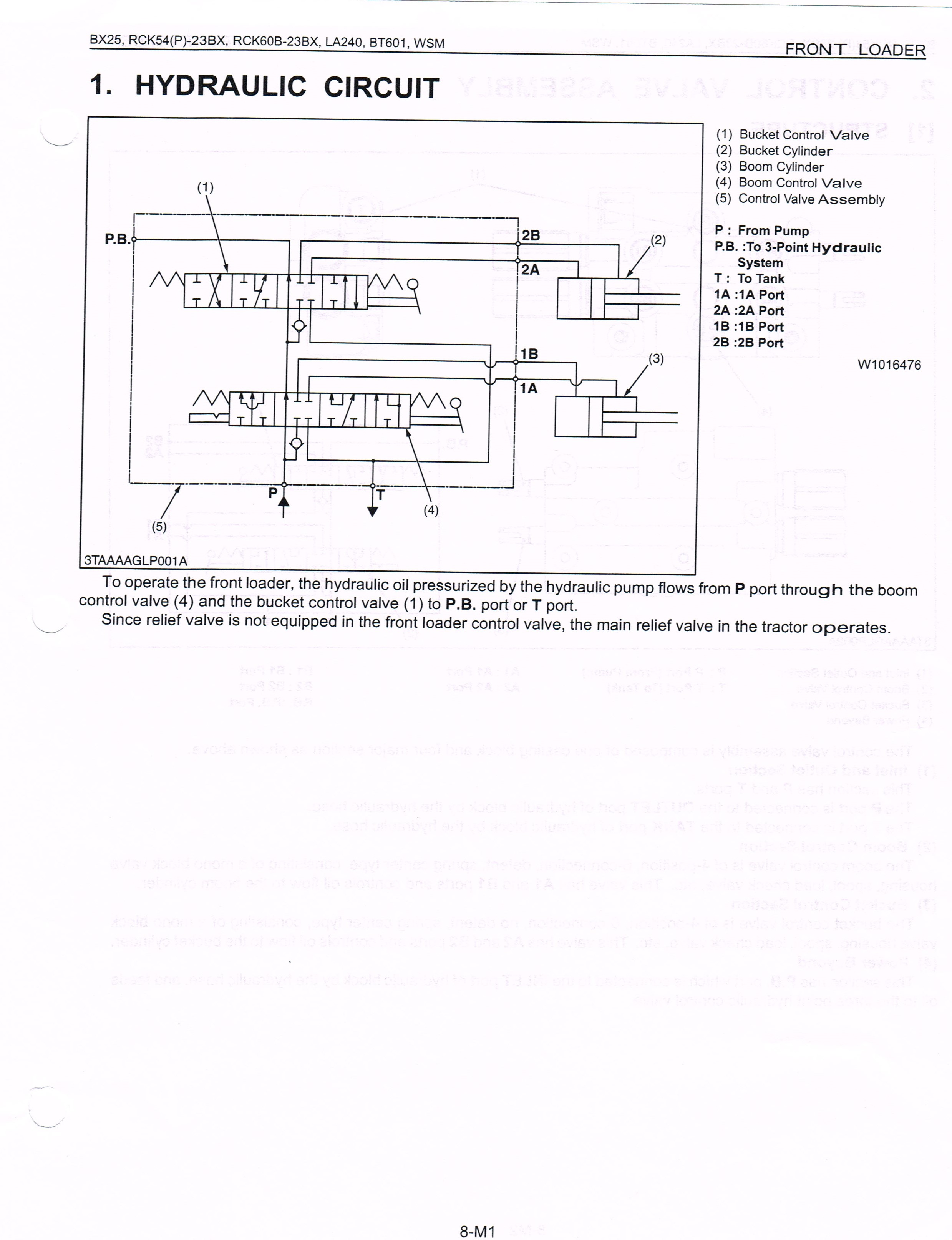

Yep, I do see now, and the flow does go to the BH first,and then to the loader. . So the BH will have priority over anything else.
There must be a relief valve on the hyd block, as it is before the BH.
I don't see a relief valve on the loader valve, but I do see three relief valves on the BH valve.
The loader also feeds the 3pt valve.

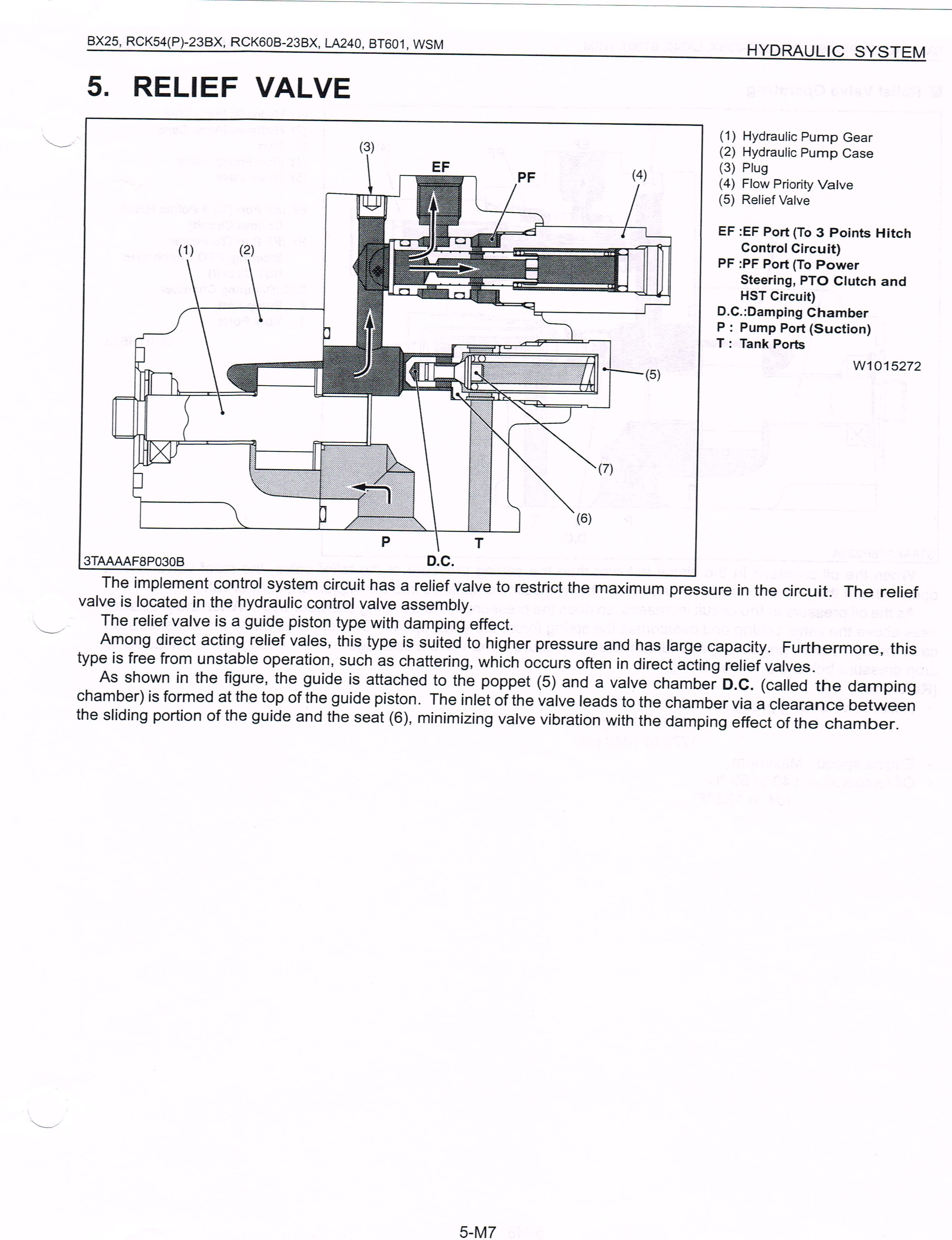

JJ, The main circuit relief is an attachment to the HST housing and it is the main relief for the attachment and 3PT circuit. What you may see as a relief valve at the BH valves is what they call a Load Check Valve in one place and an overload relief valve in another (appears to be one assembly performing both functions). There is one in the bucket valve and 2 in the swing valve. They are spring loaded but not field adjustable. The FEL has no relief valve. Attached are some more drawings. Reading the WSM manual it comes clear to me as it seems well worded and complete; I think.
