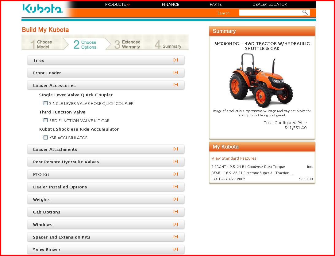

[URL="http://www.kubota.com/configurator/BuildMyKubota.aspx?pgId=1&bmId=933&sId=126"]Here is what Kubota calls it.[/URL]
The people that put together a solenoid kit call them a true 3rd function and they are used in different situations like what you are doing.
I call my systems either a diverter 3rd function system or a true 3rd function system.
I consider a diverter valve an aux or secondary valve.
Which they are when used in that manner, when used on a loader, it then becomes a 3rd function valve.

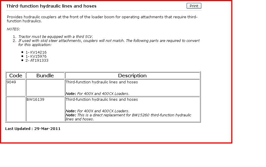

/ 3rd function valve #32
Kubota:
JD:

Thanks for the picture Kenny,:thumbsup: I don't know why my link doesn't work. :ashamed:
All that link tells me is that there is a 3rd function kit available. Do you think it might/could be used for something else.
If the solenoid and subplate kit is not used for the loader, do you still call it a true 3rd function.
I use the 3rd function term just to indicate there is a solenoid valve on a sub plate perhaps making it a true 3rd function kit.
