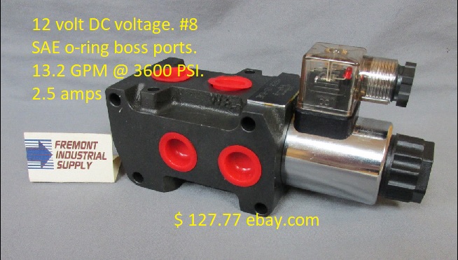

I used this type of valve. It is like an A or B switch. What ever circuit is getting hydraulic power, you have complete control over that circuit.
Inexpensive but has been reliable.
Hydraulic solenoid operated selector diverter valve 12 volt DC | eBay
Make certain when buying you know the type of ports it has.
If it is BSP then better to order adapters when you order the valve rather than trying to find BSP fittings locally.
It may not have BSP but SAE but check.
Dave
