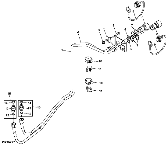

Hi Jason
Best I can do for you since I replaced the 3rd function bracket with the bracket for the diverter system on the right so I can plug the grapple lines into it without having to deal with loose lines when it was not needed. However the 3rd SVC bracket looked just like it but was narrower and only had one set of lines coming out of it.
Look in JDparts and there will be a diagram of the mounting for the 3rd SVC bracket. I have also attached a picture from the JDParts page to show you how it should mount.
Hope this helps.

/ 3rd Function Hydraulic Coupler Bracket #6
Hi Jason
Hope this helps.

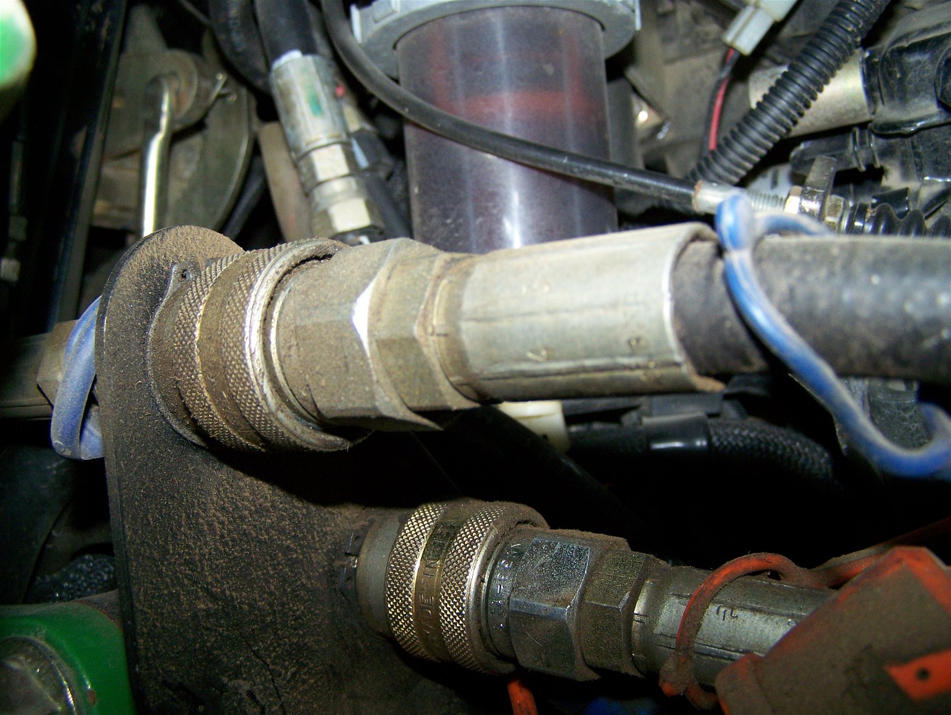

Sorry 'bout that Kenny, when he said 3rd function I thought he meant the SVC. The loader hoses should be set up to to connect coming from the top not the bottom, as in the attached picture. When I received mine it was put together wrong and I had a heck of a time trying to get hooked up. I finally found the instructions in the loader manual.

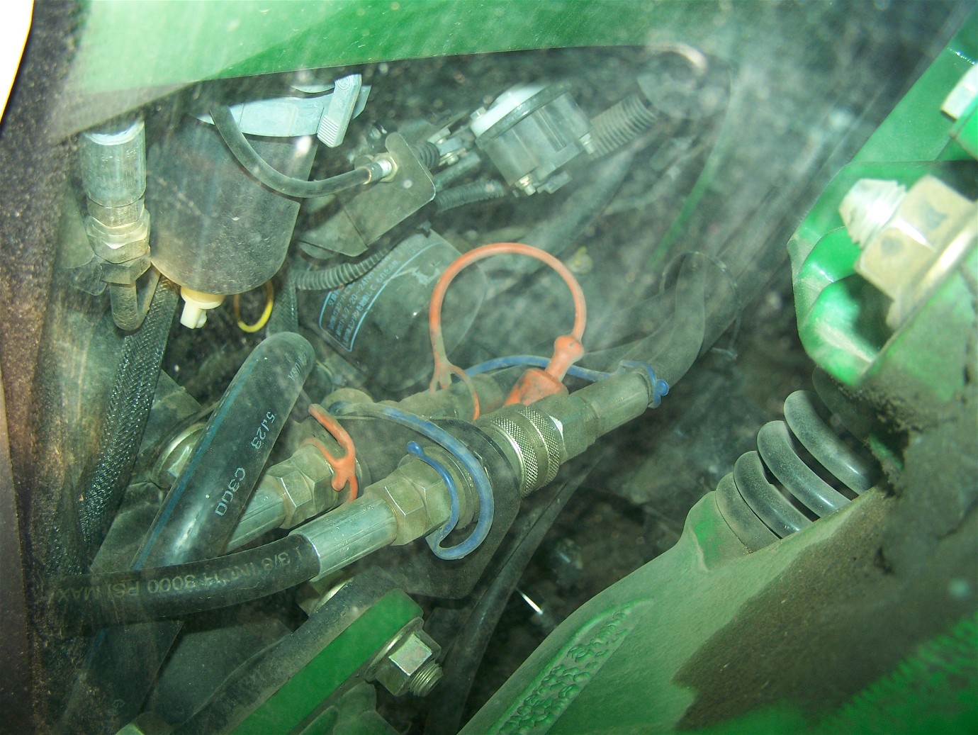

Here are two pictures of the connection of the 3rd function hoses. One from the back and one from the front. The one from the back is through the cab glass so it looks a little green. As you can see there are no 90 degree elbows in the lines. By the way, the bracket angles up from the points where it bolts onto the loader mast.
It sure sounds like the bracket is installed wrong. The 3rd function hoses should be well above the loader hoses and there is no interference at all. I installed the kit myself following the excellent directions that came with the kit. It could be easy to mix it up IF you don't read the directions and "think you know how it is done"

Thank you GreenMtns! This is exactly the way I am trying to explain it to the service manager at the dealership that I deal with....
they had my bracket on upside down, opposite of yours... see how yours points UP and out of the way of the 4 lower couplers? They had mine pointing down, in the way of the lower couplers and kept telling me that is the way it is supposed to be.... I knew it wasn't supposed to be like that, because I couldn't plug in my regular loader hoses with the elbows pointing up with it the other way...
thank you very much....
I've emailed them your pictures for proof that I'm not crazy...
