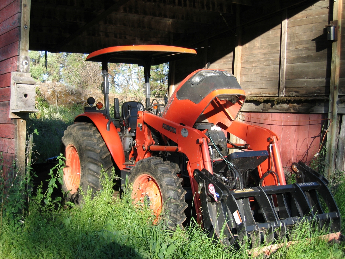

I just installed a grapple. I can see where I need the length of hose on the rare occasion I have to elevate it.
But there is a lot of excess hose dragging even after I coiled it a couple of times.
So what do you all do? Coil it more? Is there a coiled cord like we had on old land lines?
Thanks for all of you who help out.
Dear moderator or owner. Can we get an emoticon for the ignorant and isolated? It would be a good visual to highlight those like me who are handicapped by not buying a tractor until retired.

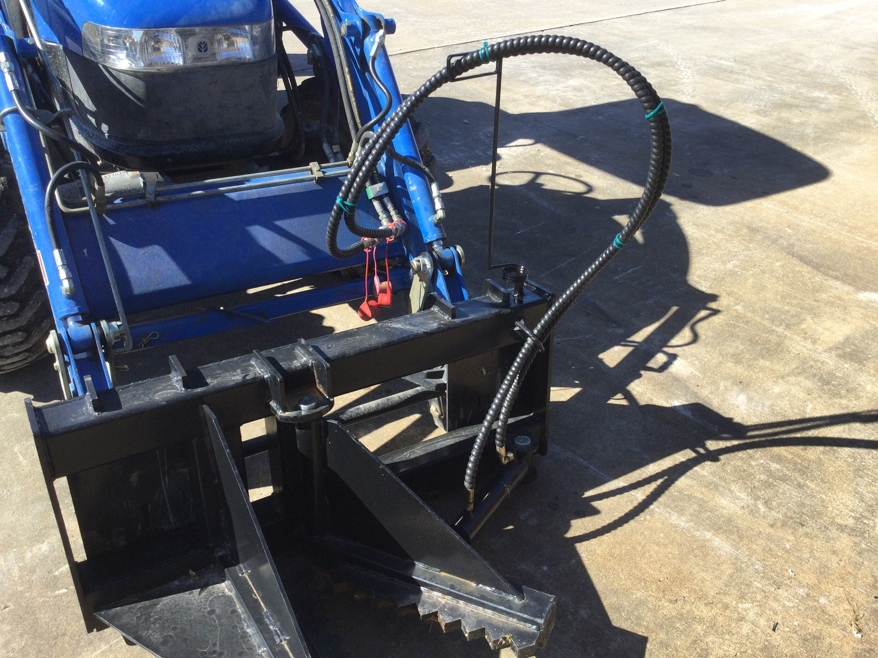

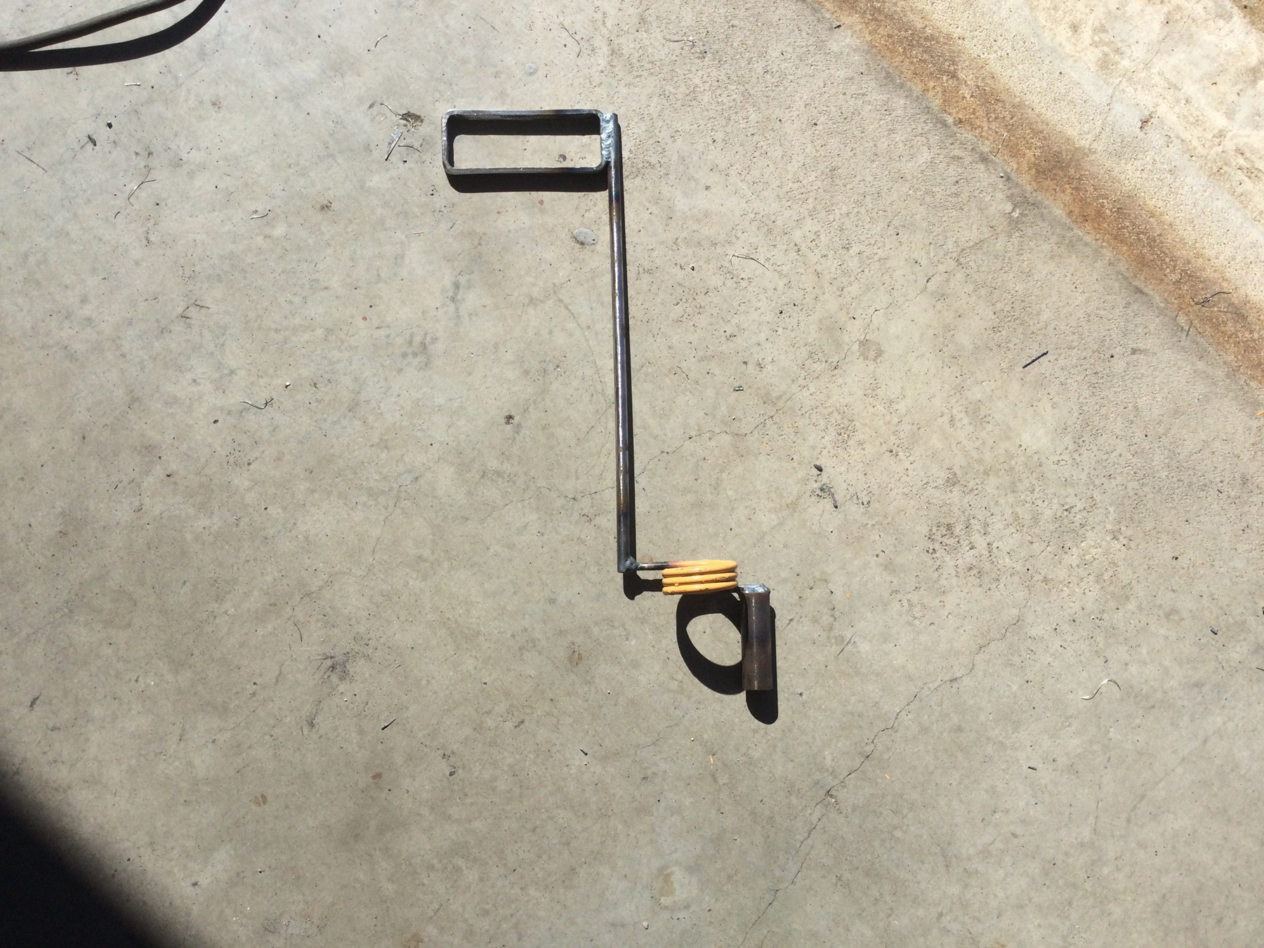

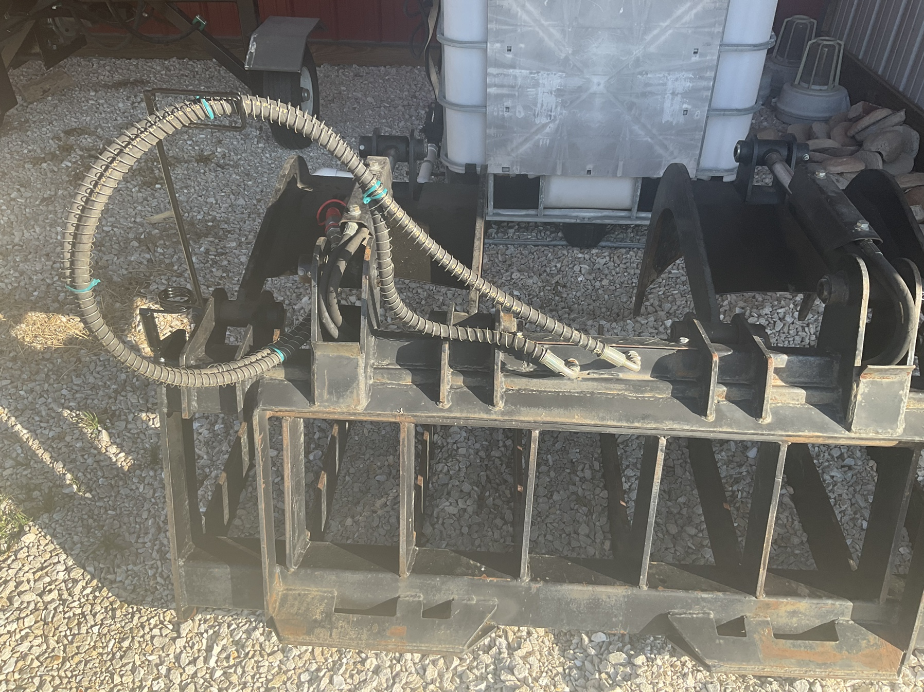

Same here. I use tie wraps to connect to the hoses. I took the hook off the hose end. The other end I bent the hook so it can't come off where I attached it to the grapple. Hoses make a "sideways S"
These are the grapple hoses. They connect to quick couples on the loader boom.
I needed long hoses for when the grapple is fully dumped. Curled back they dragged the ground.

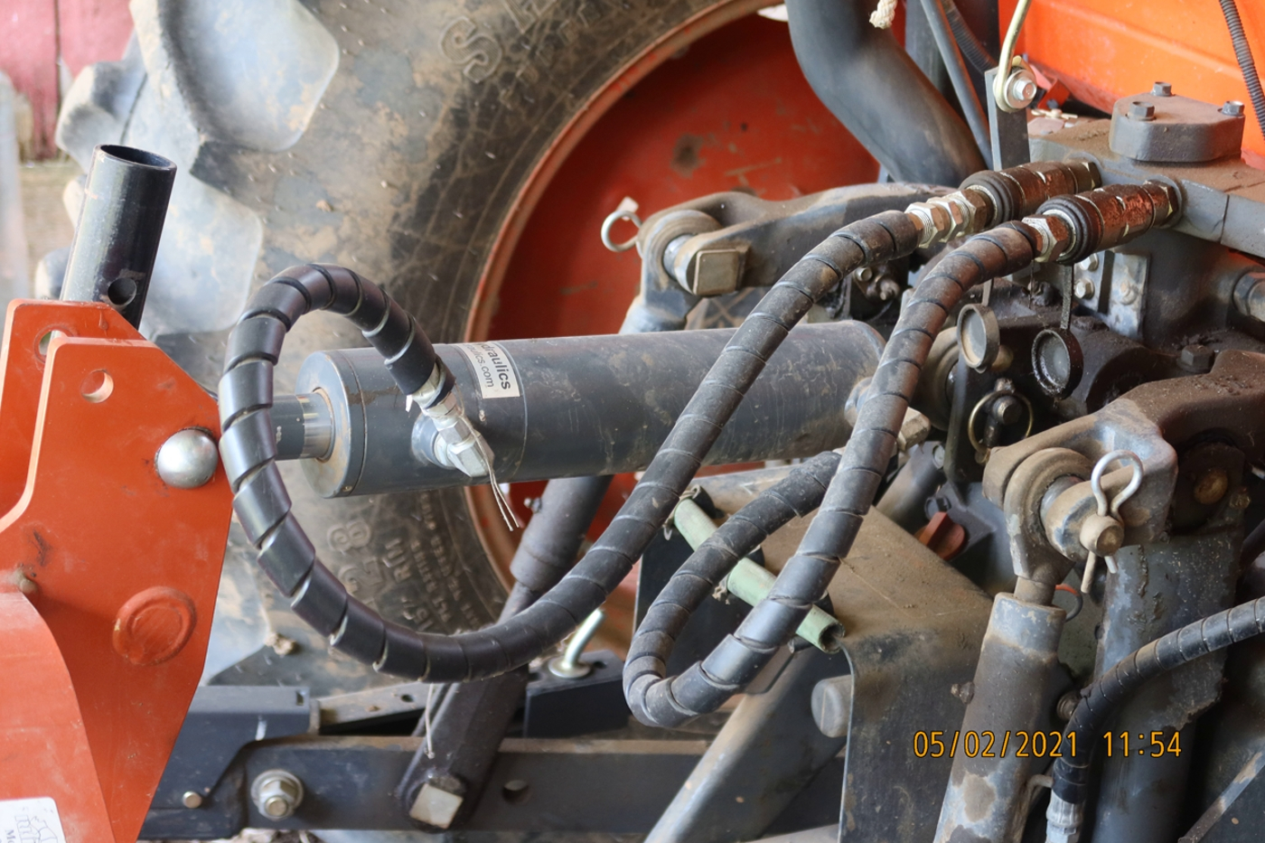

I wrap my hydraulic hoses - front and rear with a heavy duty spiral wound nylon hose wrap material. Looks similar to the old telephone cords that were spiral. Those on my 3-point don't drag. Those for my grapple are held up with double bungee cords. This heavy duty spiral hose wrap was obtained at a hydraulic supply outlet in Spokane. I've seen several types/styles of the same thing on the internet.
