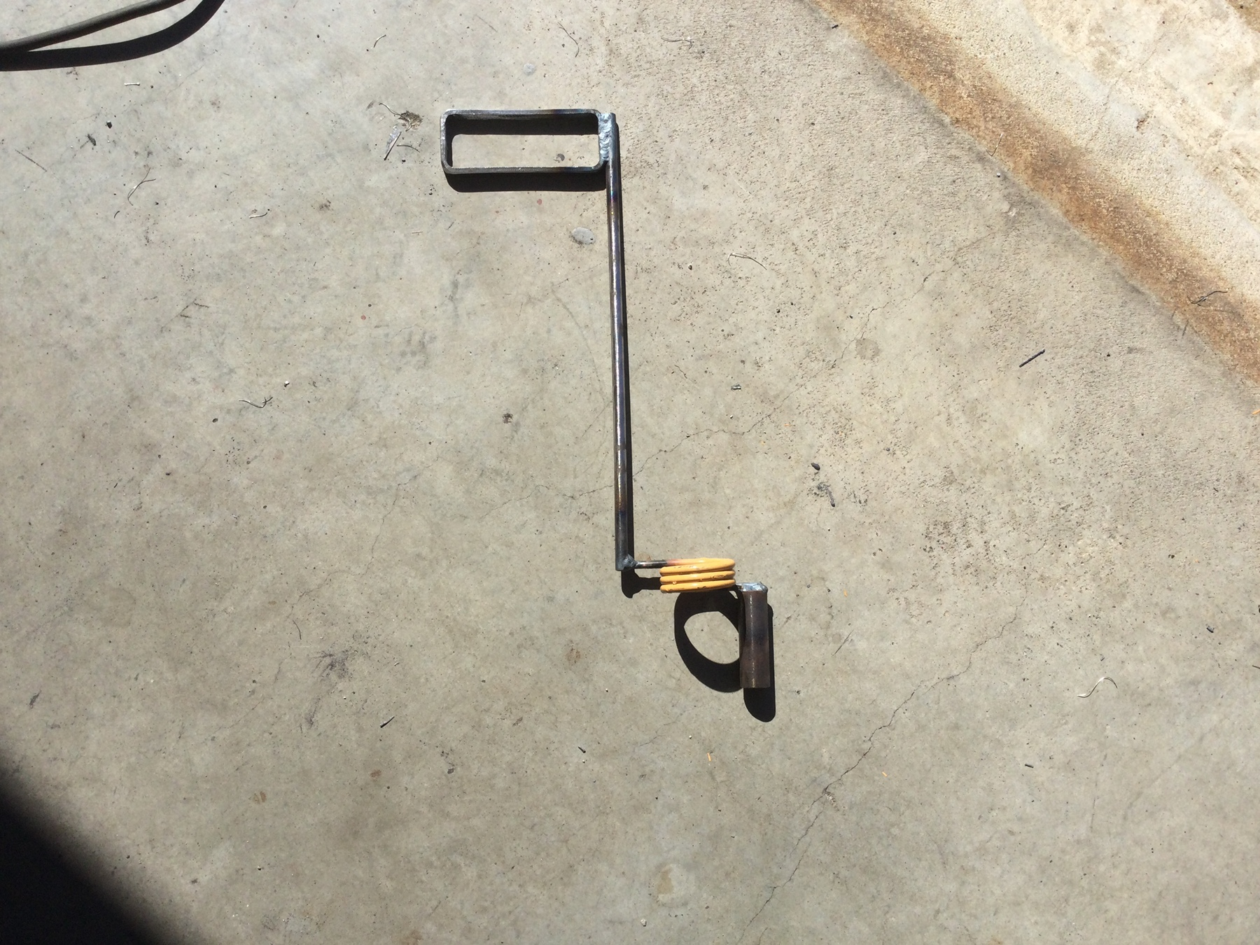

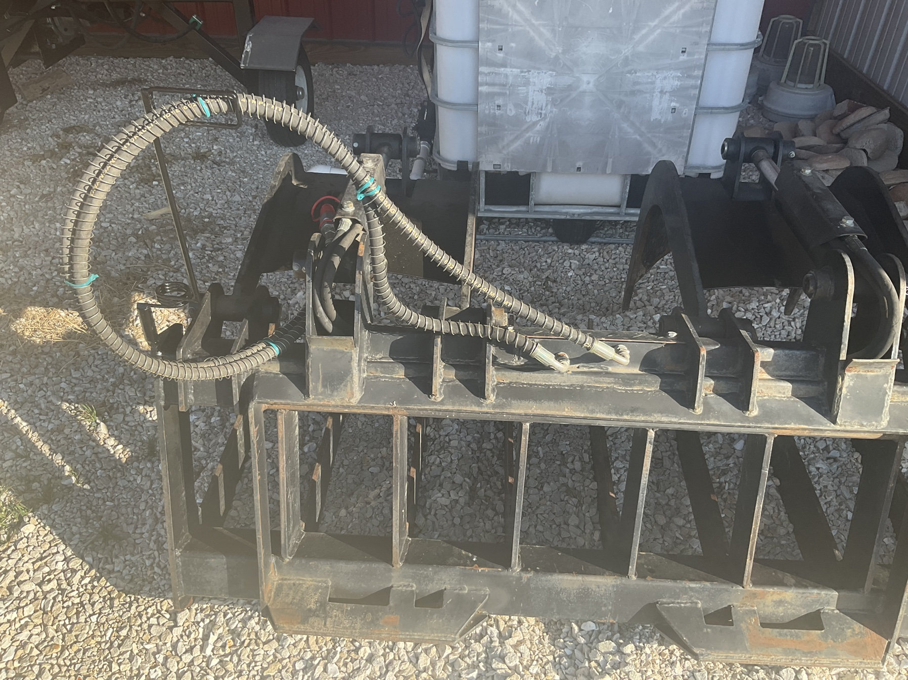

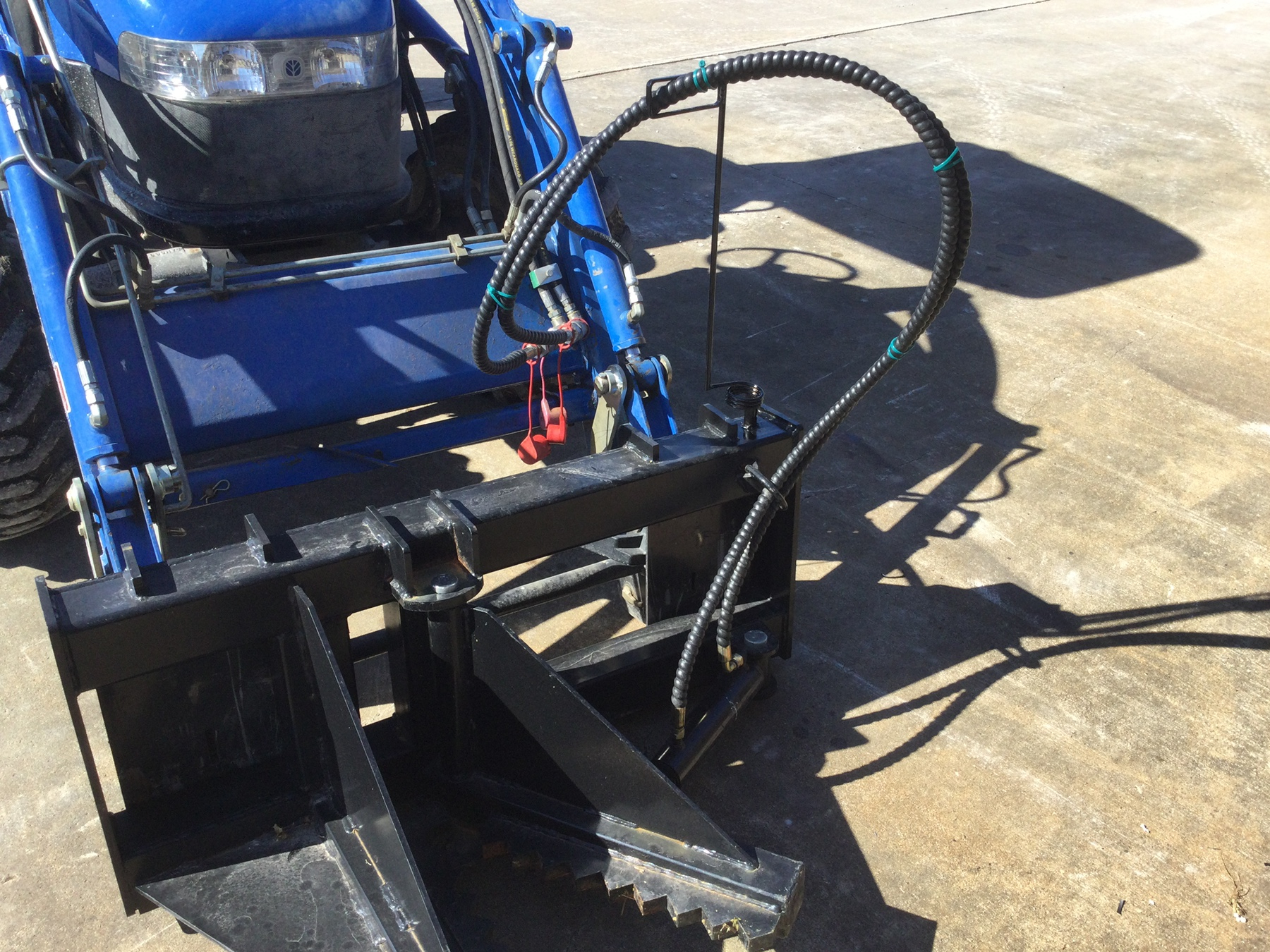

I had similar hose problems on my tree puller and grapple. Using a $3 hay rake tooth (spring) from the local farm store and some scrap steel I fabricated these. It was an advantage being able to make the height specific to the each application to deal with the amount of excess hose each situation had.
