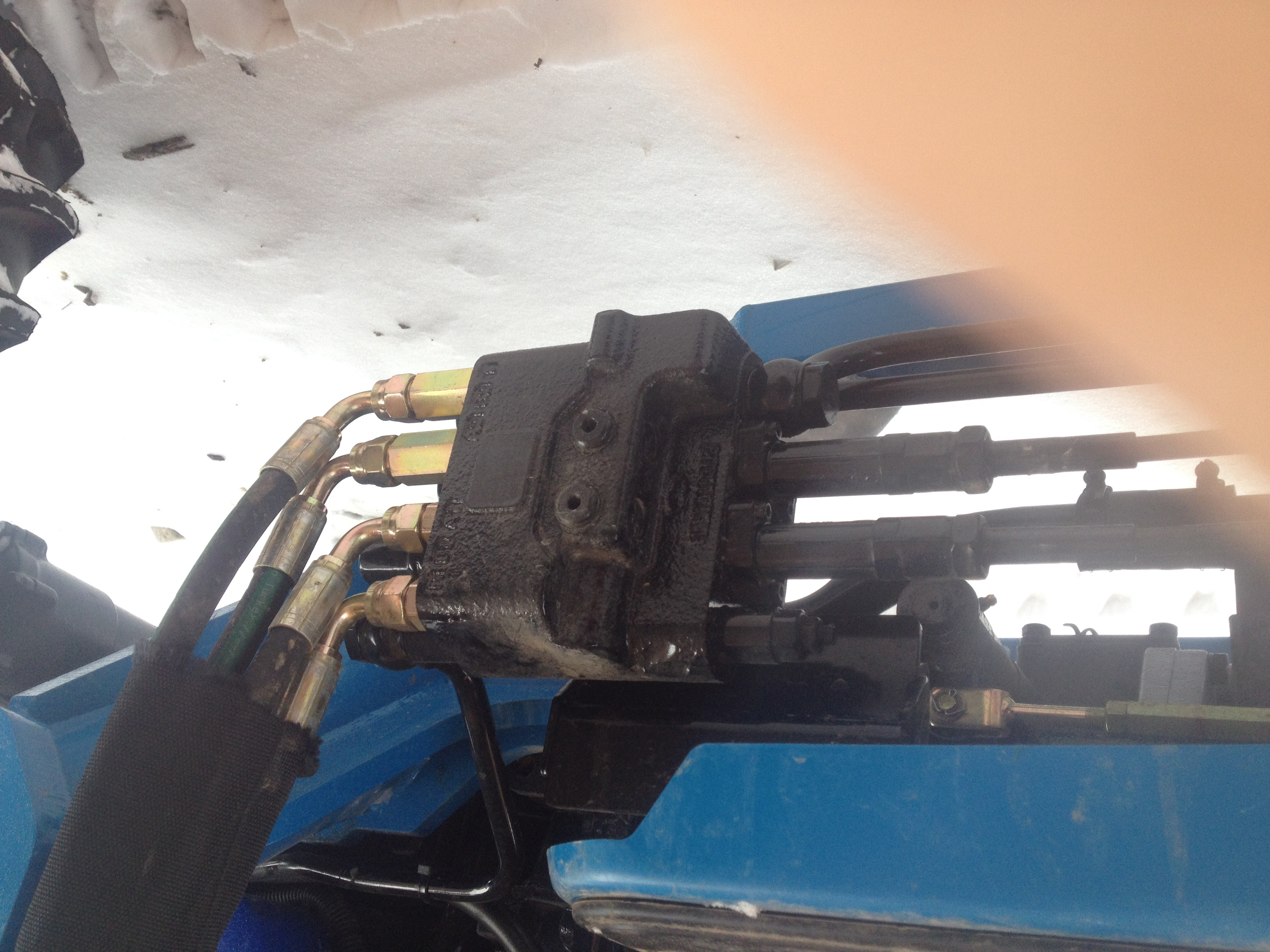

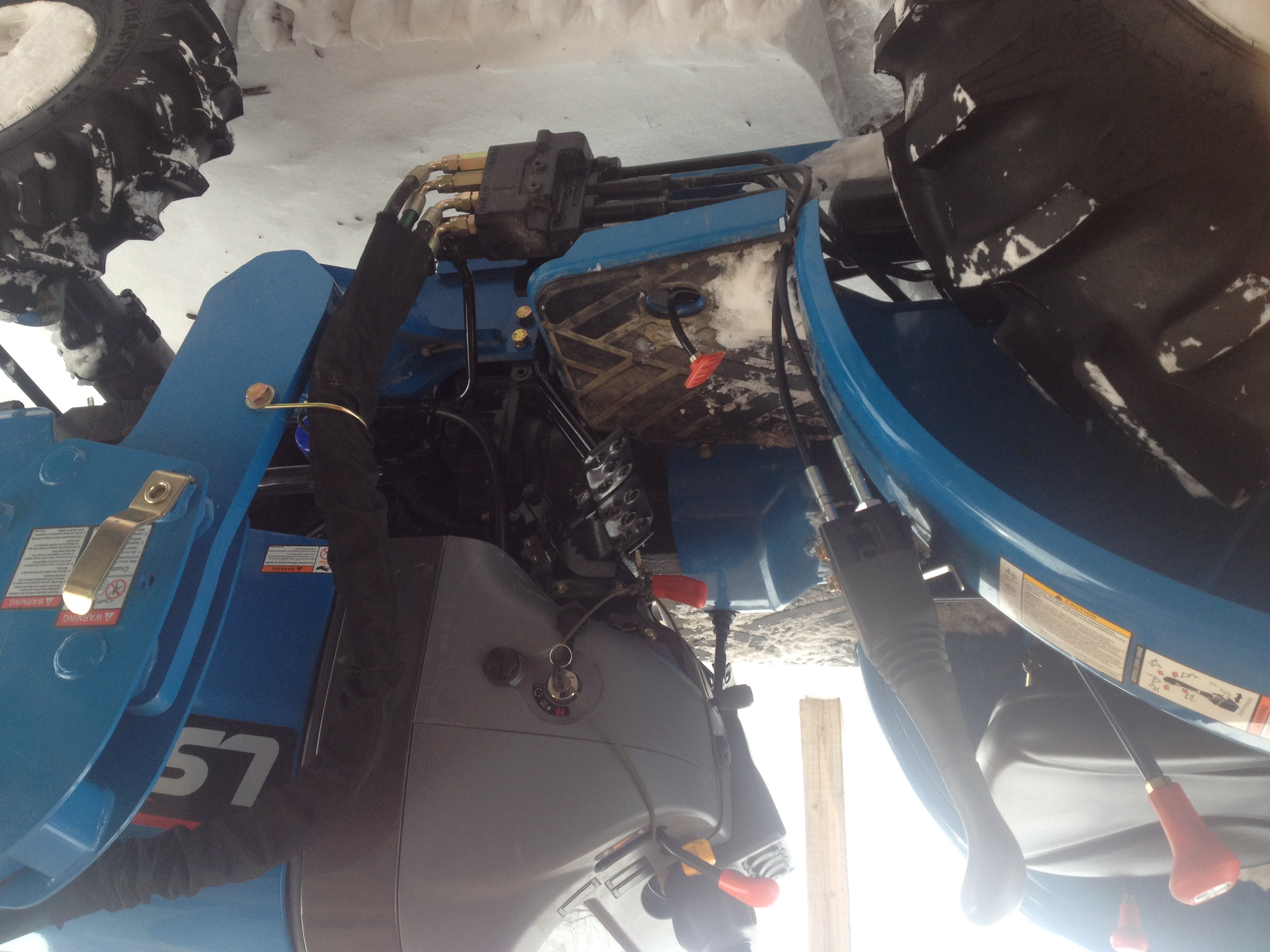

I am researching the forum for options 3rd function and while I found some very resourceful threads, I am still confused. My question is simple. What are my options for a 3rd function (not diverter or remotes) for a grapple that I am building for my tractor? I contacted my dealer and his LS kit costs $799. I believe that it is awful lot of money (isn't?) for 4ft of hydraylic hose a few couplers, a joystick addon and a valve and a bracket.
Really what are my DIY options? This picture is of my valve. Also can someone tell me which one is the PB port? Or what are the other ports in my valve? I recognize the 4 obvious ports for the FEL, and the 2 ones that go to the joystick , one comes from the front of the tractor( iguess this one comes from the pump), and 2 go at the back of the tractor
Sorry for the stupid questions.
Is there a valve that I can buy and can add on for the 3rd function? Any help that will make me realize who this valve works is appreciated. And if you think that $799 for a 3rd is not much, let me know so I can just order it from the dealer and get over it. :) Thank you!

Based on the type of control grip it has, I would guess that all it is, is a WR Long 3rd function kit.
This can be had for less $$$ from other sources, or I guess your dealer is selling it for the $799? That's seems to be about the going price for these types of valve systems.

Replacing your existing valve would actually be a pretty major undertaking. Your valve is cable operated, don't think there is a 3 spool cable operated valve (what would the 3rd cable be operated by?) So you'd probably have to end up creating mechanical linkages not to mention moving the location of the valve and re-routing hoses.
As for Power Beyond - to understand better you need to understand the basic path the hydraulic fluid makes in your tractor. This is typical & oversimplified so yours may differ slightly somewhere but it will get you in the game (so to speak)
Tank -> Pump -> Power Steering (if not fed from a separate pump/output) -> Loader Valve (Lift/Lower function then Dump/Curl function then out the Power Beyond Port) -> Rear Remotes (SCV's) if present -> 3 Point Lift -> back to the Tank
This is how things would flow in an open center system when NOTHING is activated. Any time you activate a valve (Loader, 3pt lift, or rear remotes) the flow is diverted from that path into the cylinder(s) you are operating.
Your 3rd function solenoid would go in this loop between the loader valve and the 3pt (or rear remotes). The Solenoid sub-plate will not have a separate "power beyond" port but rather an IN (or P/Pressure port), OUT (T/Tank port), and two work ports A & B.
