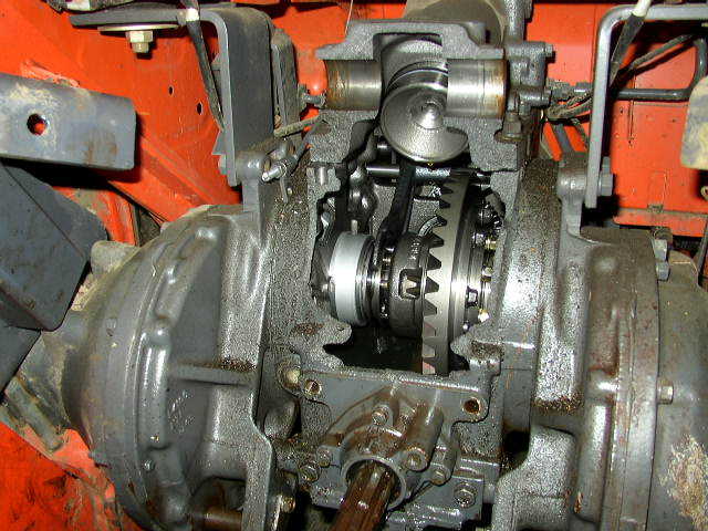

And after looking at that picture I decided to include a thumbnail.
That picture alone makes me leery of even Kubota's hardened toplink 3 point solution.

Call me crazy........ but isn't that casting broken from using a logging winch?
/ 3pt vs. frame mount backhoe #43
OK - your crazy :)
I just linked the picture - like I wrote I think this qualifies as a candidate for Myth Busters. Let them see if the can break up a CUT by using a backhoe!

I had a 3 point mounted 4672 on my B7800. It seemed pretty sturdy, I think the 3 point mount and the b series is a pretty good match. I would like some actual information on that picture. We don't know what he was doing or how the tractor was used to cause that damage. I don't know how many 3 point hoes there are from different manufacturers but it still seems like a low number of failures. Would I buy a 3 point mounted hoe for a large TLB no. Would I buy one to use every day to dig with no. Would I worry about it for occasional homeowner use nope.
Yeah, that picture keeps cropping up...it's the ONLY one I've ever seen (aside from cracks associated to defects at the foundry) of a broken casing. It's a picture that's been here forever and was caused by an improperly run winch...NOTHING to do AT ALL with a BH!!!!! Old argument brought up again. Yeah subframes are better, but I've thrown all I can at my B4672 3pt and it's never missed a beat! I have no use for a subframe, lowers the clearance and for what I need a BH for, very overkill. With a PROPERLY installed top link, I'd actually like to see what would cause anything on the machine to actually break!

I realize this is an old thread, but what I saw might interest someone considering a 3 pt. backhoe.
I was at a dealer a few months ago and there was a customer trying out a new L39 TLB. He had just brought his L2800 to the dealer for an estimate on repair. He had busted out a big chunk of the rear casting using a 3 pt. backhoe on it. His L2800 was out of warranty.
Funny thing was, the salesman I was talking to said that this was the second time he did the exact same thing to the L2800; the first time, Kubota repaired it under warranty. Seems like he would have learned his lesson !
After I looked at the big ( 6"x 6" ) hole in the rear of this guys L2800, what really surprised me was how thin the casting was. It seemed no thicker than 1/4" !
Just my guess, but I'll bet most of the older tractors have castings twice that thick or more.
At any rate, I know I'll never consider putting a 3 pt. hoe on any tractor of mine; just too risky in my opinion.
