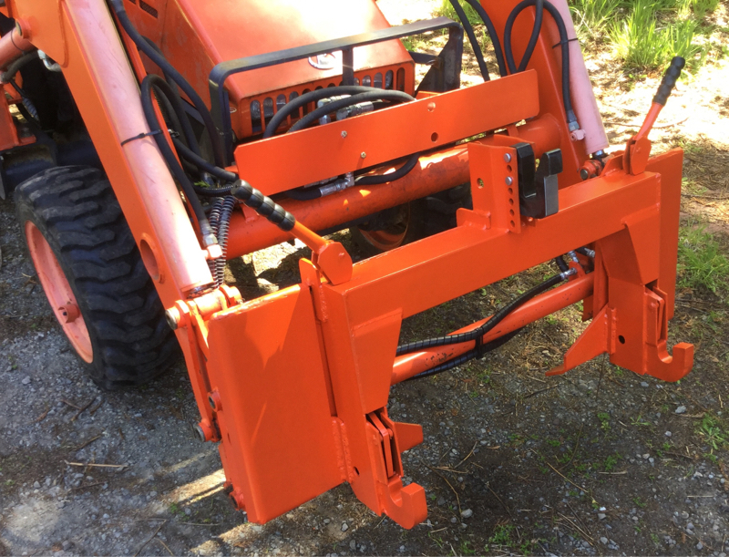

Handy for lifting & working on implements (would stick a board under the loader for safety if I was under things). Also makes a nice pivot for a plow so it can float (plow also had side to side float about 15 degrees naively & a trip blade to prevent problems running into things.

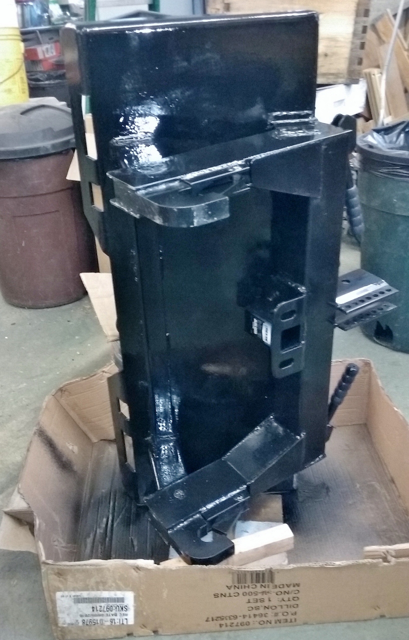

I made one with a small amount of rollback. I use it mainly with a trailer mover for moving my dump trailer, but also for parking implements. It is very handy for a yard rake also. I used a Titan ssqa plate and a HF QA. Under $200. Welded and painted in a few hours. Commercial versions go for in the neighborhood of $1000.
I see your top hook on the QH is notched out. Did you do this to clear some obstruction on one of your implements? Or does it help to hook up easier?
   / 3pt stuff for your Loader.
#25
It comes that way from Harbor Freight. I'm impressed that the HF Quick hitch is well made. This new one I got is nicer quality that the first one, and the first was OK quality.
Most of my old 3 Pt stuff will not work with this hook, It would make a nice lifting hook but that all it is good for. I use the Hitch Adapter bracket in the Photo's Item 29309 from HF (888-866-5797), sold separately. Why it is not stocked in their stores is beyond me?
That's why I am welding it up to the plate as shown vs. just attaching it flat against the plate.

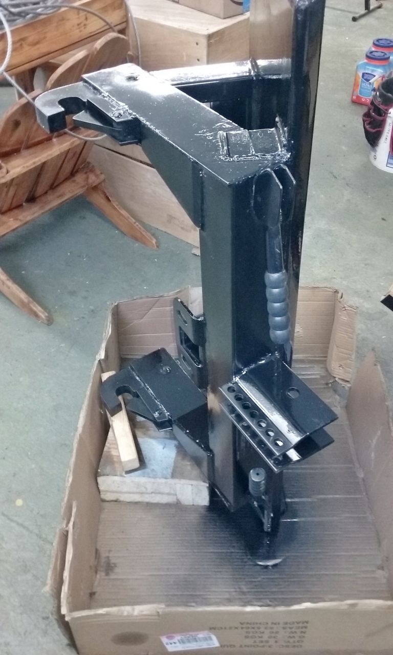

Welding day.
We almost finished before it starting snowing again. I took rear chains of my little Max28 with R4 Tires and it was sliding all over the road to my freind's garage.
I pushed back the snow banks in is driveway as he did me a big favor welding. He is way better welder than I am.
I came back to my shop & ground off the weld spatter and gave it a light coat of Rattle can spray paint to keep it from rusting.
This thing should prove handy.

   / 3pt stuff for your Loader. #35
Nice, looks like a lot if extra roll back in there. That will eat up lift capacity, but allow you to curl a lot more. Really can't curl past vertical with most loader geometry at ground level. I'll probably add some if I ever build another.
#36
I have over 2500 Lbs of lift capacity.
I'll loose a bit of lift height. I tend to use a bracket vs a hook for the top link, hence the desire for roll back.

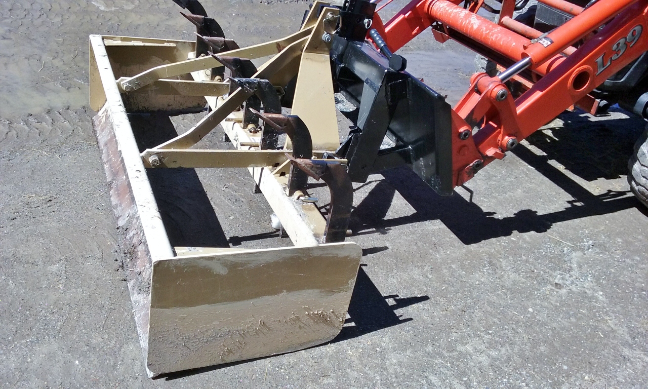

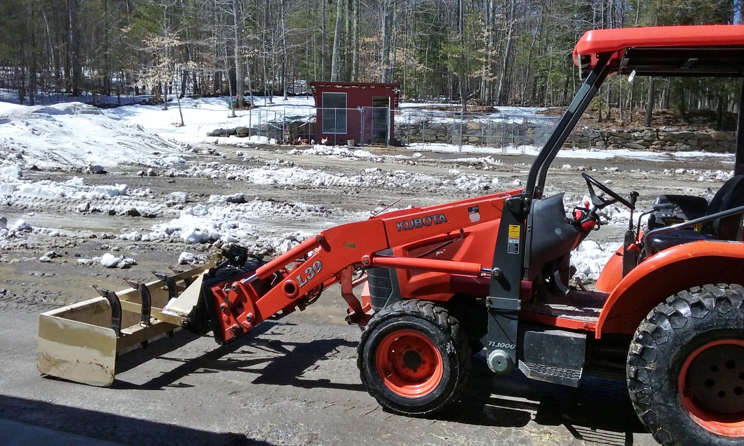

Welding day.
With a box blade on the FEL, I found it easier to grade my driveway and the BB is way better at acting like a dozer blade than a bucket. Back dragging in float, the BB does a good imitation of a land plane.
I spread tons of snow to melt, dragging ;lots of gravel back where it should be.
With the Little Max28 and the RTV900, this afternoon we scraped up at least 10 tons of cow manure.
Everything including me smells cow poop and I just showered. I'll be getting the pressure washer out for the equipment.
