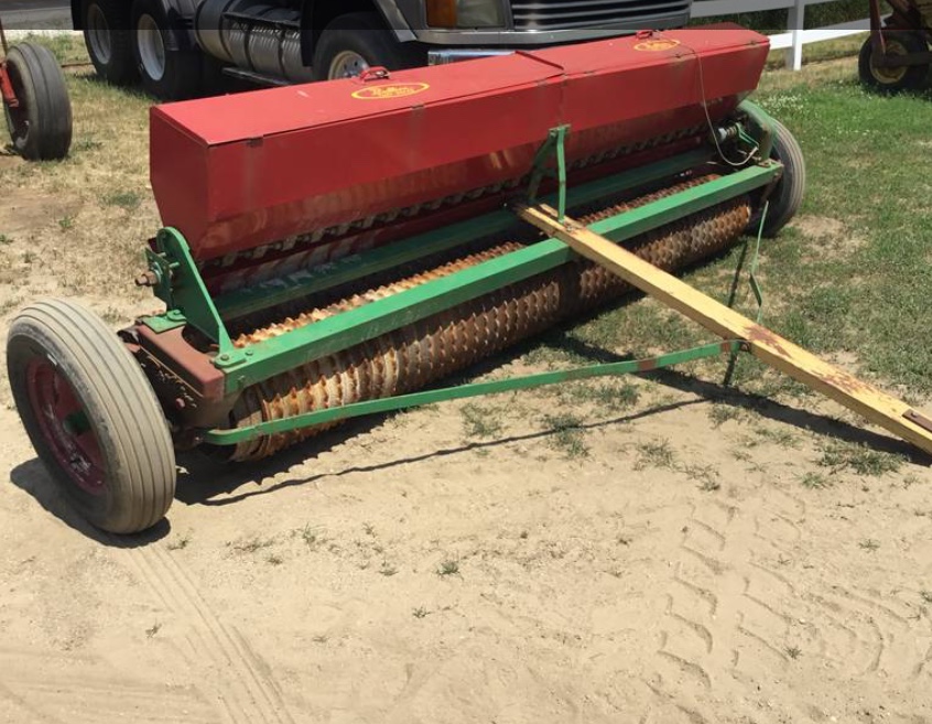

Hi all.
I am in the process of reclaiming some old pasture, about 13 acres of grass. We want a few cows and who knows what else out there. I hired the neighbor (great guy) to plant it. He charges $18/acre, I do all the ground prep....I have another 20 acres to go. Some places he planted are great. Other parts are spotty and in some places the grass is missing the entire length of the field....a planter wide.
Will a 3pt spreader and cultipacker work as good as a planter? I am not going in to the hay business or but I want a good job. Here is an old 10ft Brillion planter I was looking at. Should I have him plant it, then I go back and spot till/overseed/cultipack or should I just buy a planter and be done with it. I still have to buy the 3pt spreader and he will loan me the cultipacker whenever I need it.

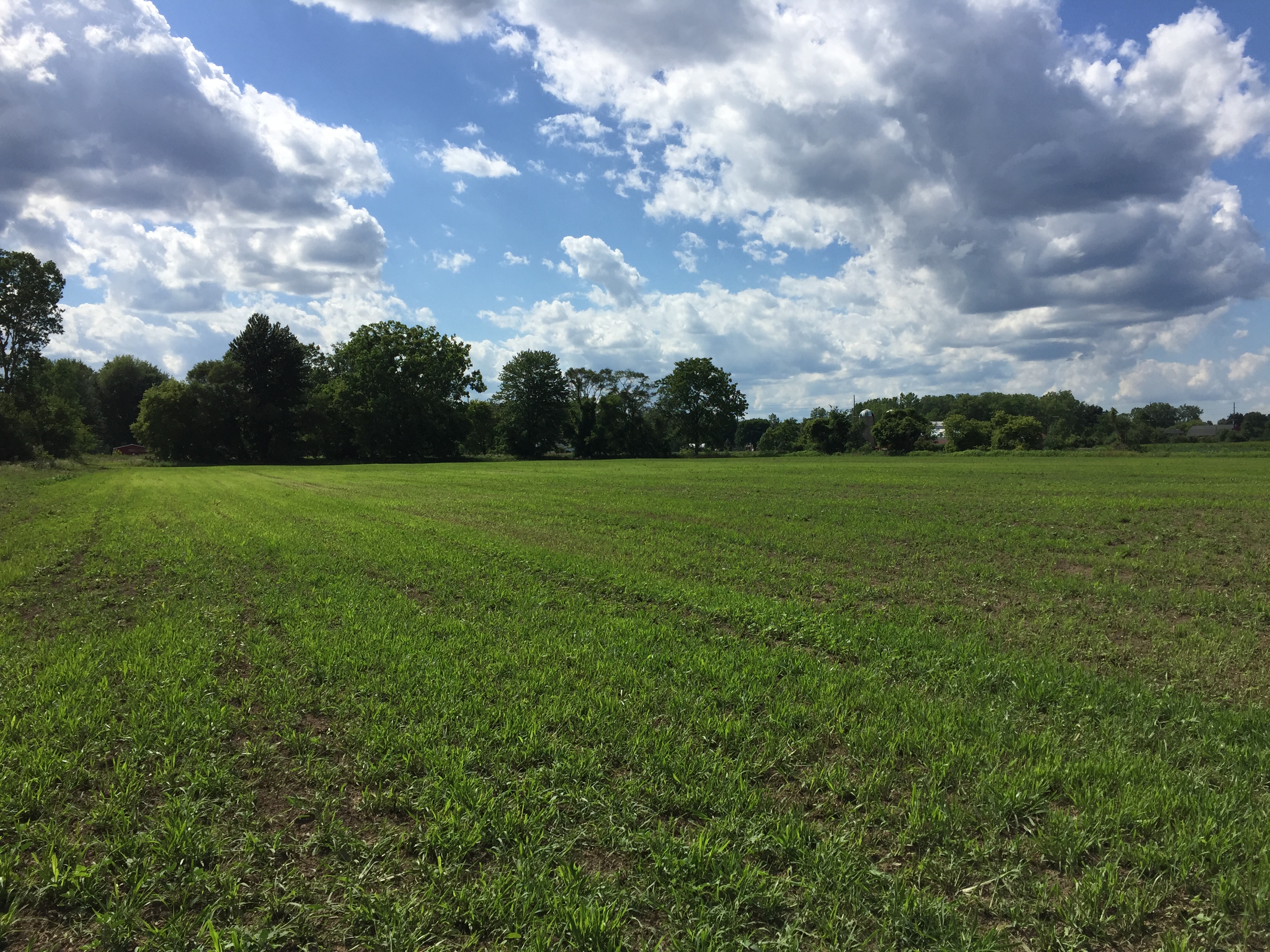

I have the spreader, cultipacker and hopefully a weeks worth of rain a head of me. I値l update with some pictures as things progress. This is what I had planted 3 weeks ago. Its spotty and a couple acres didn稚 come up, it has some thistle, a whole lot of mustard and velvet leaf weeds.
I mowed the weeds before they went to seed. I was thinking about spraying with some 2,4D in late summer or the fall.

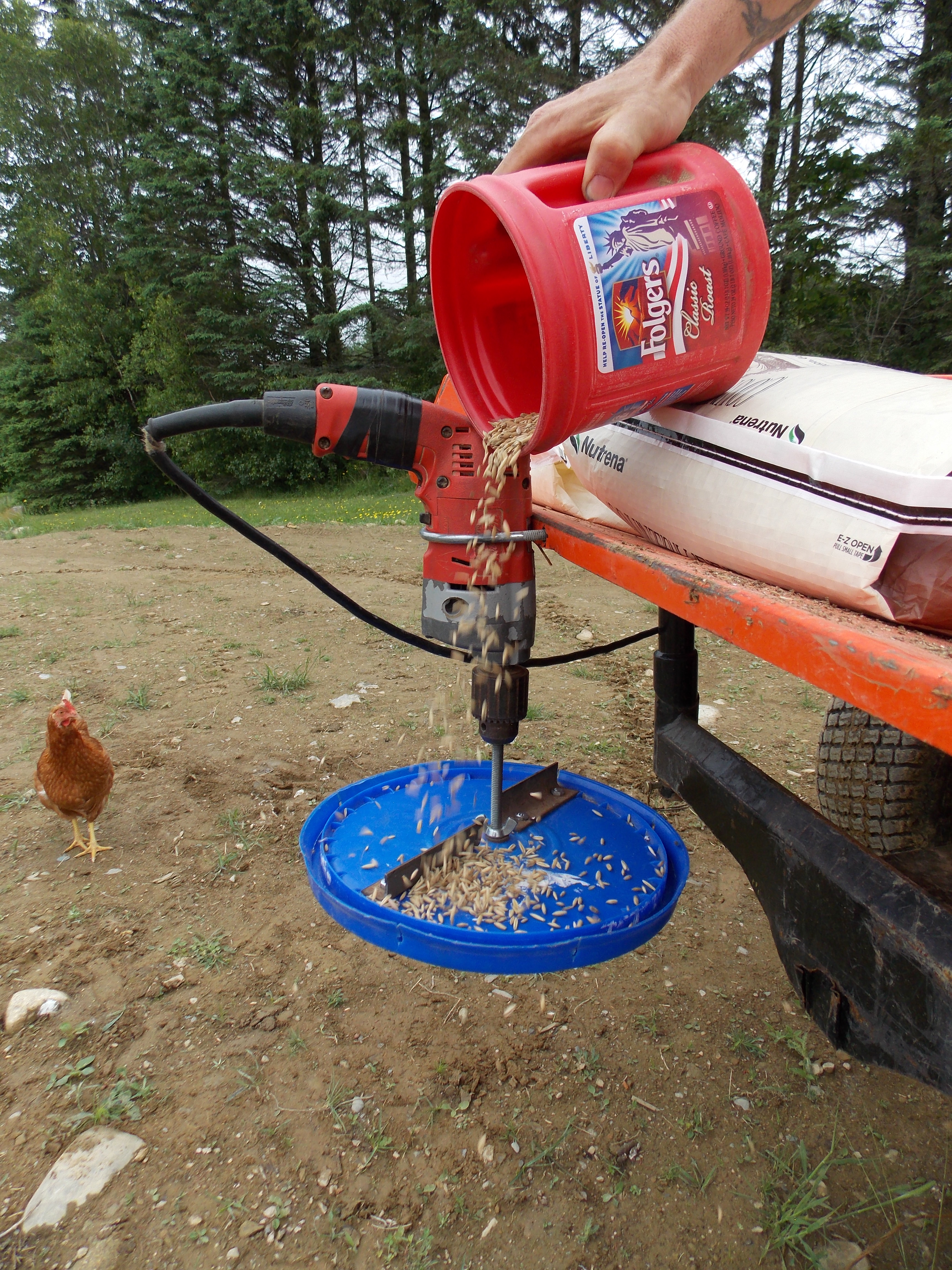

Granted this is a two person job, but what else would my wife do besides raise 4 children, work as a nurse, and be part-time farmer, but drive the tractor when needed? :laughing:
The biggest field I have done is 10 acres with this method, but it actually works pretty good considering I have $0.00 in it, and about an hour of time to set it up and build the paddles. It seeds a 30 foot swath, with a bit more to the left side than the right.
Incidentally, I always spread HALF going one way, say North/South, and then the other half going the other way, East/West. This gives me much more even coverage. To cover the seed I drag a log behind after I am done seeding. You would think this would cause seed to be hit or miss, but it doesn't!!
I spin the drill with a small generator on the front of the trailer with an electrical cord going back to the drill.

I you are plowing and harrowing your field, then the Brillion you have in the photo is the best way to seed down to hay/pasture you can get.
