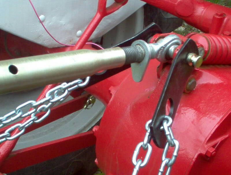

What's the general concensus concerning the use of 3pt limiter chains with a ballast for loader use? Thinking it would be good to get the load off the hydraulics or does it not matter?
   / 3pt limiter chain #2
I see no need for anything like that.
   / 3pt limiter chain #3
Doesn't matter. The 3pt is designed to carry heavy loads for extended periods of time. I wouldn't worry about it.
   / 3pt limiter chain #4
Chains are mostly for maintaining a set height with no drifting lower, but still able to lift.
Bruce
   / 3pt limiter chain #5
Bruce
Or for restricting upward movement of the 3pt beyond a certain point. :)
   / 3pt limiter chain #6
Your putting a lot of extra stress on that one point. Thy hydraulics were built to support the weight.
   / 3pt limiter chain #7
Good point. Missed that one. With the chains pictured the vertical stress is transferred from the lower 3pt arms to the top link bracket, which is designed to handle horizontal stresses. :)
   / 3pt limiter chain
I was thinking that too don't seem like a good way to load the top link bracket just figured I'd ask and see what the general thought was I saw someone on here recommend this at some point.
   / 3pt limiter chain #9
Various operators have various needs.
Don't worry about carrying long term loads on your 3pt. :)
   / 3pt limiter chain #10
Those chains look like they are on an 8N Ford. I use them on mine because the 3 point hitch raises and lowers (slightly) depending on the engine RPM's. If you are using a mower and trying to maintain cutting height with the 3 point you will constantly be adjusting slightly up and down depending on the load to the engine. With chains you set the mower height with them and drop the 3 point all the way to have the same cutting height and still allow to quickly pick up the mower if you run over something sticking up.
