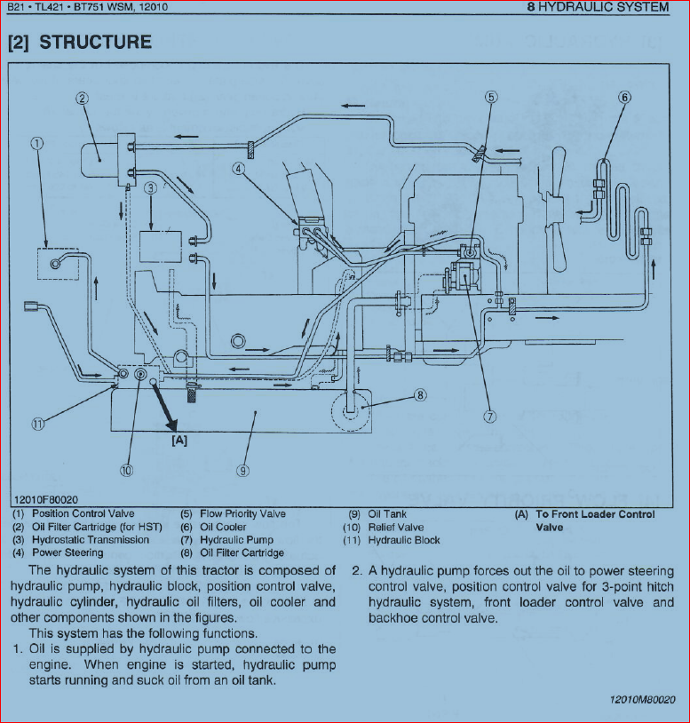

I think I know now though. Consider above I described an open center valve where PB and tank were combined. It works because, being the last valve in a system, PB has nothing to do so PB and tank just flow together. Now, after the BH, there is the 3PH. The 3PH is also open center and fluid just flows through the middle if it is doing no work. Since it never does work with the backhoe attached, it is effectively just a pipe with blended tank and PB flow. Your new rear remotes will not have that scenario, so we need a tank line.
I get that. So, "living dangerously" I could send the valve T and PB to the same place (P) for the 3pt hitch AS LONG as I remember to never use the raise/lower on the 3pt at the same time as the tilt and/or top on the box blade, or whatever. But I guess that is not optimal if I got a 3 or more spool for some future toy. The way my memory has been getting lately, it might be better for forget that entirely
I'd not do that unless you want to invest in tubing bending and flaring tools. Not fun without the right tools. I really want JIC flaring tools, but its just too much money.
Post again your tank port picture on the tractor. We need to figure out how to get two lines teed in there. If I recall, it was a hard line with a banjo fitting. You can get banjo fittings on rubber hoses too. I'm thinking a short hose with a banjo on one end and a JIC on the other. A JIC tee. and then one rubber line aft and one back to the loader valve with whatever fitting is needed. I usually use a JIC on the hose and an adapter on the valve body if needed.
This is all I can come up with at this hour. It is night, cool, raining, so, no shots tonight.
   / 3pt hitch Hydraulic top link and control #33
I'm having second thoughts on the selector valve and the BH circuit working with the 3ph selected. I read somewhere on another forum that it may be problematic. Is it possible to test? Can the backhoe and 3ph operate at the same time? Your second pic above says "return from BH or loader ", which gives me hope.

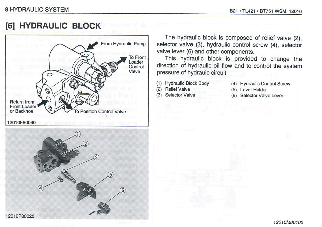

There is a 2 position "selector valve" that selects BH or 3pt hitch. Looking at the diagram again, it suggests the 3pt hitch "selector valve" functions to connect flow to T (in BH position)(?) or to "flow through" to the 3pt lift control with its tank connector.
Perhaps all these kits that hook into the front circuits had this all figured out to begin with? Ya think?
   / 3pt hitch Hydraulic top link and control #36
Well, I'm not sure. If you go back to your posted diagram Hyd1.pdf and look at the hydraulic block (item 1) you have valves 5 and 6. I have no idea if they are separate and move independently or not. But, with valve 6 in the closed position, flow goes to loader and BH and in the open position, flow can either go to the Loader and BH or bypass, which is weird. Also, it is listed as a "control screw". I wonder if it just turns on/off this flow if the loader is not installed.
Now, valve 5 seems to be a 3ph bypass. Closed, the 3ph works, open it doesn't as the low resistance path is to tank. However, you will note that the loader and BH are on the same loop, so if something turns off the BH, it also turns off the loader. If the loader works, then something you replace the BH with (rear remotes) should also work.
When you use the 3ph, does the loader work too? If so, this should work.
The "control screw" (6) in that diagram, controls flow to either the FEL or the 3pt hitch, according to the WSM. My guess is it is there for units that will normally not have, or never will have, a BH attached. Does not look easily accessible
It does seem like 5 either passes to 3pt hitch, or dumps to tank, thereby providing the BH tank connection. You may have a point as it seems pressure will still be supplied and it should work. Perhaps I was under caffeinated this morning.
