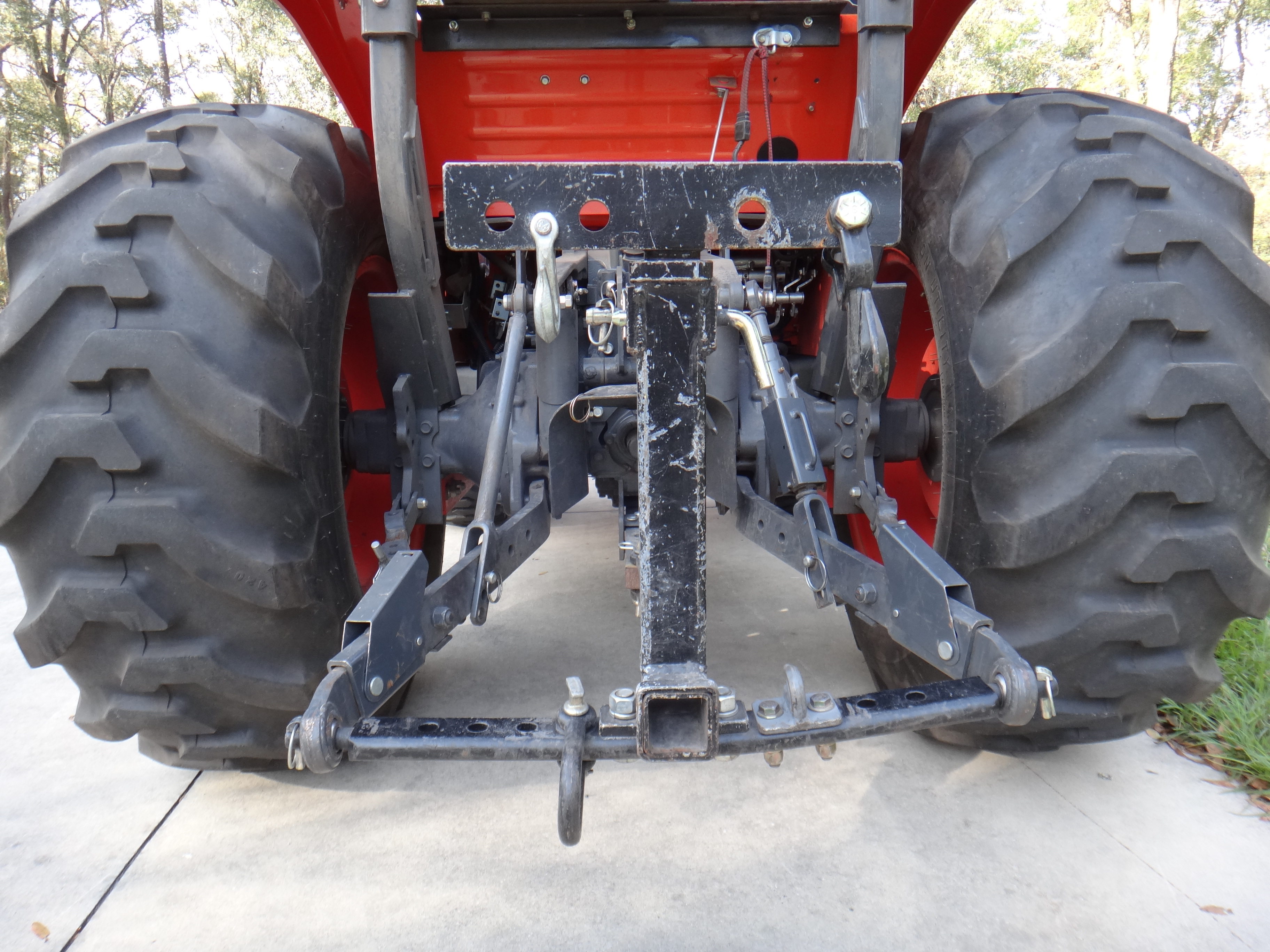

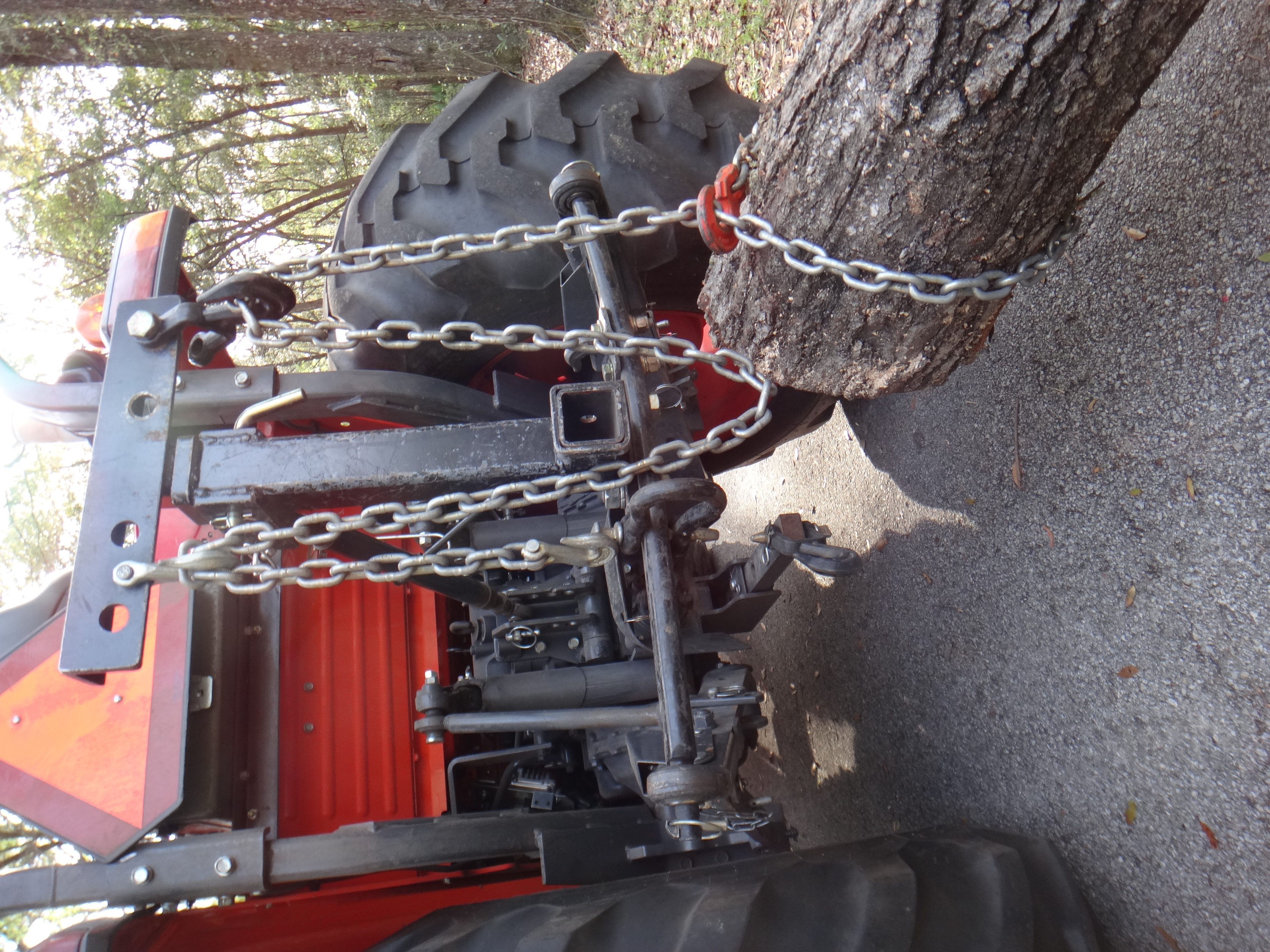

Also shop the modular Three Point Hitch cross-drawbar from Omni Manufacturing, a competitor of Heavy Hitch. I think either will be less sensitive to Three Point Hitch geometry than a standard Subsoiler.
Sub Compact Utility Tractor Hitches - OMNI Mfg LLC
OMNI TRANSFORMER 3 Point Ripper - OMNI Mfg LLC
I have a gut feeling a cross drawbar hitch with pin-adjustable ripper depth will provide better depth control on your tractor, relative to tractor hydraulic depth control. Omni is semi-custom and willing to incorporate small modifications at customer request. You may need a reduced size implement.
I like modular, multi-purpose attachments.
