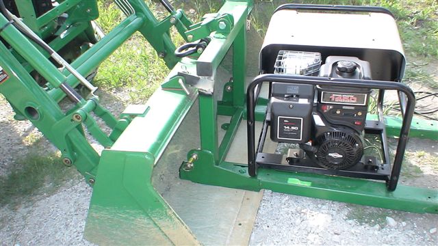

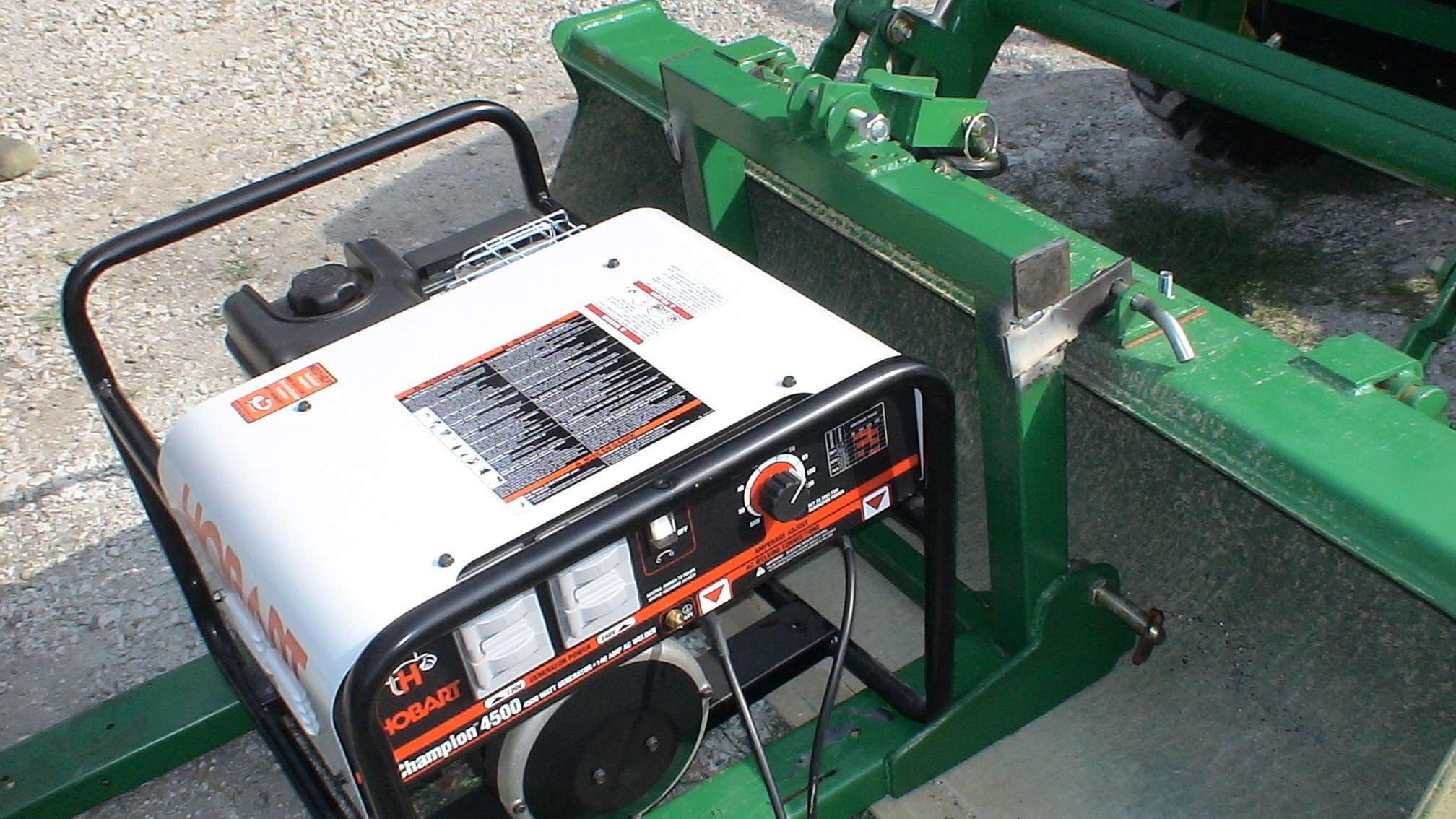

I used two old Jeep bumpers I beefup to build forks for 3pt & FEL .First use to unload new welder my son bought last weekend .

Very clever! Set up for both front end loader and rear 3pt
Just out of curiosity... did you unload your son's welder in to YOUR garage? :D

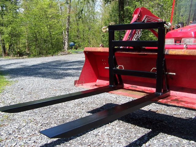

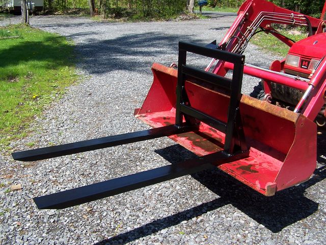

Nicely done. I was thinking about doing basically the same thing with my 3pt forks but I think I'm gonna make another set of fork because I don't like the fact that my rear 3pt forks aren't adjustable just like yours. It would be nice to move them around for different situations.
/ 3pt & fel forks #5

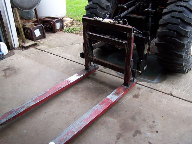

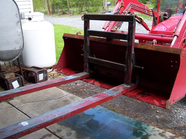

I made a set of forks a few years ago that slid on my bucket and tightened down with a T-handle screw (You can see the T-handles I cut off in the background of pic 2). I liked jwaynejtx's idea and modified mine so I can use them front or back. Mine are also in fixed position but I rarely need to adjust them. This was my weekend project.

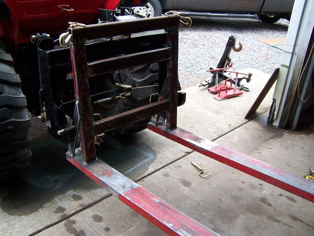

Here's a few more. Thanks for the idea jwaynejtx.

yes Chuckanut unloading the welder was their first job, no in his barn, he has my wire welder, you know kids what yours is theirs to. Georg2515, I like your old ford here's a picture of my 36 ford.

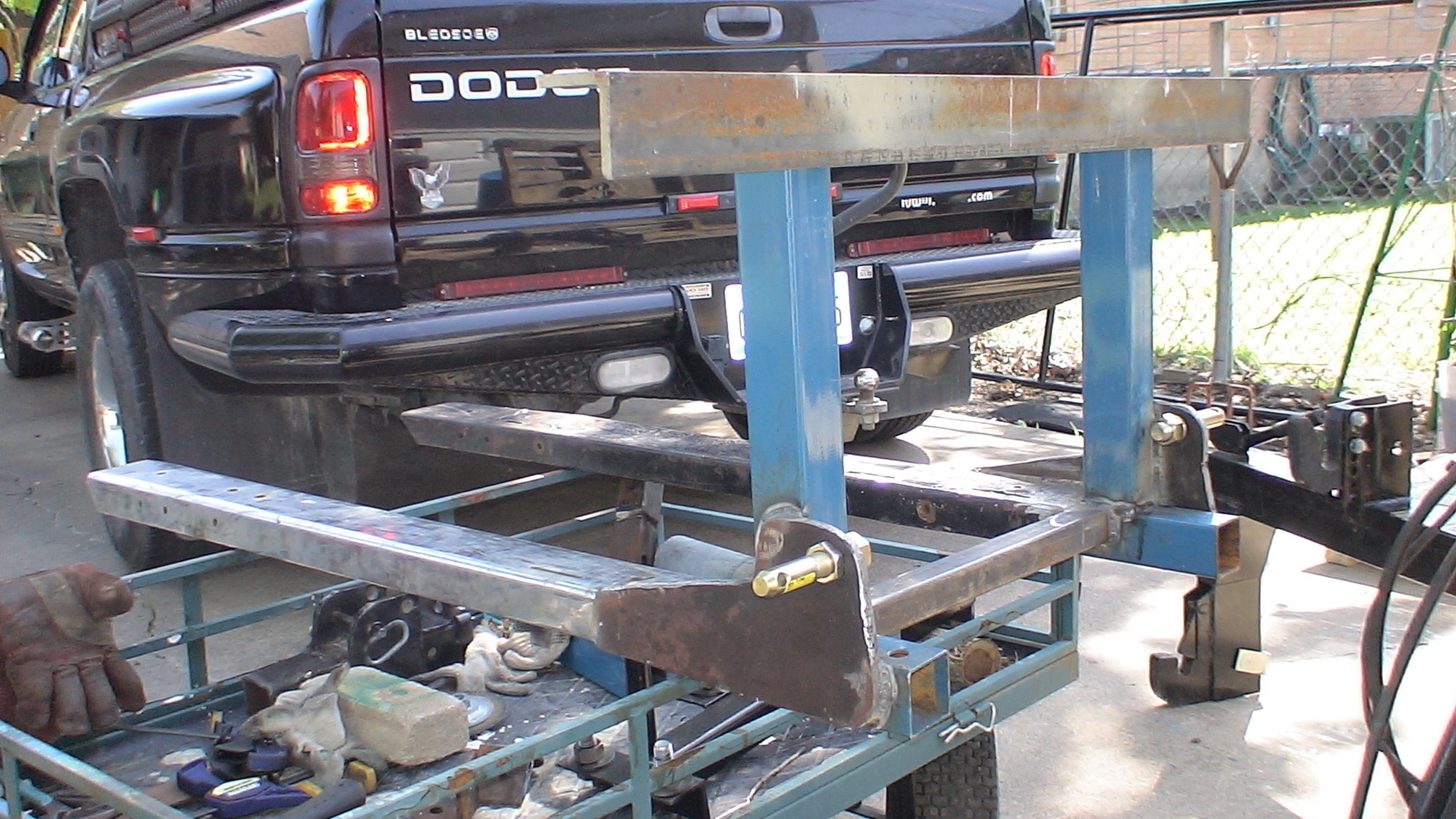

Aezlan ,I haven't had it move back ,but I will put a stop at the bottom front of the bucket. A picture form right side.

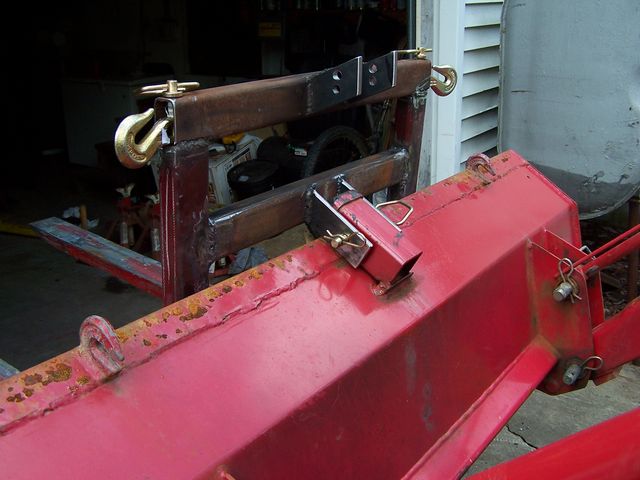

George2515, I like your removable hooks on top good idea & handed.
/ 3pt & fel forks #11
Aaron, If you look at this pic you'll see the forks can't go back in my bucket.
jwaynejtx, Mine is a 29 Durant. Also I put the removable hooks there since sometimes you need to wrap a chain around what you are lifting and need a place to hook to.
