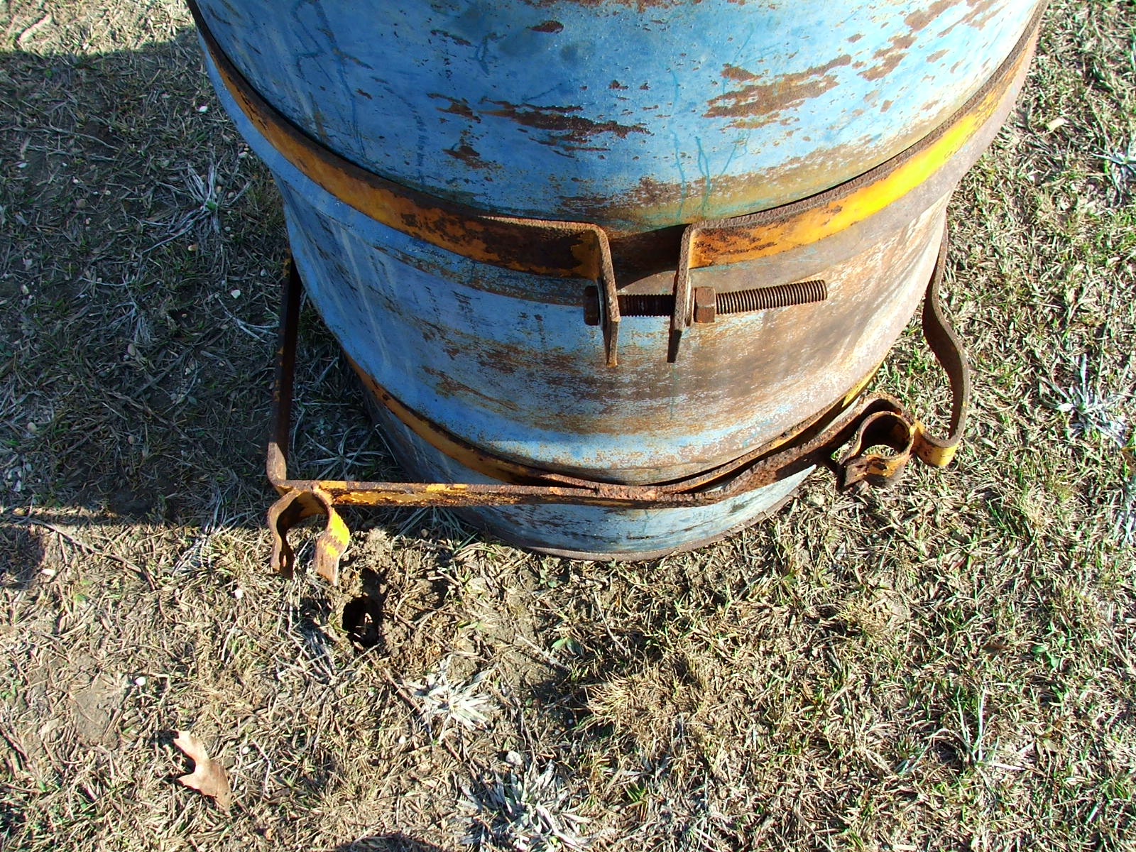

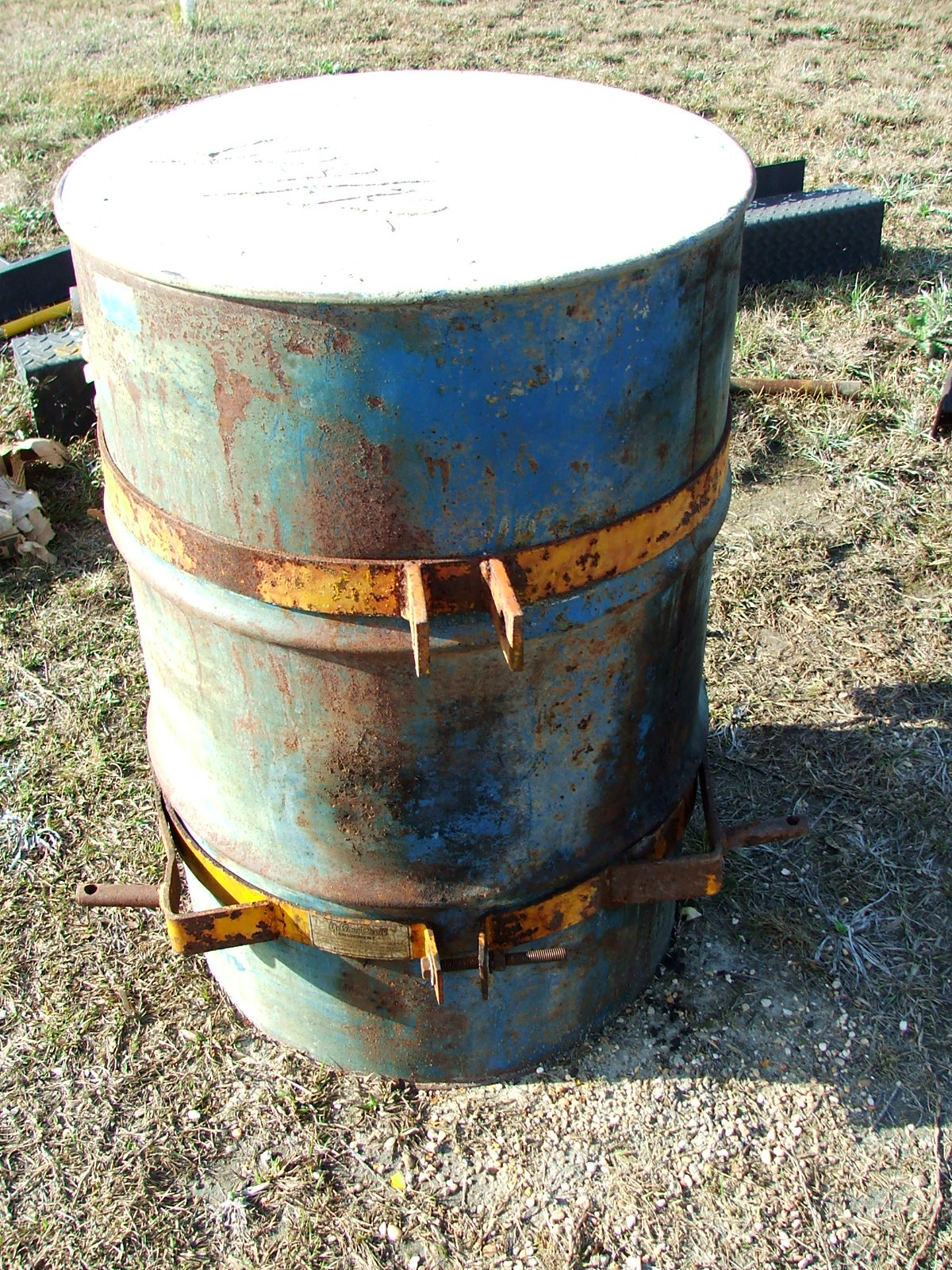

Well this is not a pretty as the store bought.
But it is in its second reincarnation, Org loaded with concrete pillars which i have other uses for.
I partially filled with unused hardened concrete mix, then mixed fresh to fill, added more , mixed more, the used some unused mortar mix to finish off.
Estimated 950 Lbs.
I did some ebay and google searches, the company that made these bands is long gone, I failed to find others. And i find that hard to believe.
Its too simple, too effective.
DS

HAH! I have never seen anything like that, or even thought about doing that.. does it work well? I don't see why it wouldn't though.

This one was made by a company in Jackson MS 25-30 years ago.
But whats not to work. It's weight.
2 simple brackets.
I must admit i have no clue what the rear bracket/pipe mounts were suppose to be for. 2, 1 1/4-1 1/2 vertical pipes? One is still folded up.
Most tractors lift arms will hang below the pins so that is a easy hook up if aligned.
But you ant going to slide it around to aid alignment.
The top link often has to be taken up some.
I didn't have a old receiver hitch to butcher, Wile mixing cement I thought about implanting a receiver hitch tube, poking a couple holes for rebar to have a extra trailer mover/ vice mount/ winch mounting.
But didn't plan far enough ahead LOL
DS

Yeah, I put the 2 inch reciever in mine, and 3 of the 2 inch pvc tubes in for handle tools. wish I had put at least 1 more of those in. I also put in a couple of 6 inch pvc pieces to corral log chains on top of the concrete (mine did not go all the way to the top).

But I can weld a couple tabs that will make good chain hangers.
