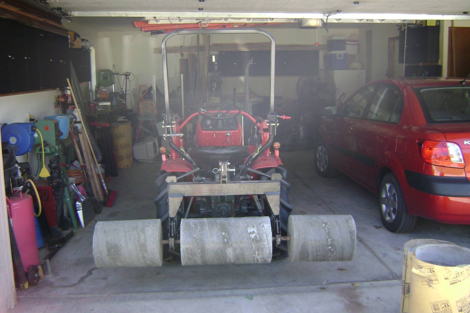

Mine weighs about 530lbs. I also have wheel weights that are about 320lbs.
   / 3pt Ballast Ideas and Amount? #12
I posted this photo before in a different thread about counterweights.
It contains 7-80lb bags of concrete: 2 bags on each end and 3 in the middle formed around a steel bar. Total weight is about 570

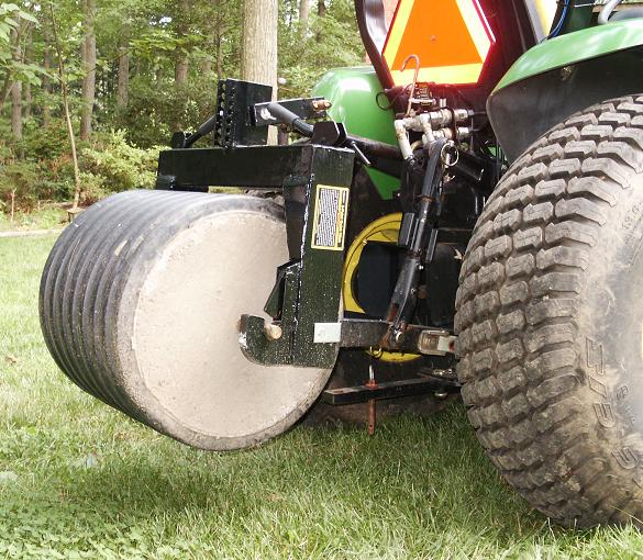

K0ua's build is really nice. There isn't a picture of it, but he mentions having a 2 inch receiver placed in the box as well. That's an ingenious and handy addition, because it would allow you to insert hitches, tow hooks, or whatever, and still do some other tasks without having to drop the ballast box. He's got contained storage for straps, tools, or whatever else, too. That's a neat setup. Good find, Shawn.
