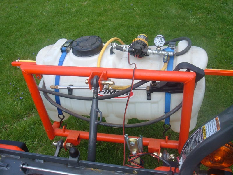

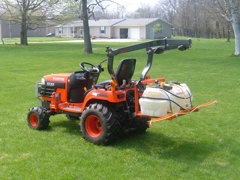

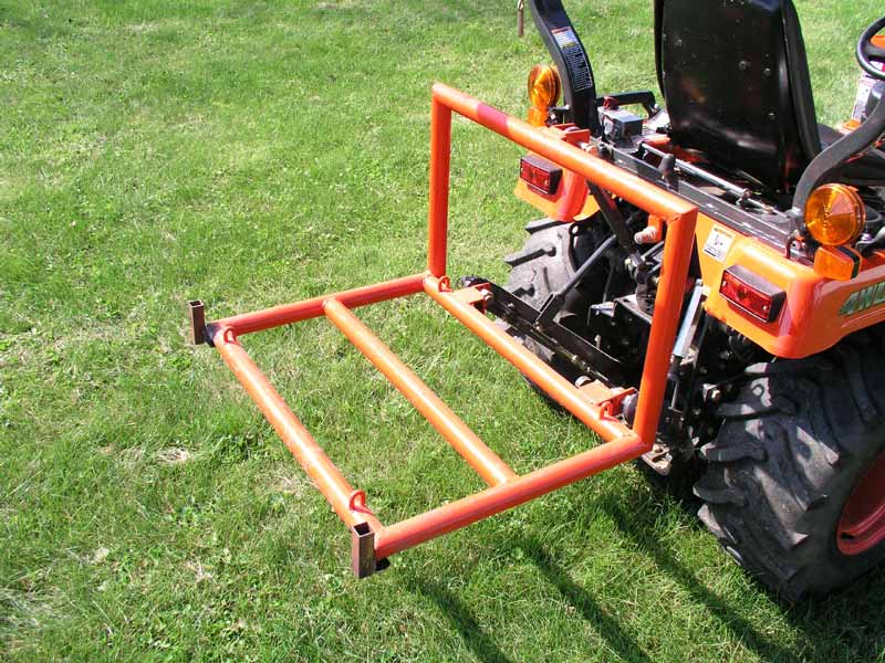

Here is the sprayer I put together. It was originally a 25 gallon spot sprayer for the back of an atv. I built the carrier and boom. I should have bought the one with the boom included, I ended up spending more money on it. The chemical I use,Trimec or Tramec or something like that, it is 2-4-D based. They recommend from 25 gallons of "mix" per acre up to 150 or something pretty large like that, one tank per acre is on the very low end so I try to run two tanks per acre.
