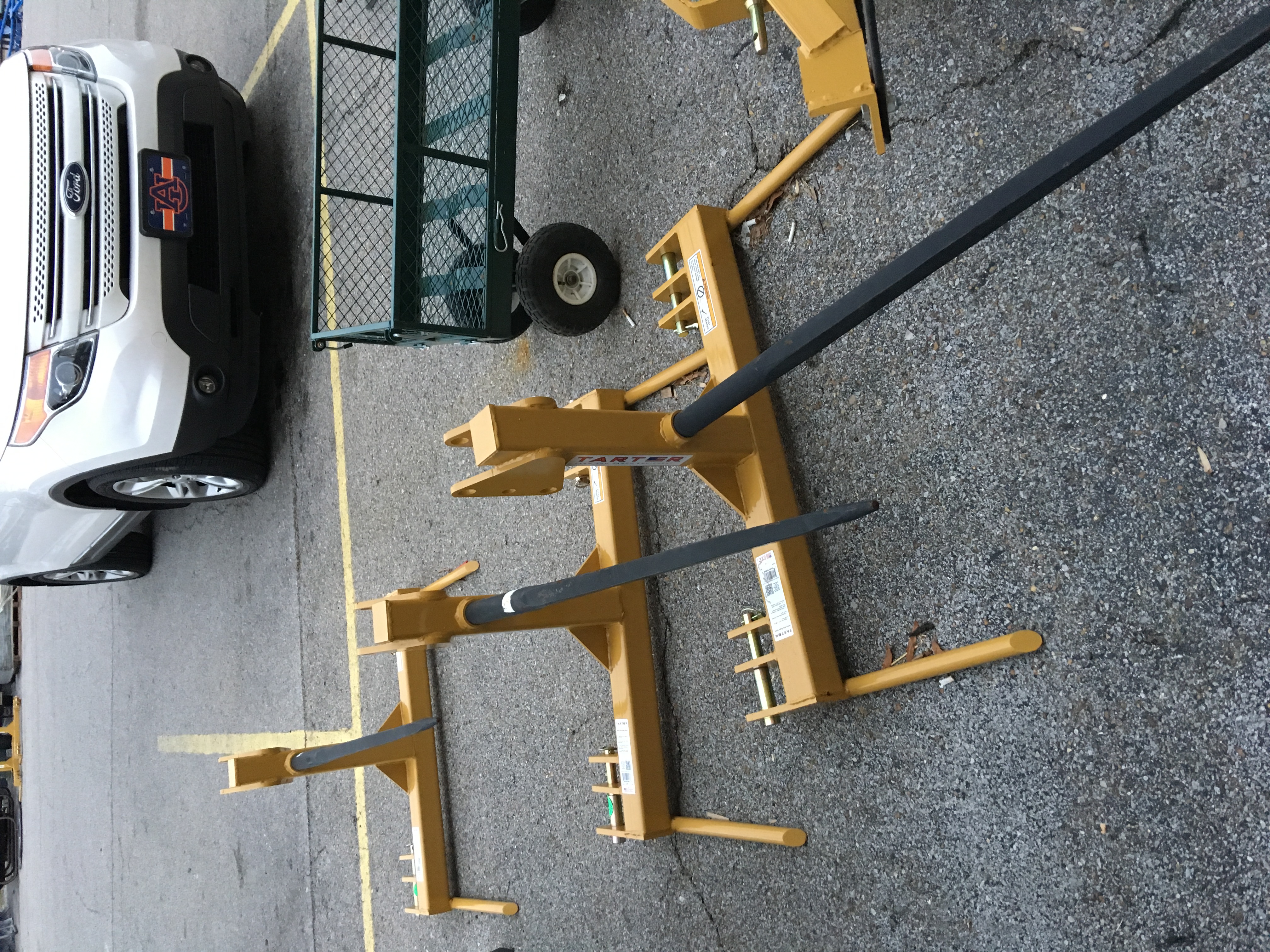

Good morning folks,
I am new to the forum, so thank you for tolerating a first day post.
I plan to purchase a 3 point bail spear for my Kubota M7060. I like the Tarter Heavy Duty Super Spear with 2-stage quick-hitch Cat I and II pin hookups. Others build a similar spear, but this is available local, and beats shipping cost folded in by other manufacturers (King Cutter, Etc..)
On the Tatar website it shows a picture with the main spear mounted about halfway up the vertical tube (8" or so below the top link attachment point.) However, when I visited my local CO-OP, they had two different versions of the Heavy Duty Super Spear. Both had the same part number, same frame, same everything except - one has the main spear mounted higher (about an inch below the top link attachment point) than the one shown on the web (about 8" or so below the top link attachment point.)
Does anyone have any insight on why they would build two versions of the same spear, and why I would choose one over the other? I uploaded a picture of the bail spears which clearly shows the different mounting points. I am sorry it is sideways. I could not figure out how to rotate it back.
Thanks for any help,
-Bill

Welcome to TBN!!!!
I would want my main spear to stab the bale close to the center. I would want the lower two spears to stab the bale close to the bottom. Wouldn't I have a use for the different spear location dependent on what diameter of large round bales I handle?? Which would also affect how high my specific tractor could carry the bale?? Just brainstorming, really don't have a clue. Probably a simple production change with no real reason...... :)
/ 3P Hitch Bail Spear Geometry Question #3
My guess is for different height feeders. The one that is higher will pick it up higher, if you stab it near center, not much but it makes a difference. As far as your tractor picking it up it doesn't matter which one you get.

Thanks Gentlemen! I am leaning towards the higher mounted spear. It more resembles the other spears I have used in the past and the one my dad uses on his tractor. I could probably get away with their standard duty (1500lbs) spear with cost less since we only bail 5x4 (or 4x5 I can't remember). I just like the CATi/II slide pins that the heavy duty comes with. Keeps me from having to hunt for hitch adapters. LOL
Again, thank you for he quick replies!

Honestly, it looks like a manufacturing issue. If you look at the spear mounting height, it looks to me like the one in front was welded with the vertical tube upside down making it lower than the two in the rear.
/ 3P Hitch Bail Spear Geometry Question #8
That's exactly what I thought. The guy doing the assembly just put that part in the jig upside-down and welded it up.
/ 3P Hitch Bail Spear Geometry Question #9
A quick search online and you can see them just like the photos posted above, either high or low on the heavy duty models. Don't think it's a fluke.

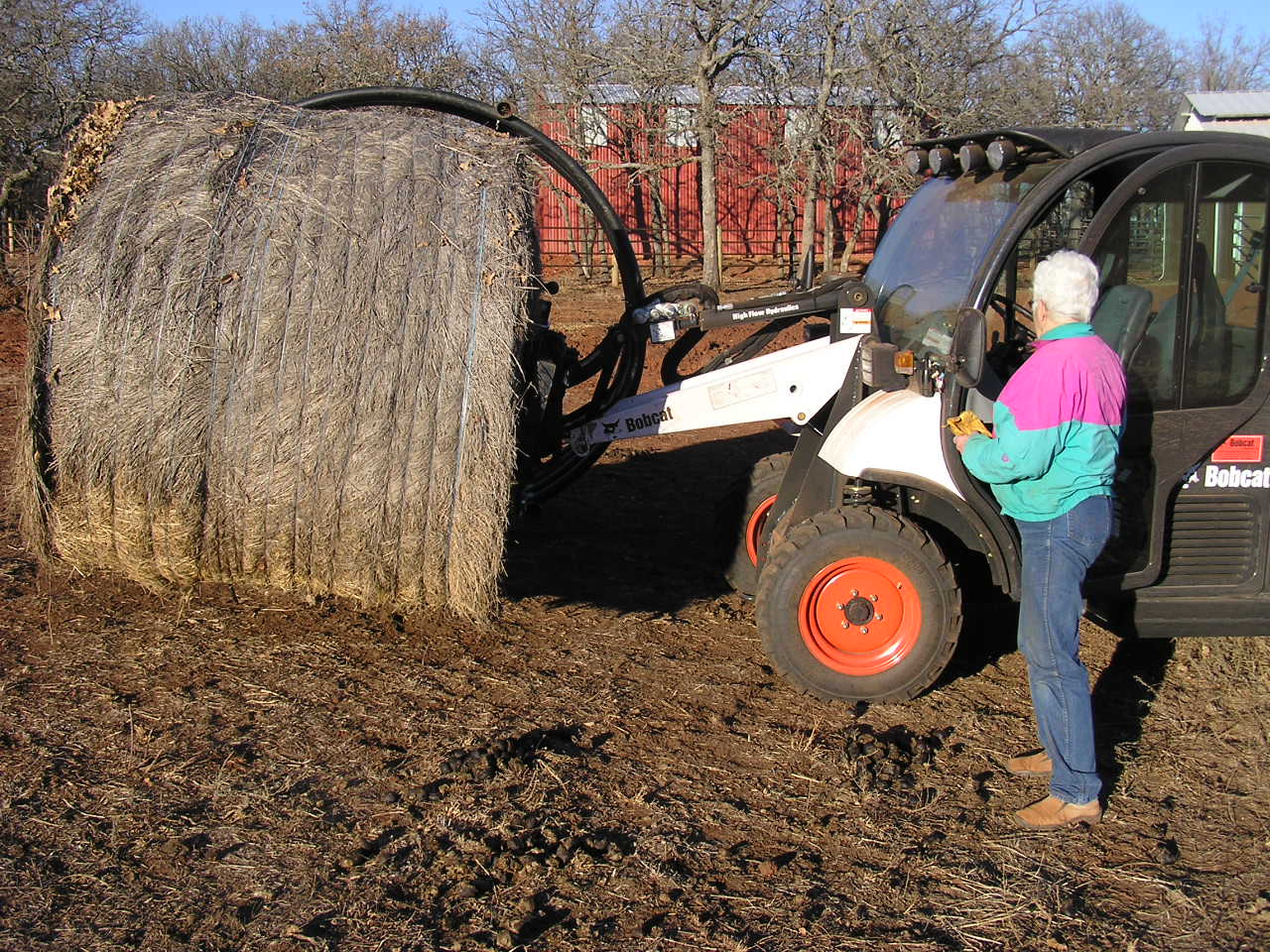

Here is my wife and her Toolcat, setting out a 5x6 bale for the horses:

I think the "low spear" was built wrong. If they were supposed to be this way there would be a different model or option spec on it. Looks like it was built upside down, cheaper to sell it that scrap it.
The one with the spear "low" will not be able to lift the bale as high unless you spear it well below the center line.
#17
I decided to write the folks at Tarter to see if they had an explanation for the two different spears. Here was the reply:
" ... Hi William, thank you for contacting us and your interest in Tarter products.
We had a revision change sometime last year. We used to make them with the spear mounted lower but decided to move it higher for stability. So I would recommend the one with the spear mounted higher."
And that's that. Obviously my local farmers cooperative has one of last years product still on the yard. I will respond to Tarter and ask them to update web site.
