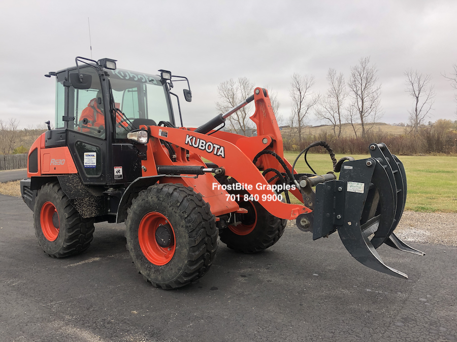

Consider the Frostbite grapple; for one it's slightly lighter (359#), and it's pretty well reviewed and sold for generally tough machinery. Made in Estonia. I saw one seller mention a 6,000# lift capacity.

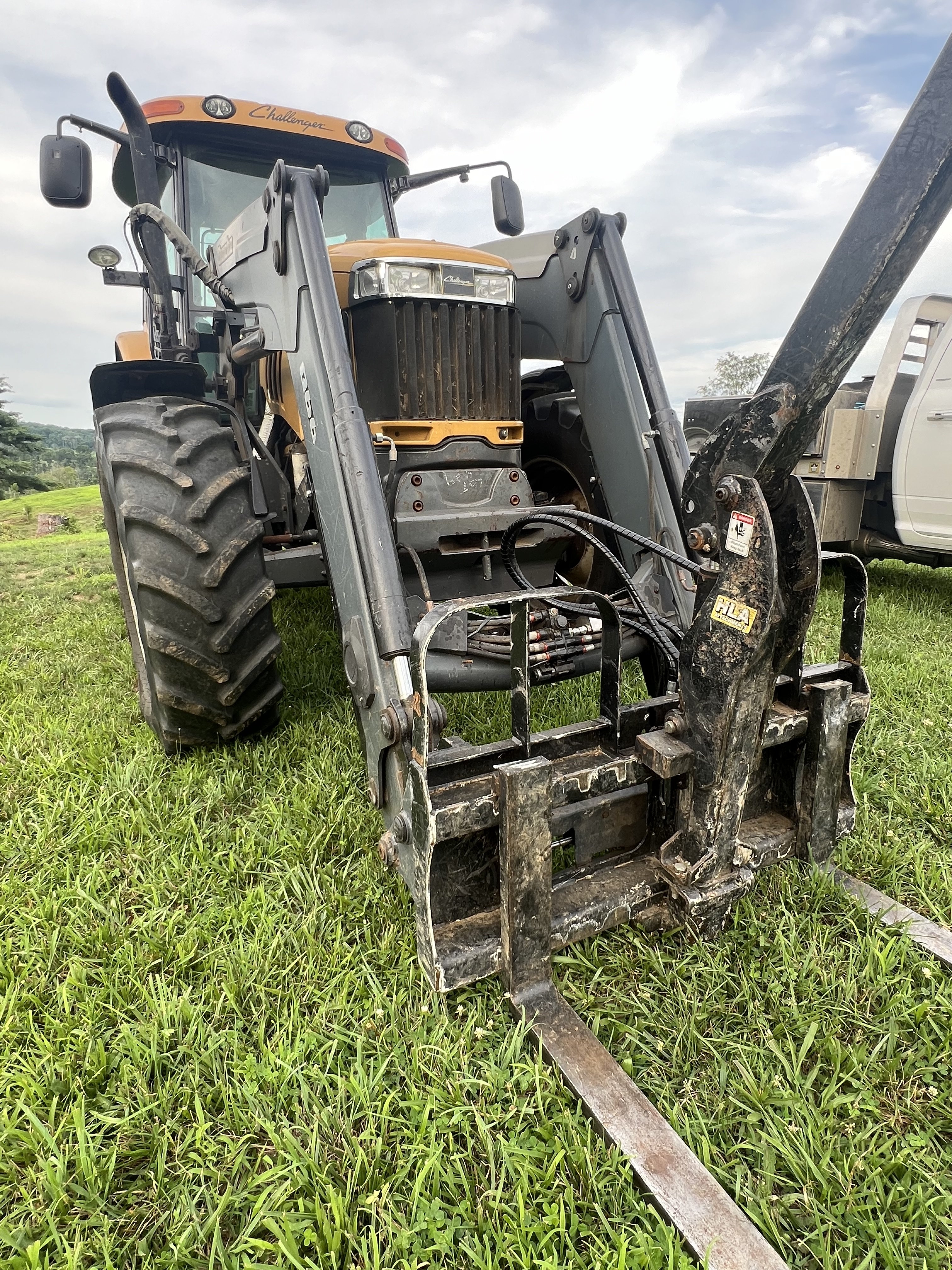

Get yourself an HLA catalog, or go to HLA on line. Canada or US made.
Very tough stuff. I swear by their attachments, not at them. Found at AG dealers all over.
Buy once, cry once.
