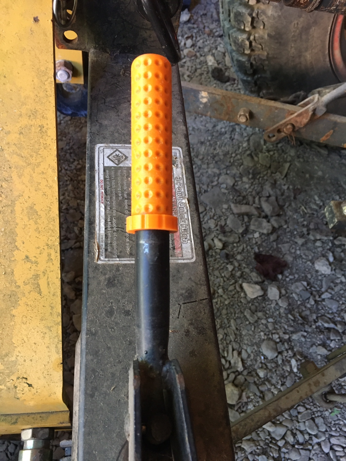

Here is a few things that hi has made for me.
Handles for my HF quick hitch.
Bucket handles and
