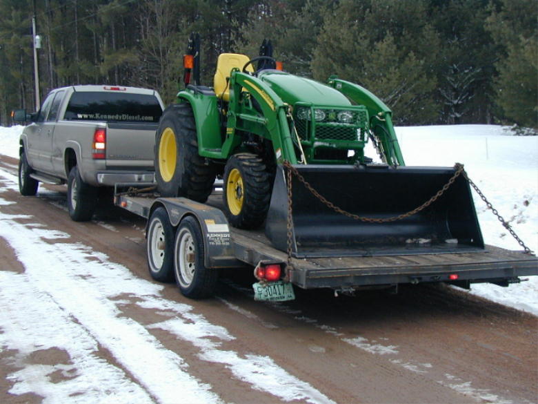

/ 3720 tested #9
Here it is on the trailer, ready to attack the snow...
