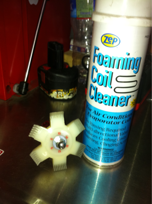

/ 3720 Cab A/C Evaporator #4
This will work for you. I use some harsher stuff on our reefer units. But Ive had good success with this too
/ 3720 Cab A/C Evaporator #5
Another vote for the foaming coil cleaner, if you don't fiddle with the fins you are better off. I use Johnstone Supply for materials and supplies and have a fin comb or two, these work well to straighten the fins but it is better to not fool with the fins to start with.

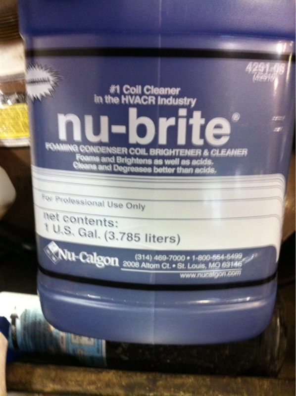

/ 3720 Cab A/C Evaporator #6
I agree. Leave the fins alone. I have that fin comb for fixing road damage on condensers. bird and rock strikes or whatever. This stuff in the pic is great. It is harsh though and cannot be left on long. It's almost like an etching.

/ 3720 Cab A/C Evaporator #8
I would use the foaming coil cleaner in the first example for the evaporator coil, no rinsing required and better rated for residual fumes. The second product (Nu Bright) is for cleaning condenser coils which are outside the cab or house in the open air.
I haven't had to clean my evaporator coil yet but you should be able to spray the coil without concerns for the fan and motor. Bear in mind that there is a pan beneath the coil to collect the moisture so make sure the drain in not blocked and that the cleaner and dirty residue will pass through the drain hose.
