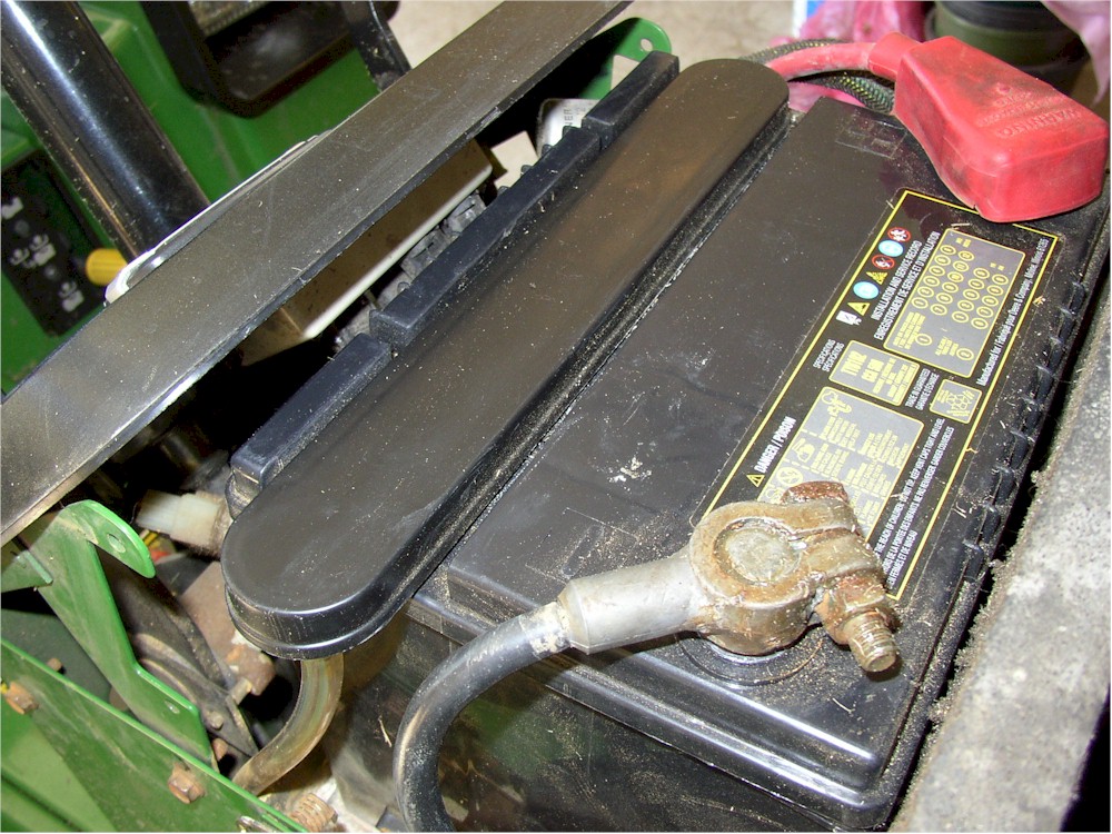

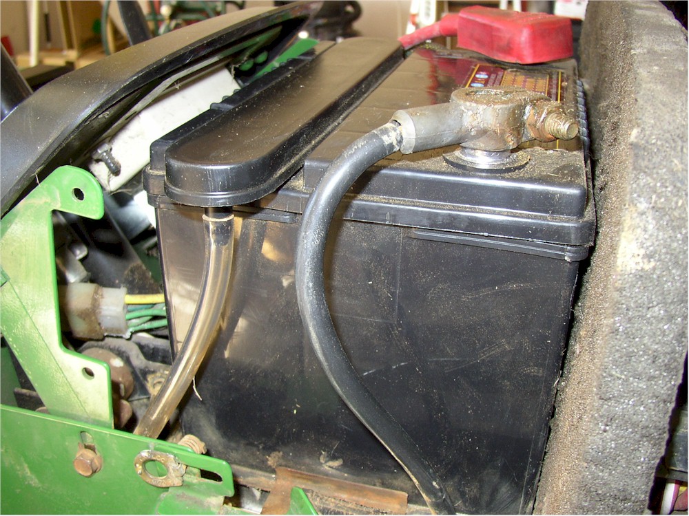

I saw other comments recently about JD using a new battery design. From what you are saying seems like they are doing what I have done for many years. Use a vent tube. Previous thread with information here:
http://www.tractorbynet.com/forums/john-deere-owning-operating/154730-3320-300-hour-review.html
