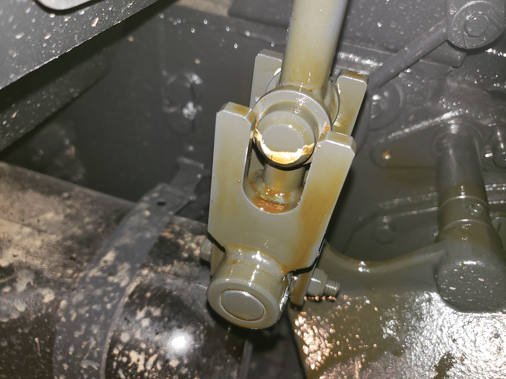

Branson 3620
Today I was coming out of c range and it had just a little grind. Now no ranges will engage and the tractor will not move. The shuttle was in neutral clutch depressed and the tractor was not moving at all. Any ideas? All of the linkages are working externally. I think something gave inside the case. Waiting to here back from the dealer.

4 ranges. None of the external roll pins were sheared. My dealer actually came out and checked it out. While messing with it started working. We are kinda stumped. I ran it about an hour with no issues. I would say operator error but I checked everything multiple times and I’ve been running shuttle tractors for a long time. They aren’t real complicated. Who knows. Devine intervention I guess.

i have seen this a few time my guesstimate would be the shifter linkage wedged itself preventing you from engaging the shifter fork in the trans, this unfortunately has been an issue decently with how they designed the linkage to move it allows the linkage to have a bit to much of side to side play and this can cause it to stick out of gear and prevent use, however it can be fixed very easily with just messing around with the lever until it unbinds the linkage that being said i have seen twice so far this year( over a 6 month period) that the linkages really get wedged and we had to go to the rear undo the linages set everything back to normal positions and reinstall the linkages.
/ 3620 transmission #7
Here's a pic of the linkage. The shifter gets jamed between the 2 sets of forks. The fix is a light tap with a hammer. The cure is never force the shifter when operating the tractor. If it gets stuck find lvl ground work the tractor back and forth untill the transmission gets unloaded and gently work the shifter into place. If that doesn't work refer to the "fix".

SO-> place on level ground and attempt to gently place the shuttle lever in either forward or reverse position to gain motion of the tractor?
Sounds tough to make happen if the tractor doesn't move under it's own power based on a stuck shifter? other than to roll down a convenient slope in neutral or clutch depressed?
Not sure I get this idea of "find lvl ground", "work tractor back and forth"?
Please explain as I just bought that same transmission in my 4820R, thanks for the pics and info so far!

The idea here is to "unload" the transmission so as not to contribute to anything holding things from freeing up so to speak. Returning the tractor to idle and a nice flat area and "rocking" back and forth using the peddles is the best way I've found. Others might have better ways but this works for me. And yes this has happend to me on the Branson (only once) and other equipment, so I kinda speak from experience here. The Hydrostat transmission is excellent, it's the linkage that could use some thought. Oh, if you have to use the "fix" (see my post above) you might have to remove the fender to get to it.
/ 3620 transmission #11
The same thing helps if it's hanging up going into or out of 4x4. I usually come to a stop, put the trans in neutral, and shift the front axle (in or out). If it doesn't go right away, I'll put it back in gear, and roll it forward a foot or two, shift back to neutral and it usually just slides right in (or out). Helps to have the front wheels straight when doing it.
