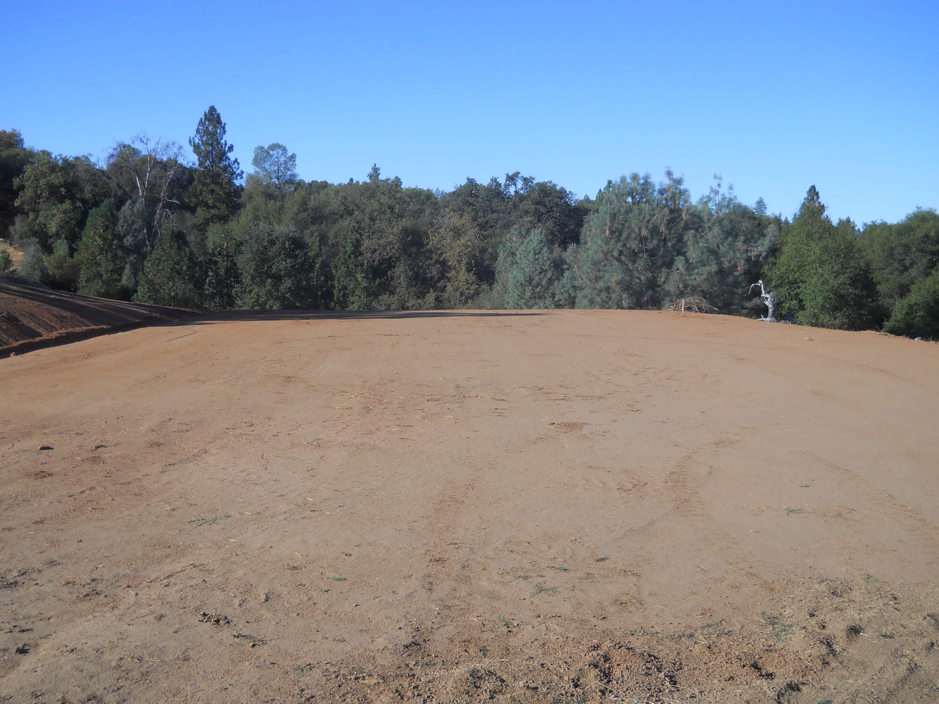

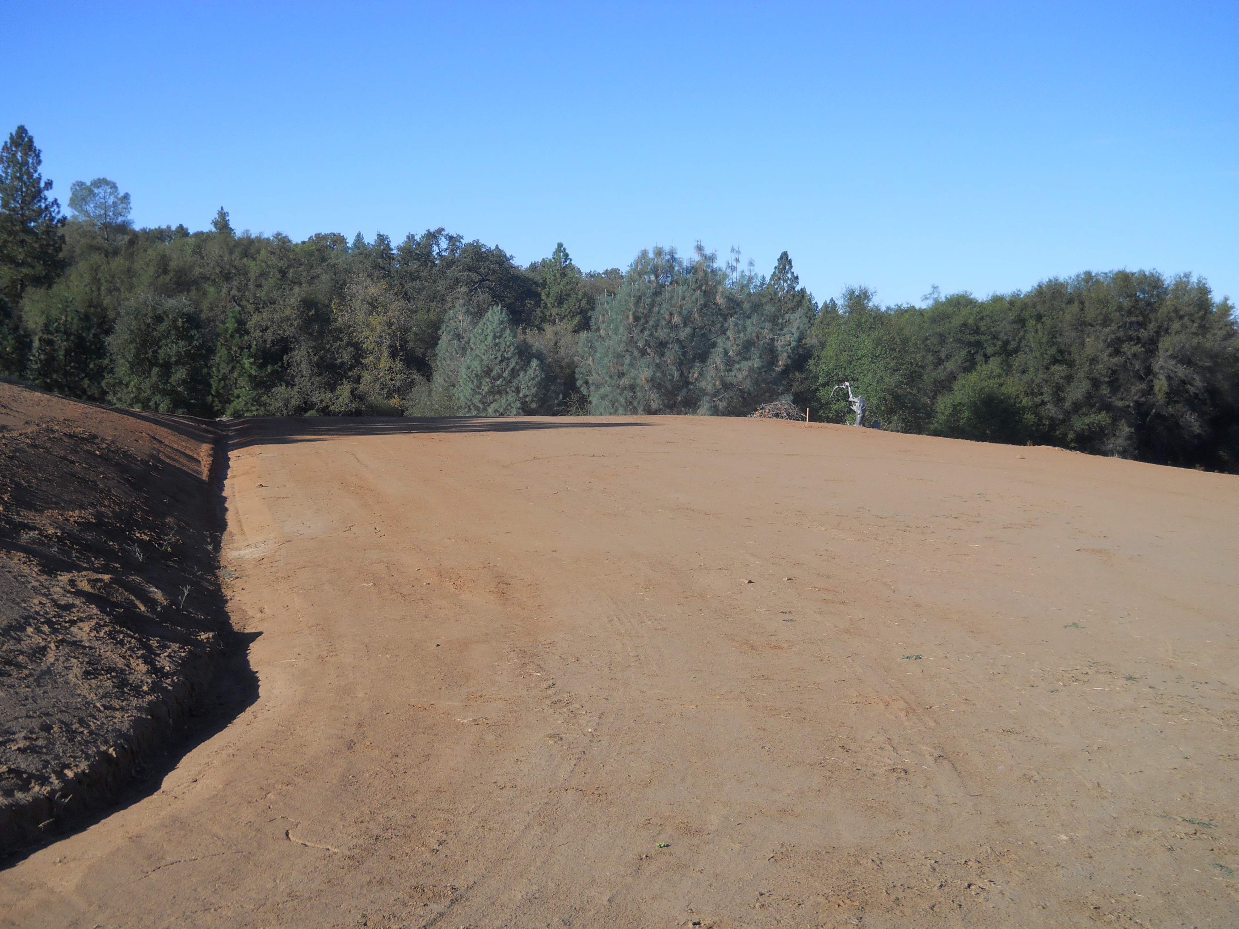

I am building a 36' x 36' horse barn with two lean-to's

The reason I put it in DIY is my client will take over after the shell is finished.
/ 36' x 36' horse barn #3
Nice, clean pad. Sort of a blank canvas :thumbsup: I'll be watching your build.
/ 36' x 36' horse barn #4
Beautiful dirt work!!!! I'm looking forward to following your progress.
