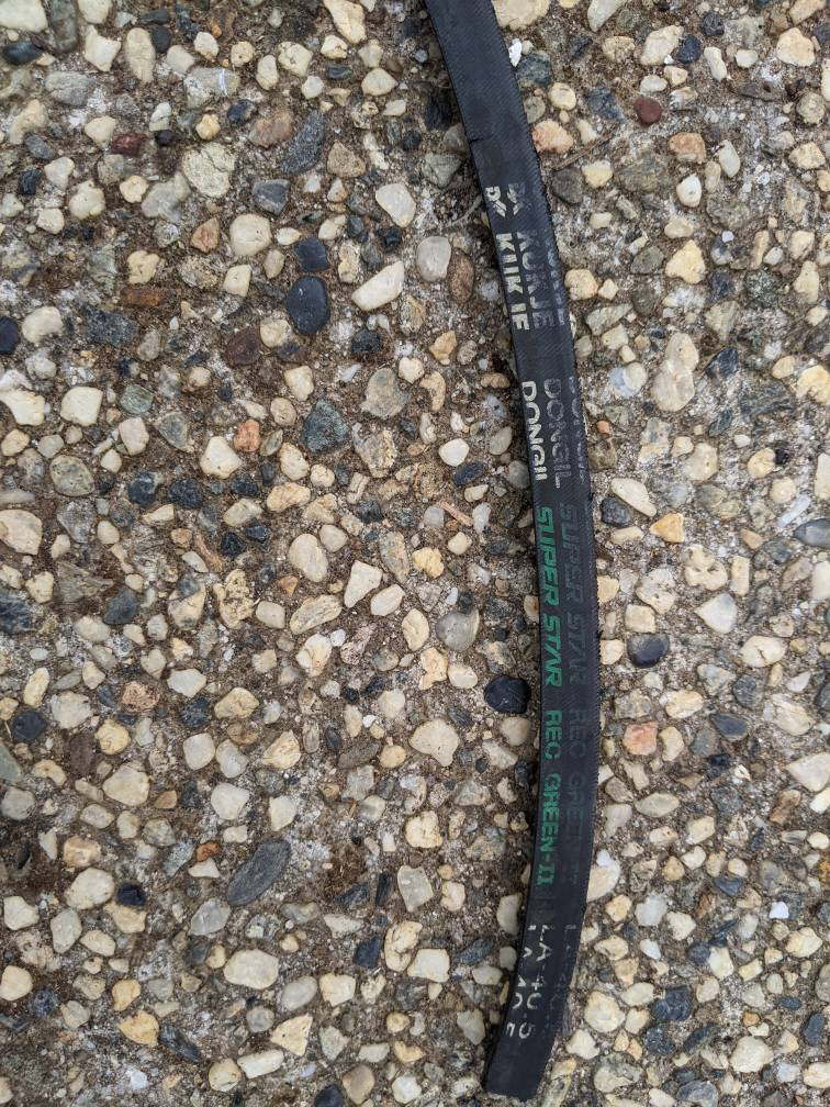

Note: The OEM belt said "LA40.5". Some reading on the net told me
the “A” series belts are the most common. The number following it is the inside length in inches. The outside length
is typically 2 inches more
Assuming the ".5" means "half inch width", the LA40 would be about 40+2 inches outside measurement, which appears correct.

My original belt was a DONGIL SUPERSTAR REC, 15X1190 (B-47) which was about 50 inches long when measured.
It only took a couple of trips to NAPA to get the right belt of course they had to order for the next day.
