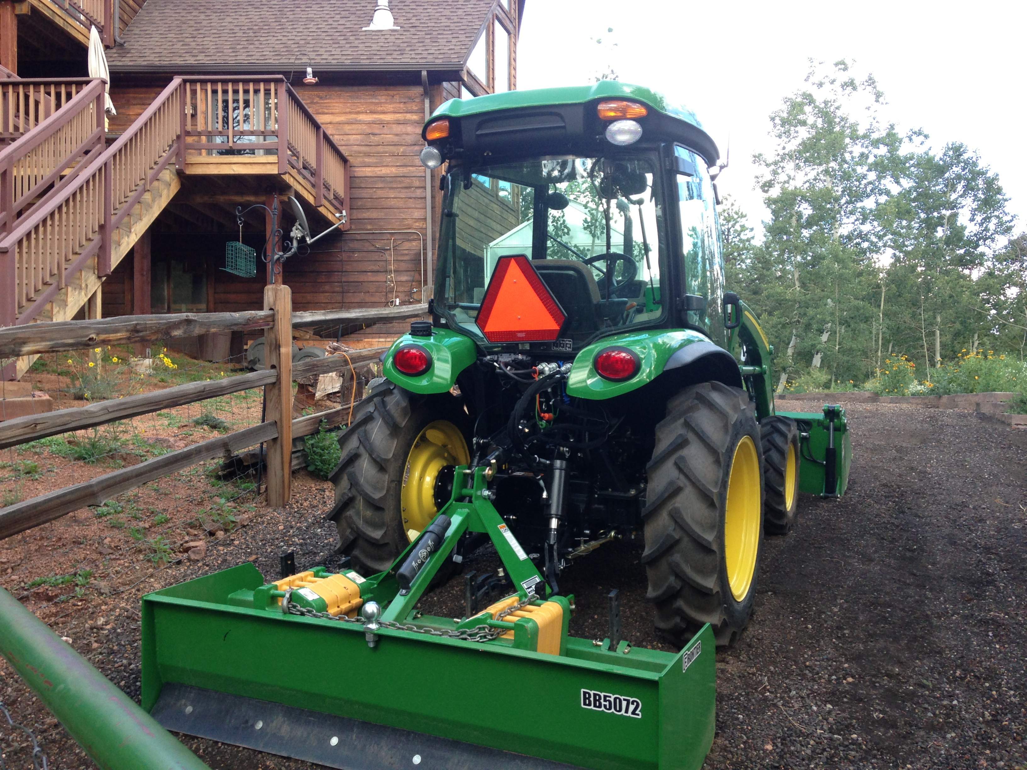

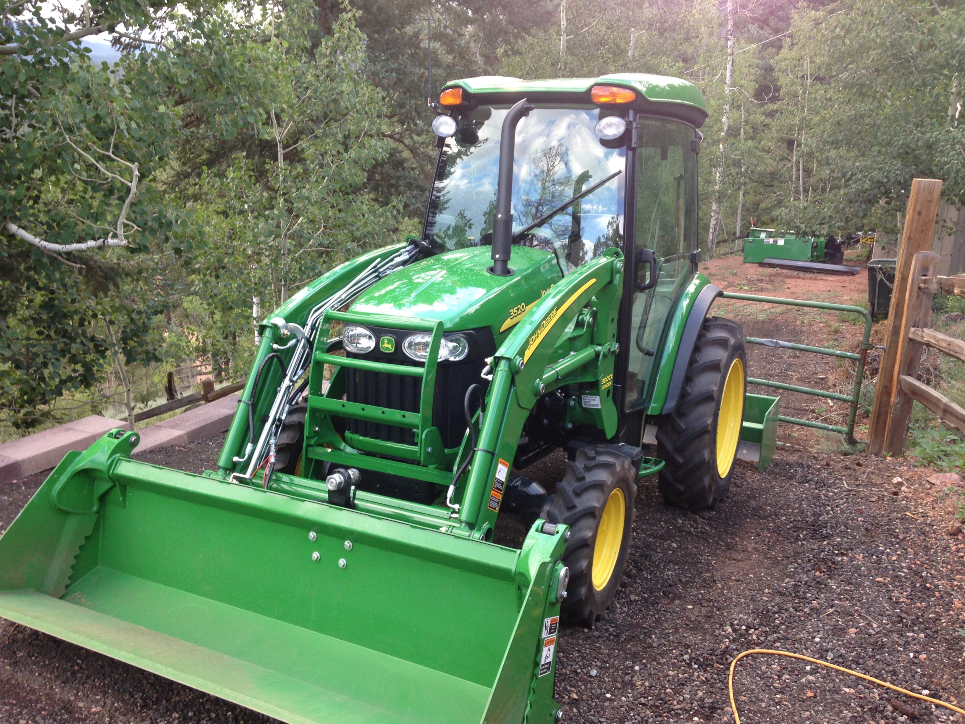

Don't know much about the 4x20 series but I have a new 3520 Cab and with R1's set at their widest and filled it is very stable and there is very little level ground around here.
You can see that even with the fender extensions the wheels are wide.
/ 3520 or 4120 / 4320? #4
72" box blade with 420 lbs of extra weight. I also have a 72" 4-in-1 bucket. If I fill the BB I will usually start spinning the wheels but the power with the turbo at 8600ft blows my 790 away.
