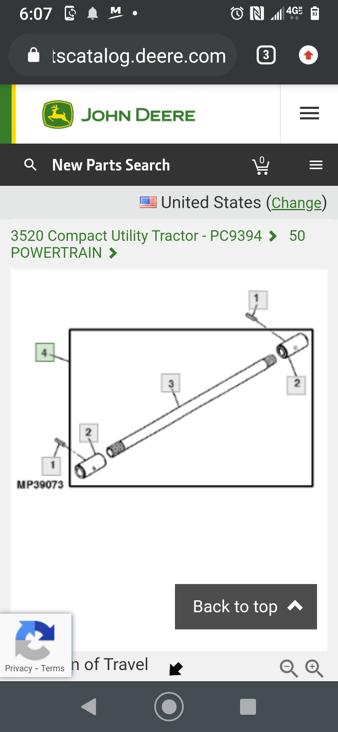

The roll pin through the collars are to keep the shaft centered while the roll pins are installed. When they are removed the collars can slip over to either side and the the shaft can be removed.
It sounds like the roll pin is worn off enough to let the collar move and disengage from the driveshaft. It also sounds like the splines are worn.
The fix might be as simple as replacing the roll pins (inexpensive fix). If the splines on the shafts are worn badly then eventually the shafts will need to be replaced (expensive).

Yes, you are correct. One roll pin was broken.

After closer inspection i ordered new collars, roll pins and splined shaft. I'll also inspect the spline shafts on the transmission and front differential. The collar on the trans end had absolutely no wear. The collar on the front diff did have wear on both ends. So, that will or may be a problem if the diff shaft is worn.

I will inspect the entire drive system for the intermediate shaft today. Trans stub splines, front diff splines. I went ahead and ordered new intermediate shaft and the two splined collars with roll pins.
From looking at the shaft and collars main concern now is the stub shaft on the front diff as there is some wear on the collar on the end that connects to the front diff. The trans end collar was good with no wear on the collar end that goes on the trans stub.

Instead if standard split roll pins, consider spiroloc pins. Thinner layers of SS spiralled 3 turns or so.
