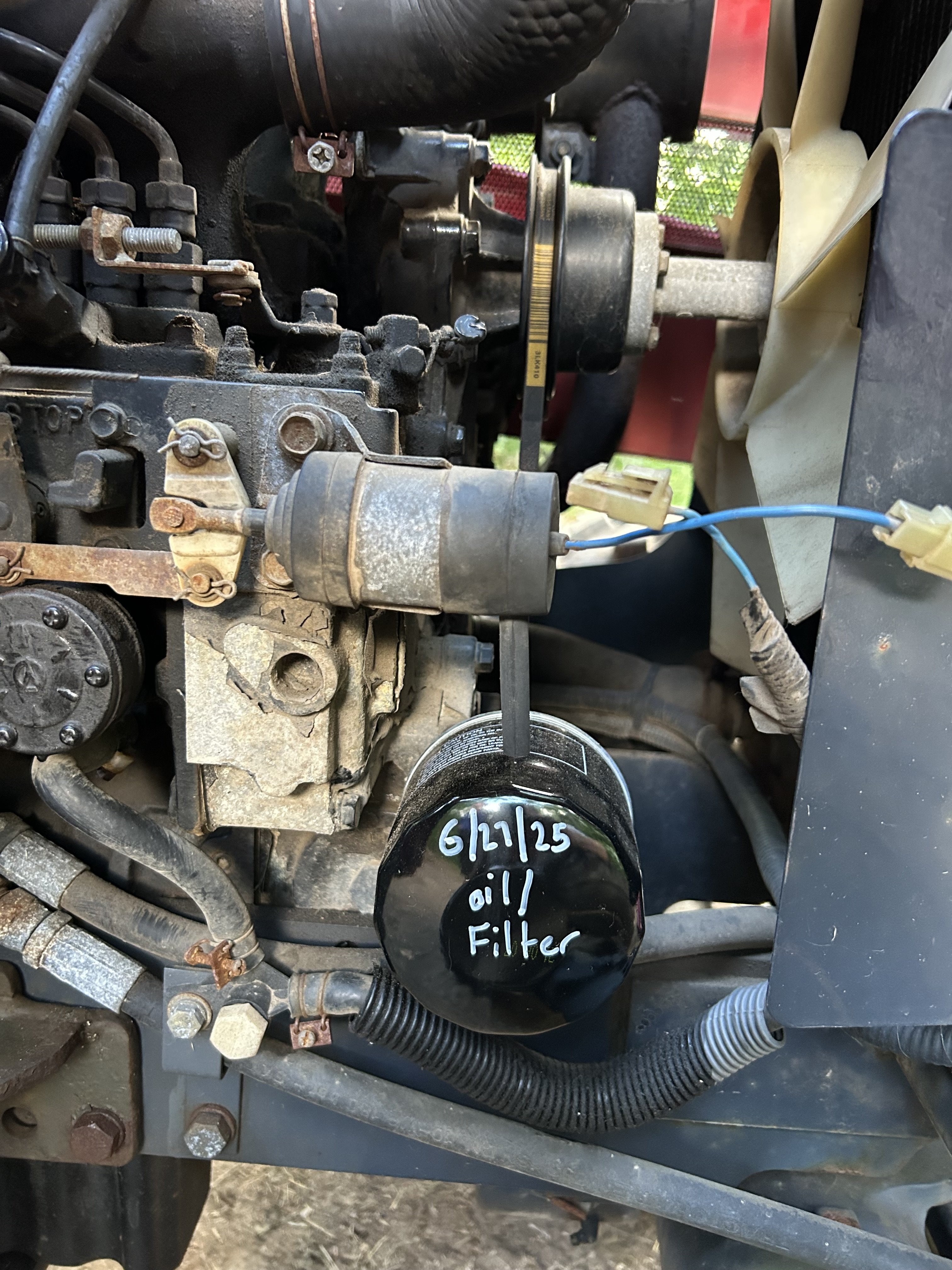

Ok update on the issues.
I have looked at the radiator.. seems to be clean and filled. I haven’t run it much since the light turned on so I will keep an eye on the temperature as I continue to use it.
As for the sudden shut off and check light…
Sudden shut off I believe is either this solenoid actuator attached to the emergency fuel shutoff T-Handle under the dash… or it’s the ignition switch.. (I believe it’s the solenoid over the ignition switch) which was throwing the light on constantly..
According to the manual (though it favors shuttle shift style) the key is what shuts the whole tractor off.. I.e. that solenoid actuator electronically shuts the fuel off..
My tractors solenoid actuator was turning it off while it was running.. again is it the solenoid actuator or the switch? I unplugged the solenoid and for the little bit I ran it today it did not turn off..
Now for the light… after I unplugged that solenoid actuator.. I still had the light but this time it was flashing. So according to the thread posted by @Offroadtek the culprit is either the seat safety switch, the brake safety switch or the pro safety switch..
The previous owner eliminated the seat safety switch with a wire in the plugs. The ptos and switches were all off.. so I removed the bottom dash panel and figured out that every time I push the brake petal that light goes out.. when I release it… it starts flashing… I remove a wire off of it.. light goes on constant.. so I figured that is the other culprit.
Now to run it for a while to see if these are true.
Does anyone know the name of the solenoid actuator is? Is it the fuel shut off solenoid?

I assume the brake switch is either the brake safety switch or the brake light switch?
