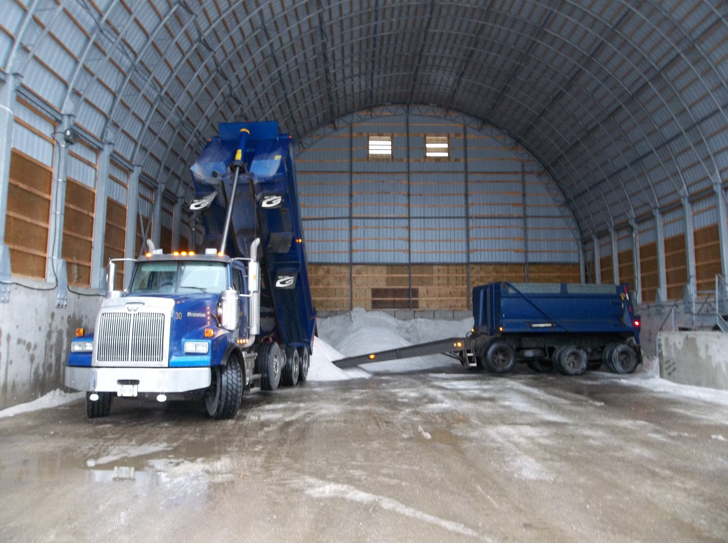

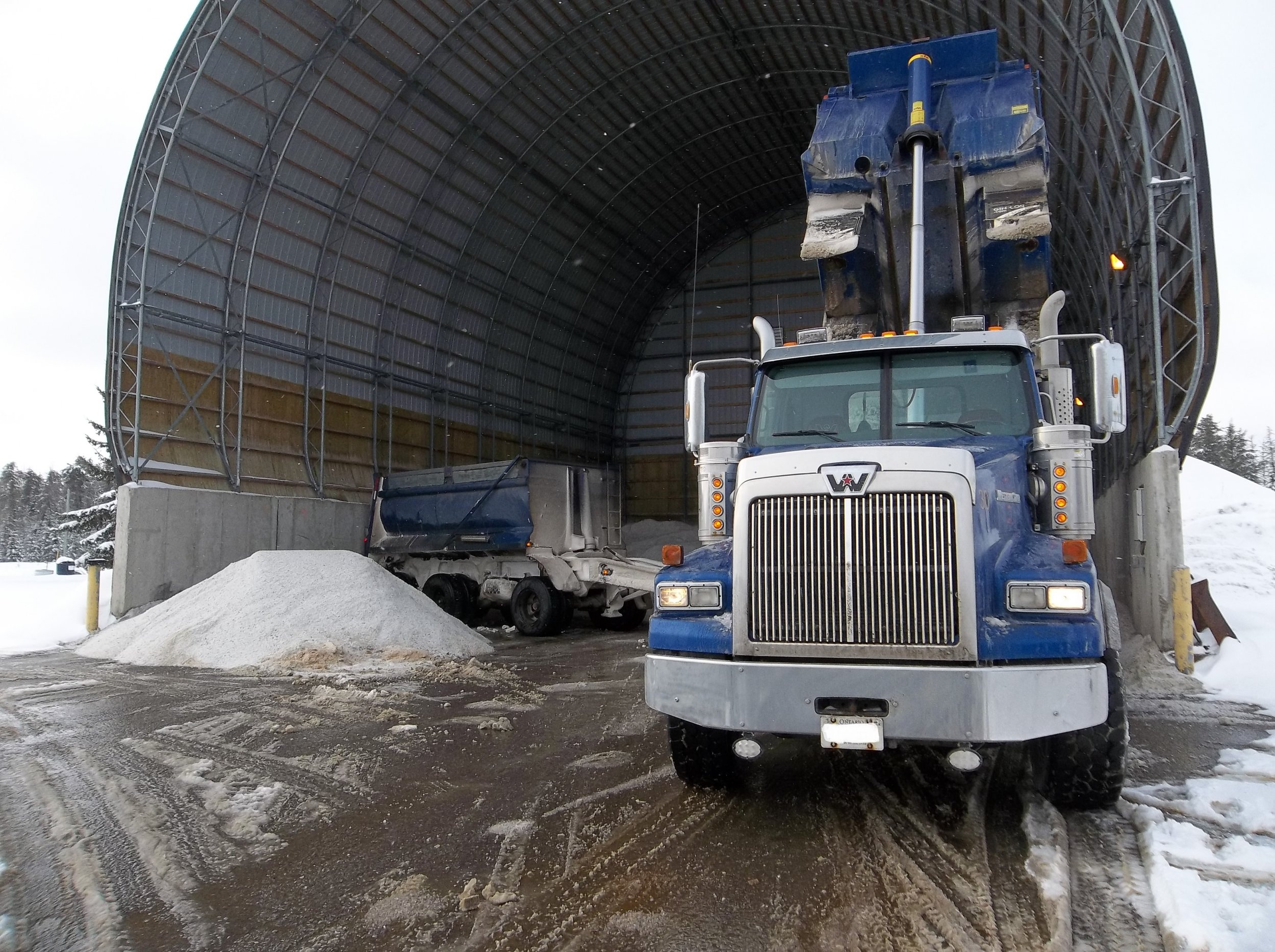

Really? I've ran them on dump trucks with 72 inch spread and 46,000 pound rating and they were almost as good as the air ride. Worst ride I find is the Hendrickson RS rubber block with the three round pucks.
I prefer air ride on the trucks, but I liked having the Chalmers on the pup trailer because you could pick the rear tandems up off the ground with the lift axle and pivot on that lift axle to jack knife around stuff.
