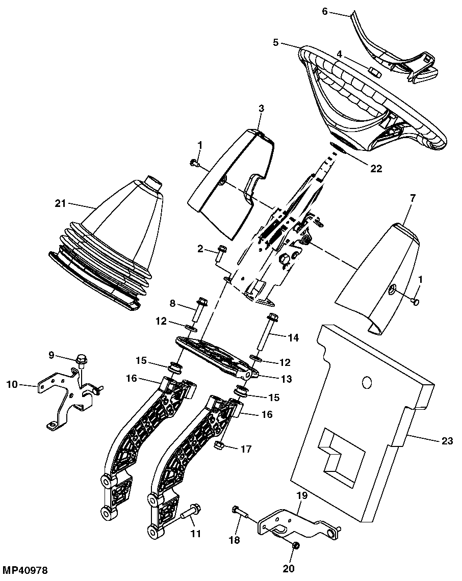

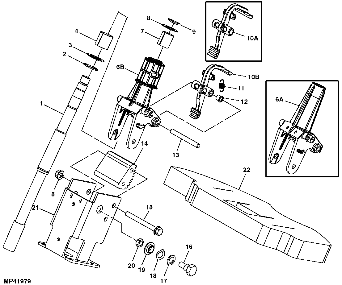

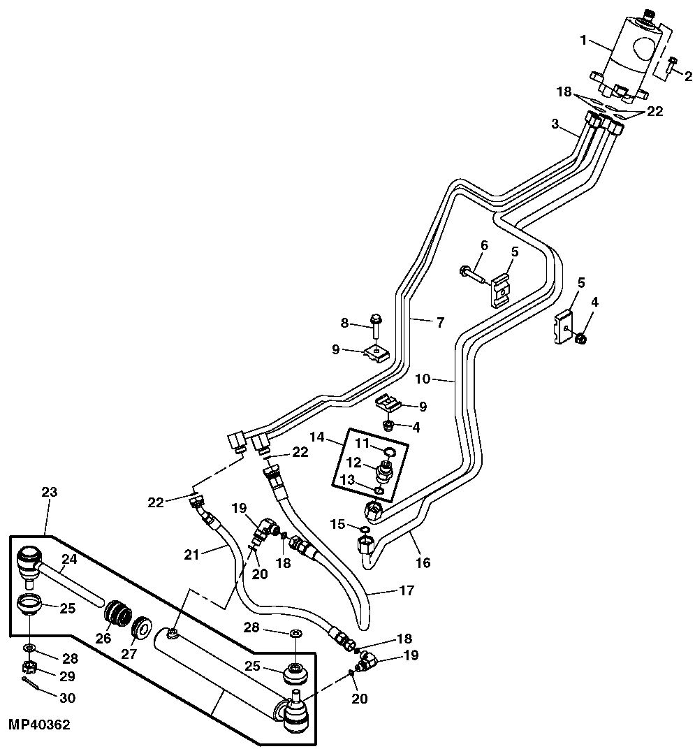

I will post some pictures from JDParts.
The cylinder is attached to the frame and one wheel, with a tie rod running to the other wheel. The valve is buried up in the center under the steering column.
I am not sure how the steering wheels connects to the valve, but possibly a bolt or pin fell out since the wheel is just turning freely.
The steering get's it's power from a dedicated hydraulic pump, but uses the common sump for it's oils supply-so if your other hydraulics work then I doubt your low on fluid. And since the wheels go back to the left I am going to assume the valve and it's feedback are of since that is probably when it let go so it thinks that's where the wheels need to be.
So, my suggestion...If the steering wheel is just turning like it's not connected to anything, then you need to get to where the shaft connects to the valve.
Hope this helps...
