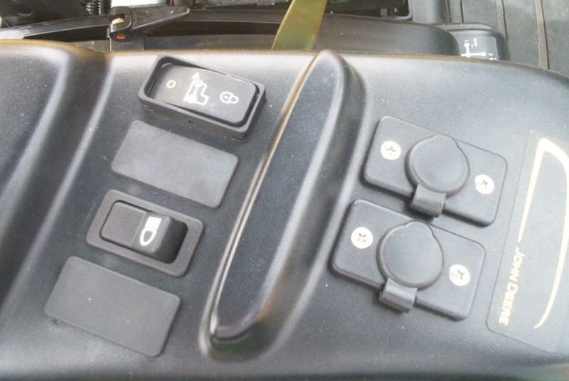

Your 3320 and my 3520 are the same basic tractor. Why take a chance on burning up your light switch and maybe your tractor? I do not know if you have the upgrade on the cruise control but if you don't there is an alternate solution. You can go to a marine supply store and buy switches to go into the spaces on your right fender. A gator light switch from JD will also work and keep it "ALL JD". They snap right in. You just neet to remove the two screws and two 10mm bolts from under your fender to raise the console. 5 minute job to remove and replace. Run a hotwire to the fender and you're all set. I also put in a couple of cigarette lighter plug-ins while I was at it.

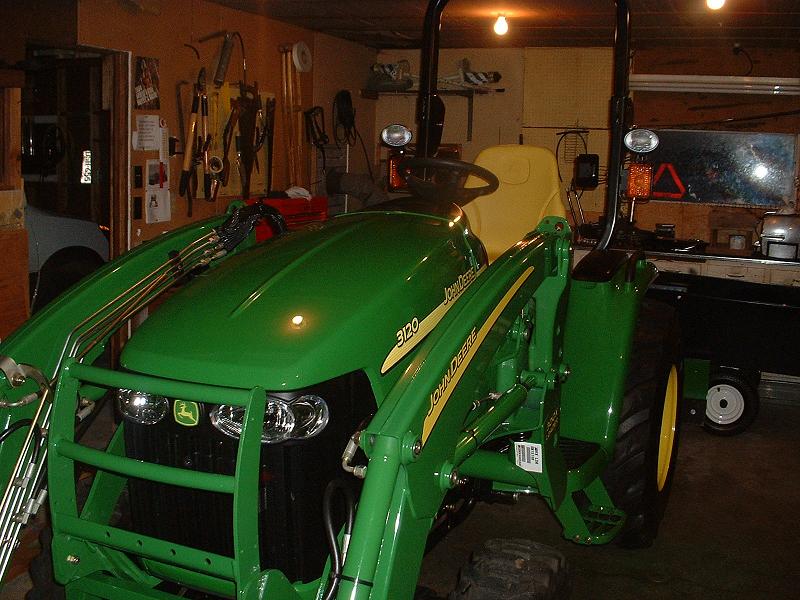

This weekend I am putting 3 more switch in on my 3120.I have the forwarding and daul rear work lights already but it am putting in grille strobes and 2 work light from JD dealer that will light up the sides of the tractor.And a beacon light for the top of the ROPS.There is 3 out lines under the console where my cruise control switches which there is 3 and the fourth has a switch for my trailer marker light option.The other 3 will be mounted in front of that for the new light switches. Here is a picture of when I got the tractor with the forwarding lights and daul rear work lights.Will post a up graded pictures of the console.

JD3520 did it right. I searched and found his JD Switches reply.
Part number for the gator switch is AM117324 BTW. Thanks JD3520 for the info!
JD3520's Picture Here
/ 3320 and 4 Aux Lights #10
Wish I could take credit for the switch idea but someone else on this forum came up with it. I just took the idea and ran with it alittle further. Since that pic I have installed two more switches. Don't need them yet but it looks nice. The wire I orginally ran was big enough for this expansion.
Don't forget to fuse the wire at the origin with an in-line fuse or fuse link.
Remember a 10mm nut driver, a phillips screwdriver, and two minutes will have the console removed so removal of the dummy blocks will be easy and not trear up the console. Don't try prying them out w/o removing the console or damage will occur. There is plenty of work room once the console is removed.
