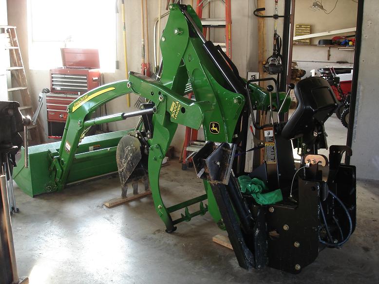

This is the best way I have found to store my loader and hoe. it is very stabile if you put 2 2x4s under the back of the hoe. I also put a strap on the stabilzers so they dont leak down. the angle is perfect to pick and drop, I only use the rockshaft to lift in place.
/ 3320 + 448 backhoe - first impressions #10
I started storing my 430 loader and 48BH for my 4410 that way as well. Takes up less space in the garage.
"Daddy, are the 448 backhoe and the 300cx loader in love?"
