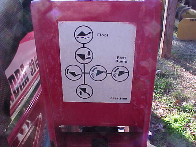

After owning my 3215 HST almost two years now, I'm almost embaressed to admit I recently found it has a quick dump feature with the FEL. The diagrams are right there on the FEL. I always new that if you pushed the joystick control all the way forward you can get the bucket to float. But the other day I noticed the diagram showing that if you push your joystick farther to the right, you get a faster dump speed. The only note I have on this is that the diagram is misleading. I actually get the fast dump mode when I push the joystick slightly to the right. It slows if you push it farther to the right. Was wondering if this is the case with other 3215 owners?

I just checked my 2815. seems to have a slow/fast/slow dump lever
/ 3215 quick dump #4
While the bucket is loaded push the loader joystick all the way to the right untill it stops...
Then you will notice how the fast dump really works:eek:

Here's a photo of the quick dump label on the FEL.

Can't seem to get it to work like Wallace suggested or as the label shows, pushing all the way to the right. It seems to operate like khamil says-slow,fast,slow as you push the joystick farther to the right.:confused:

The feature is actually called "regen" or "regenerative". You can read more about it HERE if you would like;)

The bucket needs to be loaded for the regen feature to work properly, Click the link I posted above.
/ 3215 quick dump #11
As well as having the RPM's up a bit. If you are running it at idle it won't really work.

They must use two different valves. My 08 2815 has the decal showing a fast dump position but there is no detent and the bucket does not fast dump. I stopped by the dealer and we checked several new tractors, found the fender mounted valves on 2815 and 3215's had the decal but did not have a detent or fast dump feature but the loader mounted valves on 2816's did have a dump detent like the float position. I think the 2816 valve had one or two more hoses than the fender mounts.
/ 3215 quick dump #16
The all have regen in them. The valve on the 2815/2115/3316 does not have the "feel position" regen that the others have.
