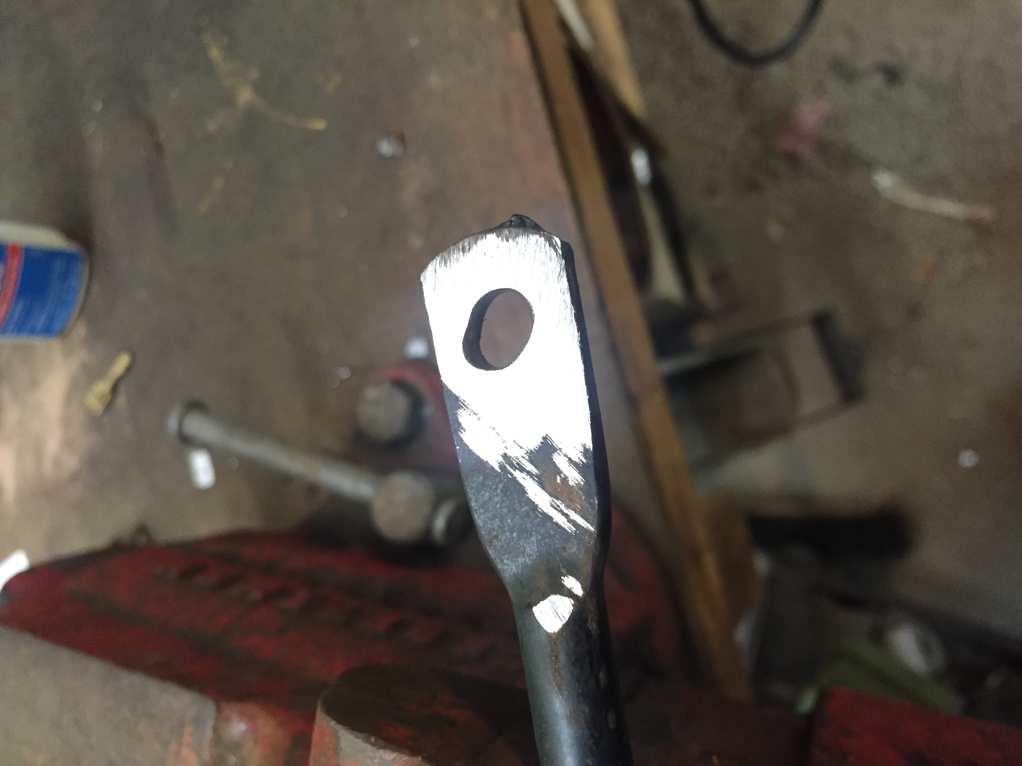

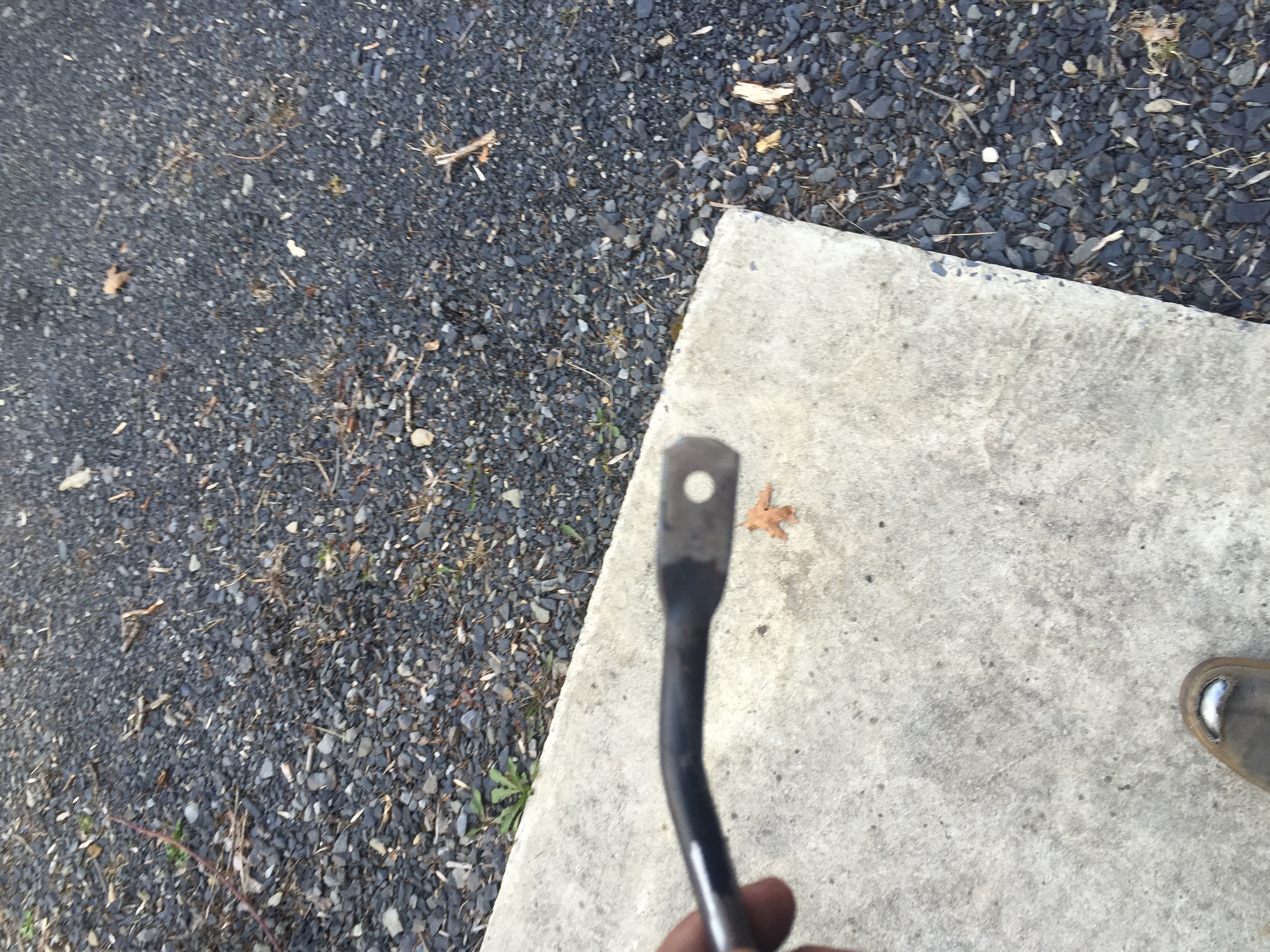

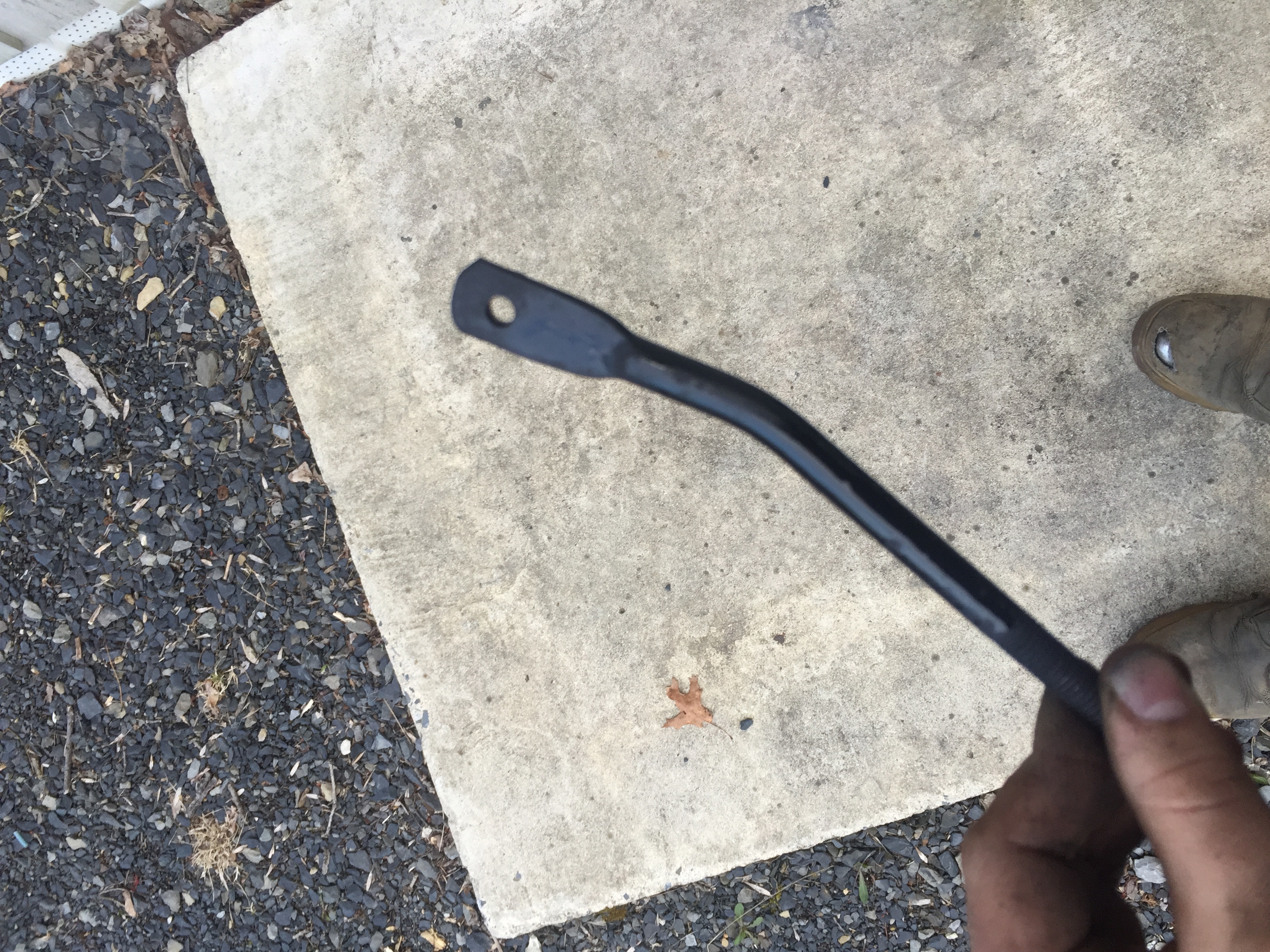

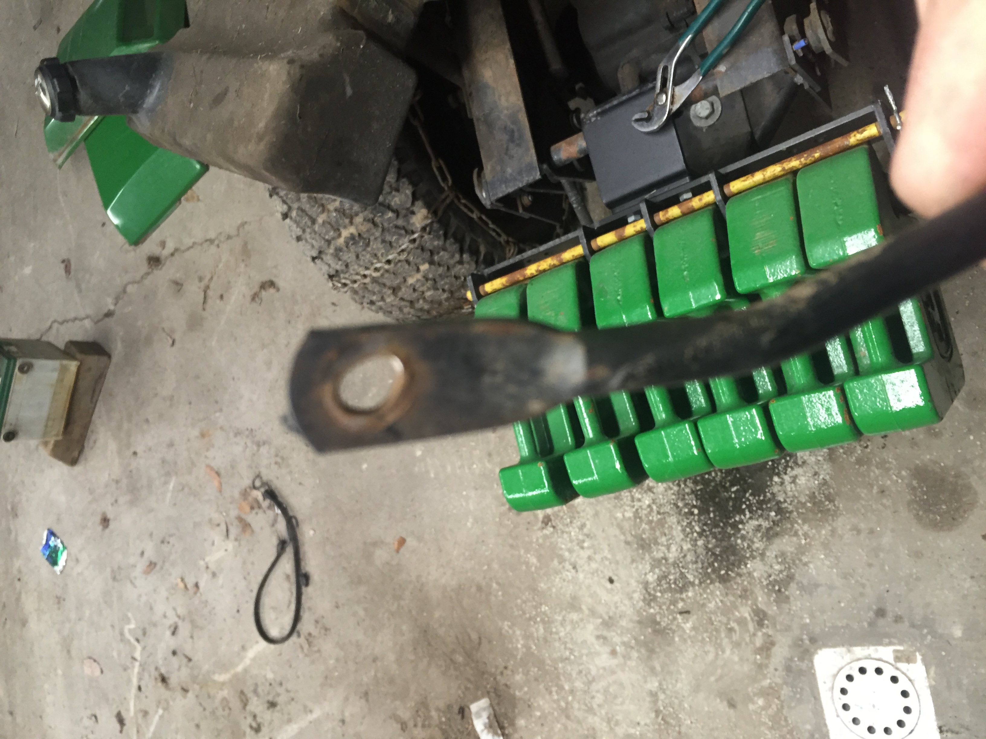

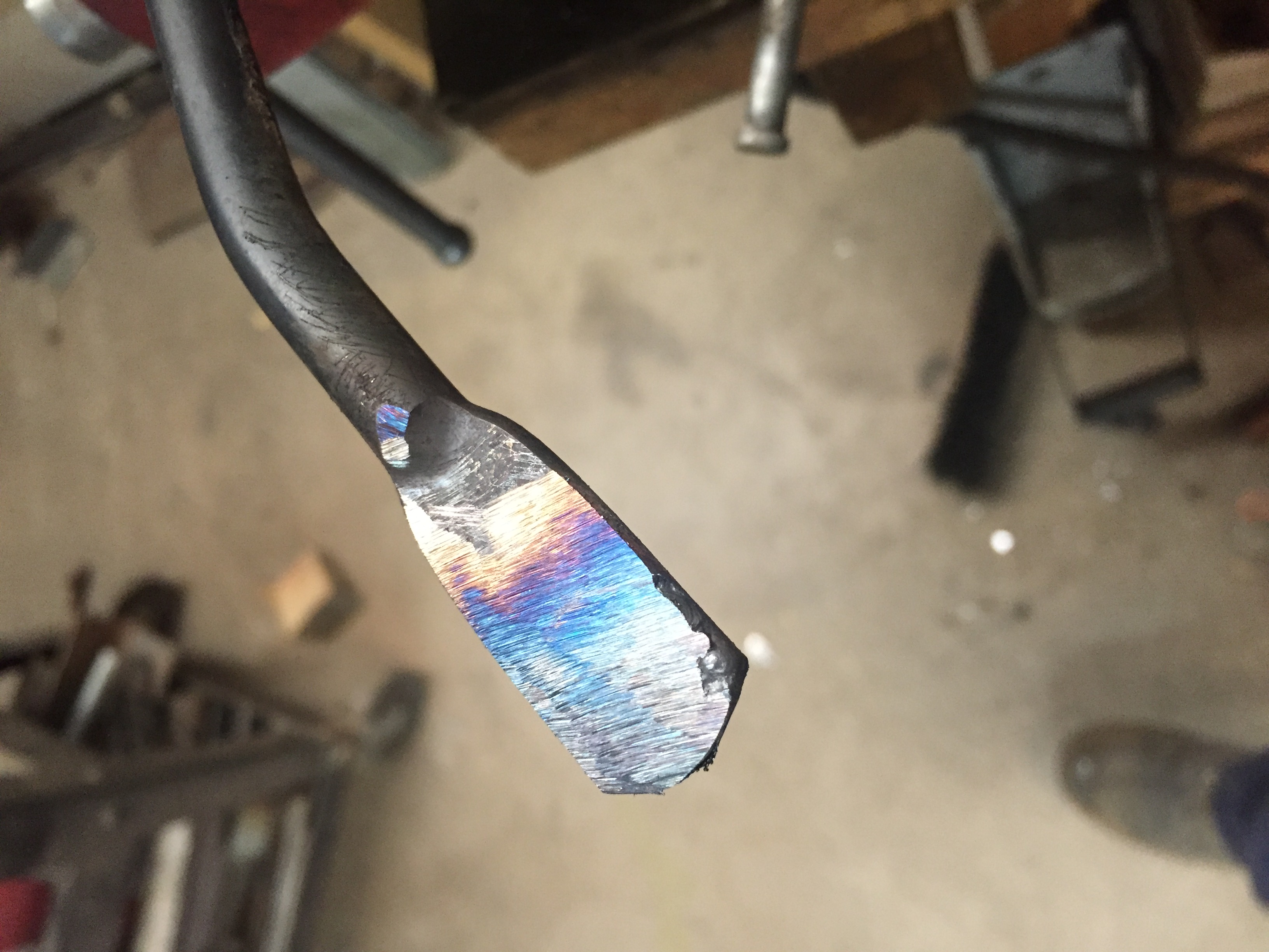

So I changed fluid and filter and drove it around, the transmission doesn't seem to make as much noise as it used to, but still just didn't seem to have the power it used it. So today I took the seat deck cover off and the side of the dash tower. Pretty sure I found the issue, The rod that goes from the turnbuckle to the hydro lever at the dash, the hole in that the bolt goes through is worn very oblong allowing about 1-2 inches of movement in the whole linkage without moving the Hydro lever at all.
So by having this play in the linkage, its allowing me to have the hydro lever almost 1/2 way up the dash before it even starts pulling on the linkage attached to the transmission. Therefore giving me the feeling I am only at half power, cause in reality, I am!
/ 318 Lost Hydro Pressure..
#9
ALL BETTER. AND WHAT A DIFFERENCE THAT MADE!!!
