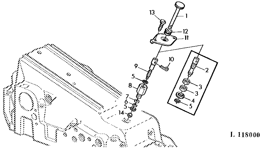

G'day all I have had a job come in to the shop and as the title suggests it is a cabbed 3140 with the three point linkage stuck right up in position. I have not had a look at it yet and prob won't get to til tomorrow so I thought I would throw it out to the JD guru's here and see if someone could point me in the right direction.
I have had a quick look when I washed her down and it seems as though the control linkage is moving free enough and not binding. Is there a transport lock I should be looking for somewhere?
Thanks in advance
Jon
/ 3140 3PL STUCK UP????? #2
Turn rate of drop screw(parts key #1 CCW) a little bit

G'day thanks Jim will have a look at that when I go in this morning
Jon
G'day spot on thanks Jim opened the valve and down it came :D thanks for your input. I am used to seeing those on smaller tractors but we don't see drop controls on machines over about 50hp here.
Once again a big thankyou
Jon
