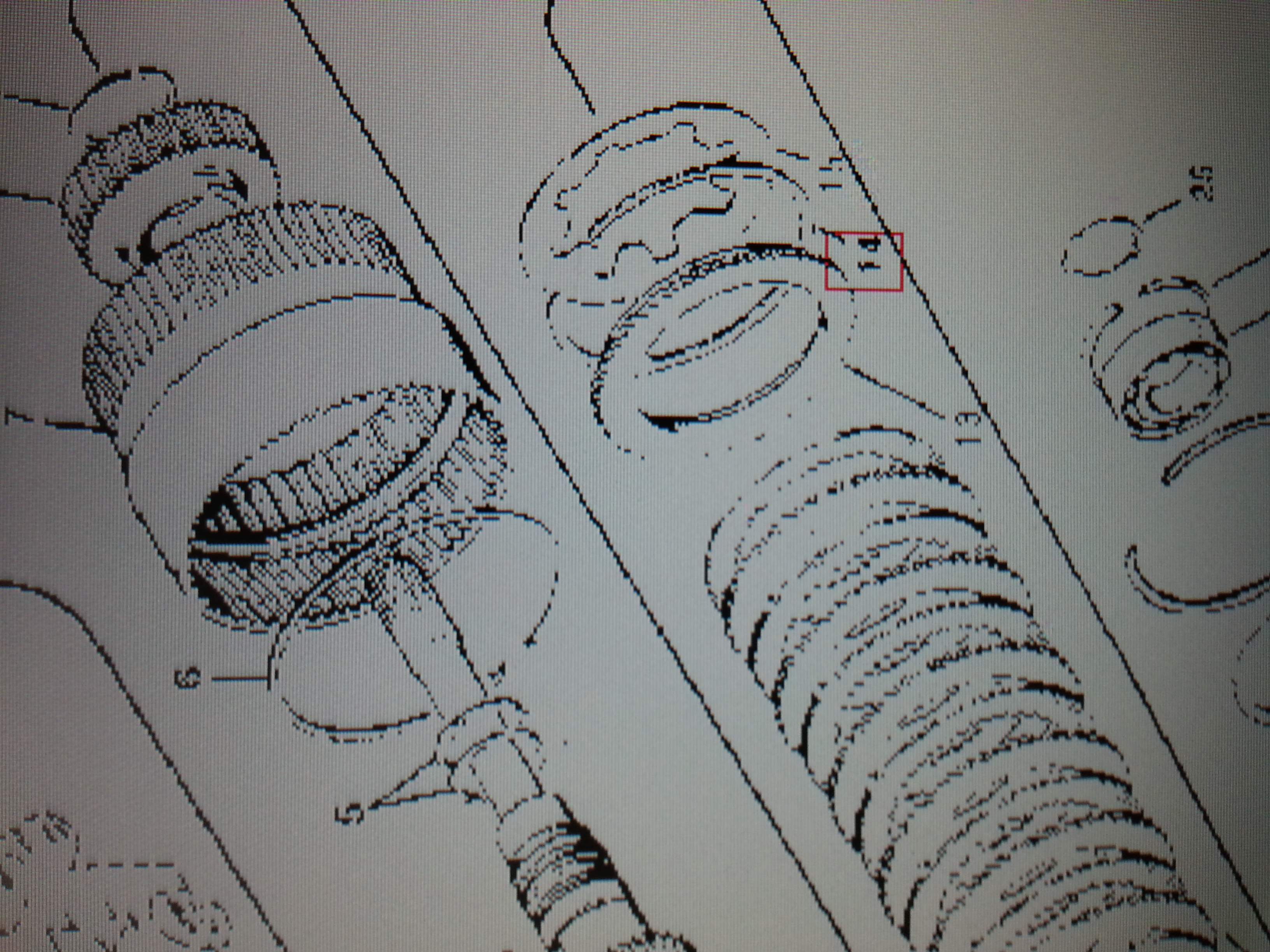

Hey guys just got in a 310d that we have been useing lightly doing. backhoe stuff... anyways we had some trouble geting the thing moving so i jumped on it and it worked fine then i was driving and it slowly lost power in wot the thing just creaped in 1st. put in reverse and it hooks and feels great!... messed with it for quite some time seing if warm vs cold oil made any difference... did not matter it came to the point where i lost forward completly. ok first thing first oil level good so i started at the fnr swich. with the park brake in put in reverse buzzer starts put back in N buzzer quits in F buzzer starts... ok signal being sent. click click in the relays. checked power down on solenoids power seemed normal so i pulled the magnets off put my diagnostic screwdriver in the mag.s and mags both felt like they where doing thier job. cool. pull the plug.. minimal material.. but enough to make me think maby something came apart maby just a seal ring.
so enough chit chat got the thing out and on the bench and started diss assembling. after inspection clutchs good o and the oil felt good when i pulled it.. all the seal rings apear to be fine (none broke) bushings look good so on the phone i went. someone mentioned case breakage but i wasnt on the phone my brother was talking to him none mechanicaly inclined he is not. but that brings me to my head scratcher. where is that crack if it could be that problem. i have not taken the valve out that runs the oil pressure fnr as the spring pressure on it was stronger then my thumb so a tool fab is next but any tech would be well appriciated o and hooked air to the one piston in it it worked

20121219_085711.jpg this snap ring is weird it doesnt seem to have much of a ring to sit in confused a little

gale i think you missed what i was getting at i lost forward completly and have now dissassembled it completly looking for what has gone wrong. i did dig a little farther into it today took the fnr valve out and inspected. doesnt look the best little wear showing... also what i thought was the forward clutchs are the reverse so i now have the forward clutchs out and they do show a little color but should have still griped all the carbon fiber clutch material was still intact and gale thanks for your input but water in my oil was not my problem and as far as crack cases on functional equipment mine wasnt functional and i was refering to maby a crack in the case dumping oil pressure or something like that
