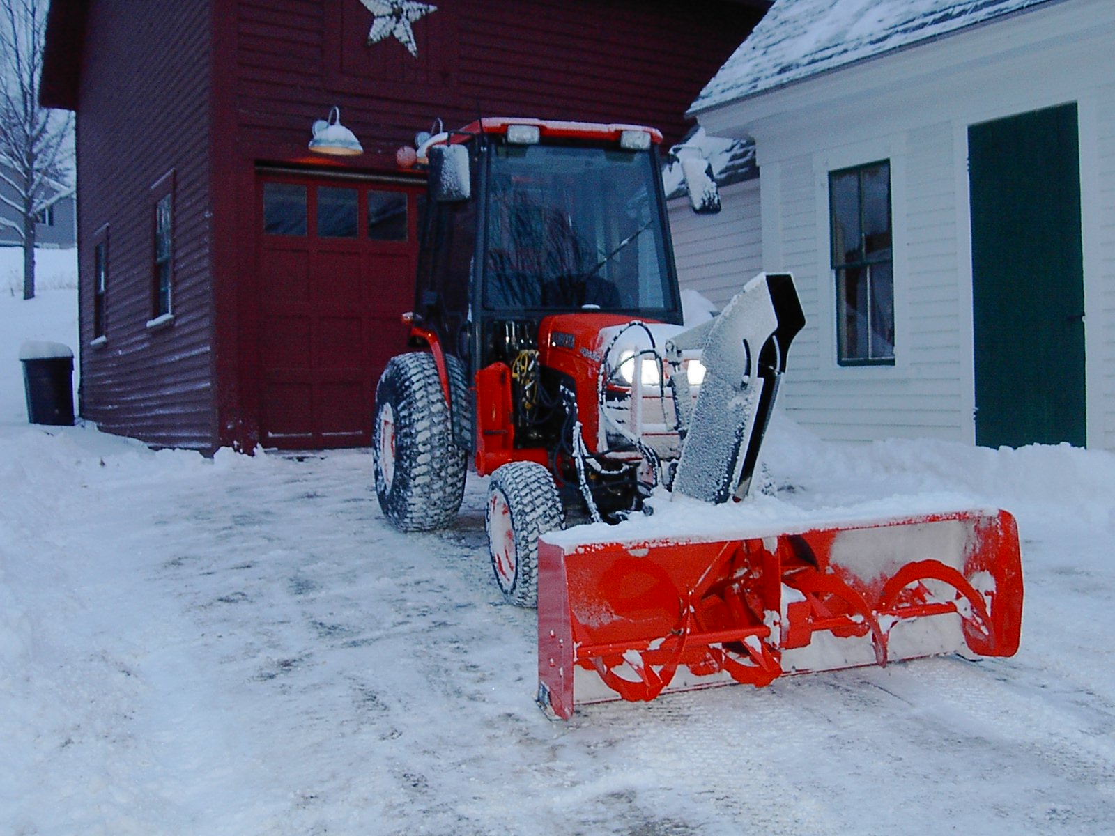

+ Me on the Kubota B3030 though right now I understand that there are great deals on the B2630 though you can't get that model with a factory cab. The standard blower is 63" I believe, and the mmm's are 60", and 72" and are ground contact mowers. If you leave off the factory cab, the Kubota B2x20 series, and JD 2000 series will also work very well for those chores. They both have drive over suspended mower decks (54", and 60") and both are available with front mounted snow blowers. The standard Kubota blower for the smaller models is 51" with "drift knives" that bring that out to 54", and JD is just now coming out with a 54" blower for that series. I would prefer the JD for finish mowing since the steering geometry is less likely to tear things up, and for the position control, and usuable steering brakes. I like the Kubota for most other things, and the B3030 does have the nice position control on the 3pt.
   / 30ish hp cab tractor for mowing and snow clearing #5
If her two targeted tasks are snowblowing and finish mowing, there is only one logical choice....... the Kubota B3030. If she wants to get into jobs that require a larger tractor, there are a bunch of great cabbed tractors over 30 horse. As good as the 3030 is, it makes no sense to use a much heavier tractor at 10 grand more money to mow and blow snow.
That's a sweet looking snow machine Ductape!
   / 30ish hp cab tractor for mowing and snow clearing #6
that is a nice looking machine Ductape. all posts seem to offer good advice. I can only add your choice may depend on what is available if you are buying used. Buying new you have lots of choices. also maybe proximity to the brand dealer location should be factored....just in case and depending on your ability to service. PS, nice to have a girlfriend that ants a tractor:)
