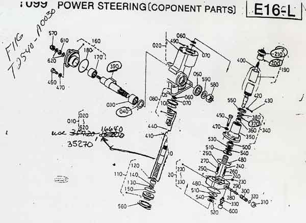

I noticed that my steering wheel seems to float around now like its mounted in rubber. So I took it off and removed the dust seal on top of the steering tube. There looks like there is a rubber type material bushing in there. But whats odd is I did not notice this much movement in the beginning. Does anybody elses do this? I must be loosing my mind.. /forums/images/graemlins/confused.gif

I have the service manual and it shows very little as far as the steering shaft. It goes through the column assembly (tube) and has a spring pin that attaches to what appears to be the worm shaft that goes into the steering box. This tractor is a 2002 model.
The manual only shows that there is a "column bush" at the top of the column tube. I'm guessing that is what's causing the wobble. If anyone has some drawings from the parts manual it would be greatly appreciated. After 35 hours of hard use my tractor is falling apart. /forums/images/graemlins/wink.gif

Here is a breakdown of it. It’s not the best in the world. Im trying to get a better one, this one is folded in the middle a bit. As far as the wobble goes most of that is usually in that rubber bushing, reason they don't put a bearing or something is to keep vibration down. We have thought about putting in a harder poly bushing in some but haven't yet. The shaft on that column isn't solid, it’s a 2 piece shaft that is held together by a pin and is allowing some movement side to side, so that may be some of your movement too. I’m not sure about the nut deal, maybe Ken knows. /forums/images/graemlins/confused.gif

Thanks for the graphic Jon,
Whats happening is that the top steering shaft (#400) is floating around in the bushing (#200) in the graphic. It would appear that this is normal perhaps? It might be that me getting on and off the tractor a billion times when I was moving rather large trees might have helped break in that top bushing and I'm now just figuring it out that it floats anyway. It has about 1/4" side to side movement..

I have found it to be normal to have some play in these columns. I wouldn't worry about it unless it just really bad. What year tractor is yours again? And how many hours?

Your CK shouldn't ever have a wobble problem. You have a differnet design steering column, like the DK's and the new LK3054xs. The only steering columns that will wobble would be the older LK's. They have a 2 piece shaft, where all the others have a 1 piece.

Ya some of the older LB's did, not as bad as the LK's though. A lot of it is the bushing, but the 2 piece shaft doesn't help the problem. The upper shaft just fits on the lower shaft loosely and is held in place by a pin. This design allows the upper shaft to wobble side to side on the lower shaft.
