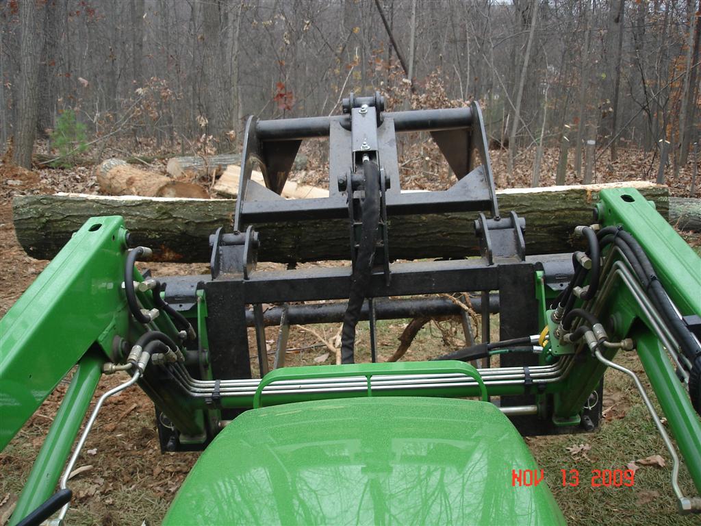

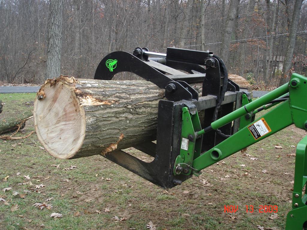

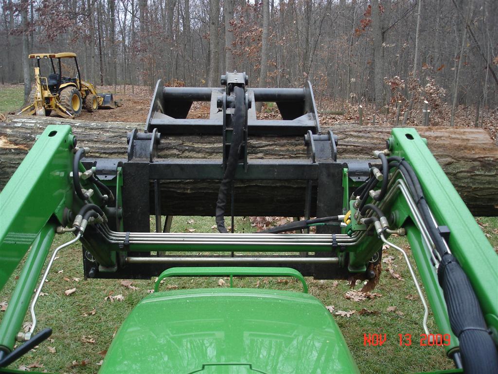

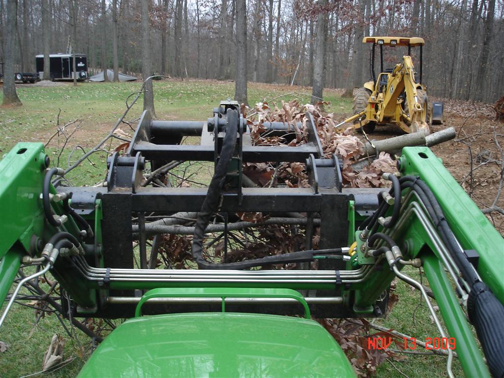

That machine is certainly up to the task, Heck, my 20hp 4110 lift 1000lbs!
But it sounds like your really need a grapple, here are some pictures of mine:

Powerwise, no problem..3038e has the power and hydraulic capacity. Kenny's suggestion about a grapple would definitely help clearing those trees.
