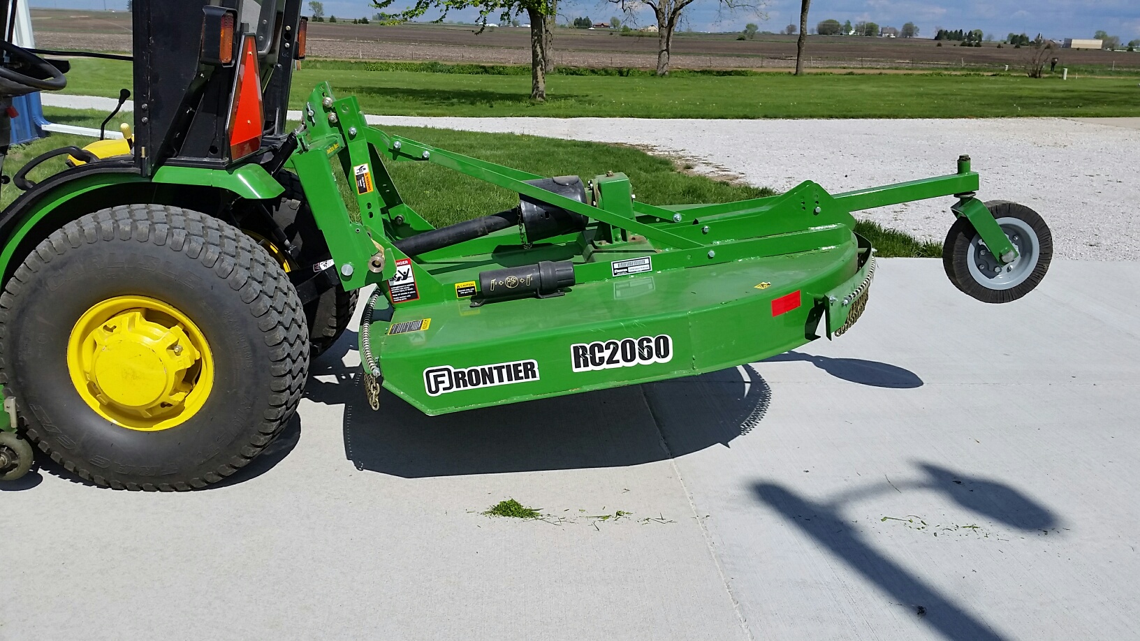

I run a Frontier RC2060 on my 2720 with no problems. But all I have mowed with it is brome grass after the crops are out.

I have the Frontier RC2060 for my 3032E, it works great. It will bog down a little in the tall stuff but I just slow down and try to keep the RPM where it suggests for PTO.
