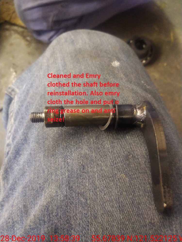

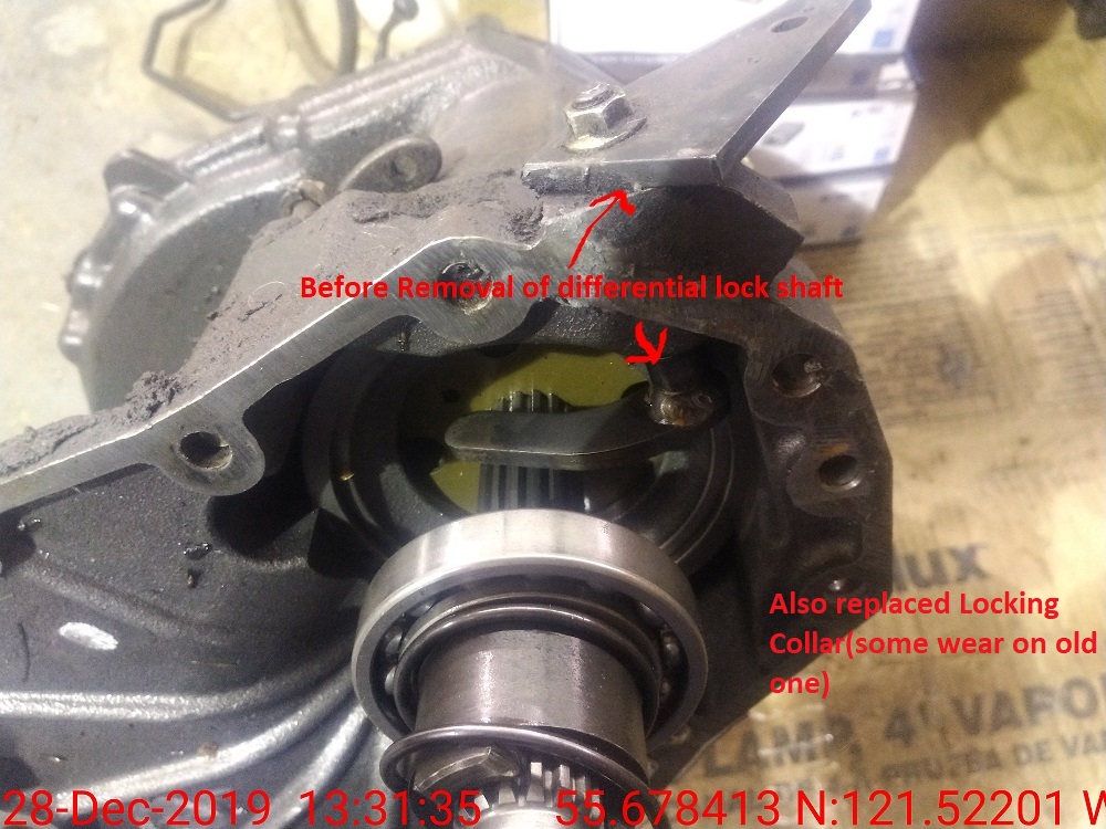

Push down with your foot and hold it there as long as you need to use it. release foot, and the rotation will automatically release. but do as others have said, push down at a really slow crawl so it engages smoothly and not abruptly. you shouldn't have to crawl at a snails pace to disengage. it will not stay locked when your foot is off it,(unless your shaft is seized like my uncles was...). if in the future it becomes a hassle, it is fairly simple to fix if you have some time and patience and are mechanically inclined :)
