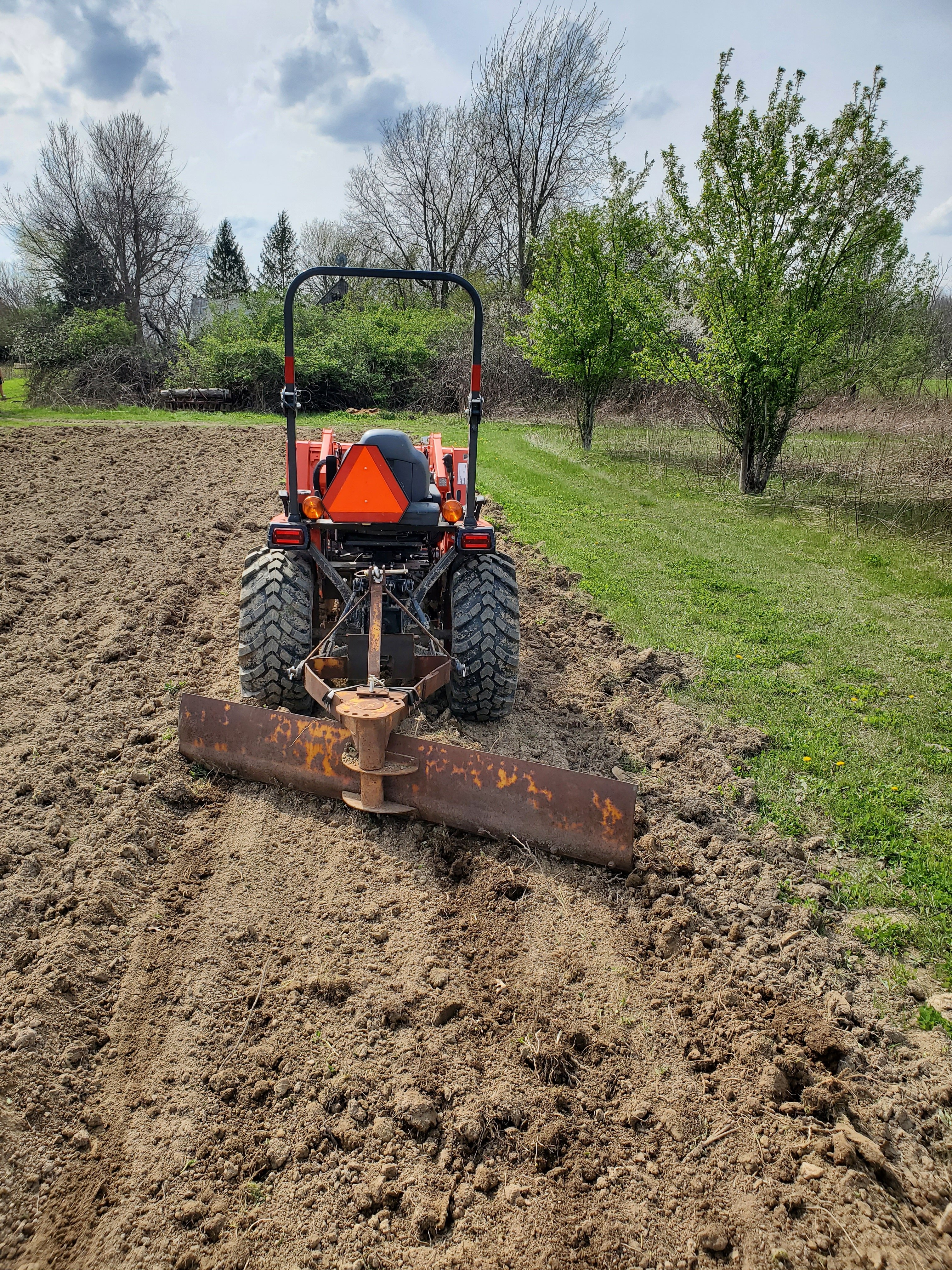

Tillage and grading. With the 4 wheels clawing through the traction is uneven at times. The diff lock balances this out.
It also helps significantly with an angled blade grading where the machine is getting shoved sideways.

I do wonder though -- unless you are experiencing wheel spin while operating (are you?) then I don't see how the wheel lock does anything for you.
That is exactly the issue. With tillage and grading the wheel slip is enormous. In the picture I was crabbing to stay on the path I wanted. Without the diff lock it was worse.
With tillage, though, like you say - in some areas only 2 of the 4 wheels are getting the most power - the 2 (front/rear) with least traction.

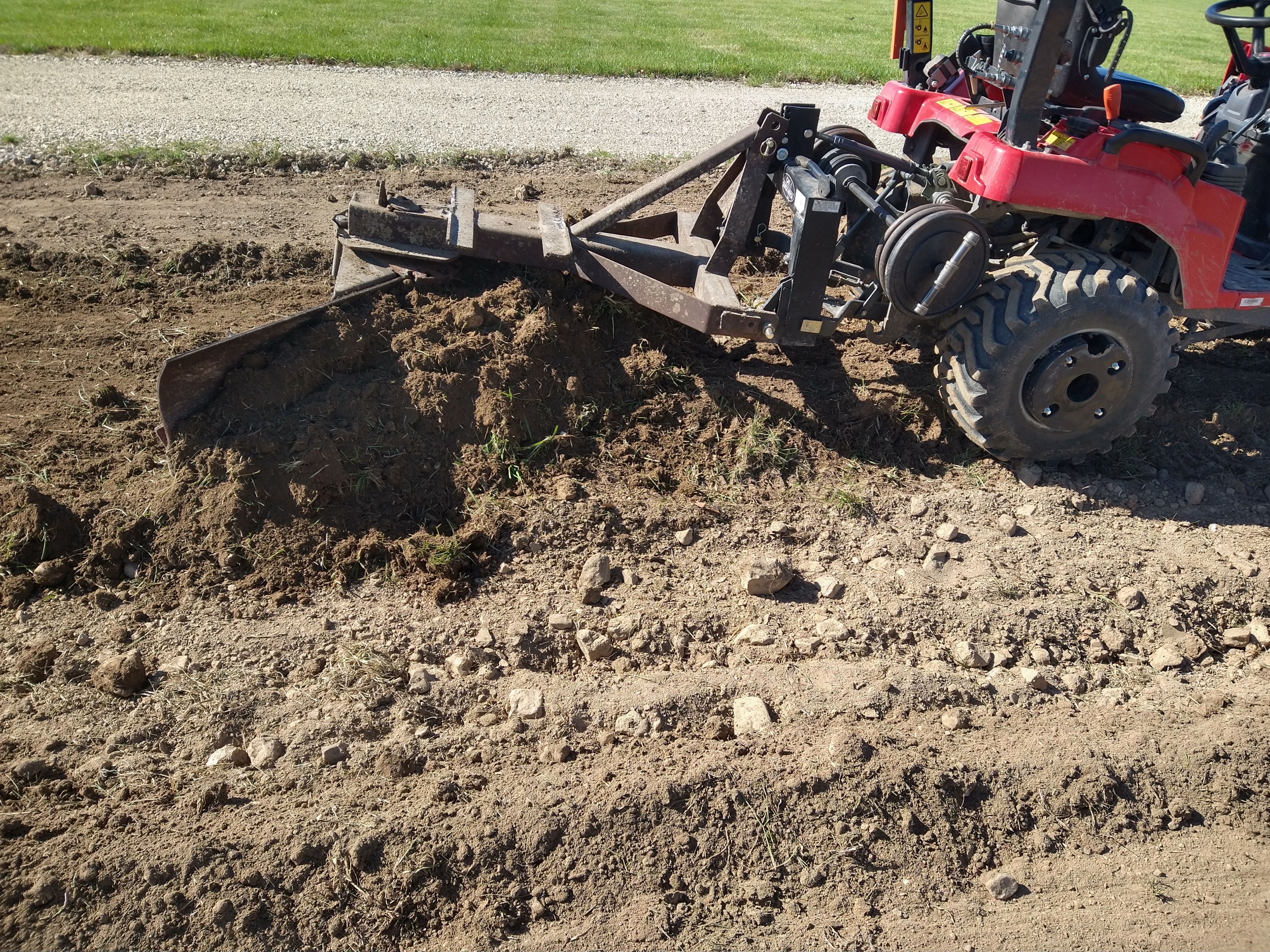

Sounds like you need more WEIGHT!
On my little tractor I added 275 Lbs of weightlifting plates which cut out the crab walking with my heavy 6' rear blade!
You need the weight on the tractor, not the attachment. I used my BH mount to add them.
Available Traction (i.e., the friction with the ground) is directly proportional to the force normal to the surface, aka weight on the wheels.

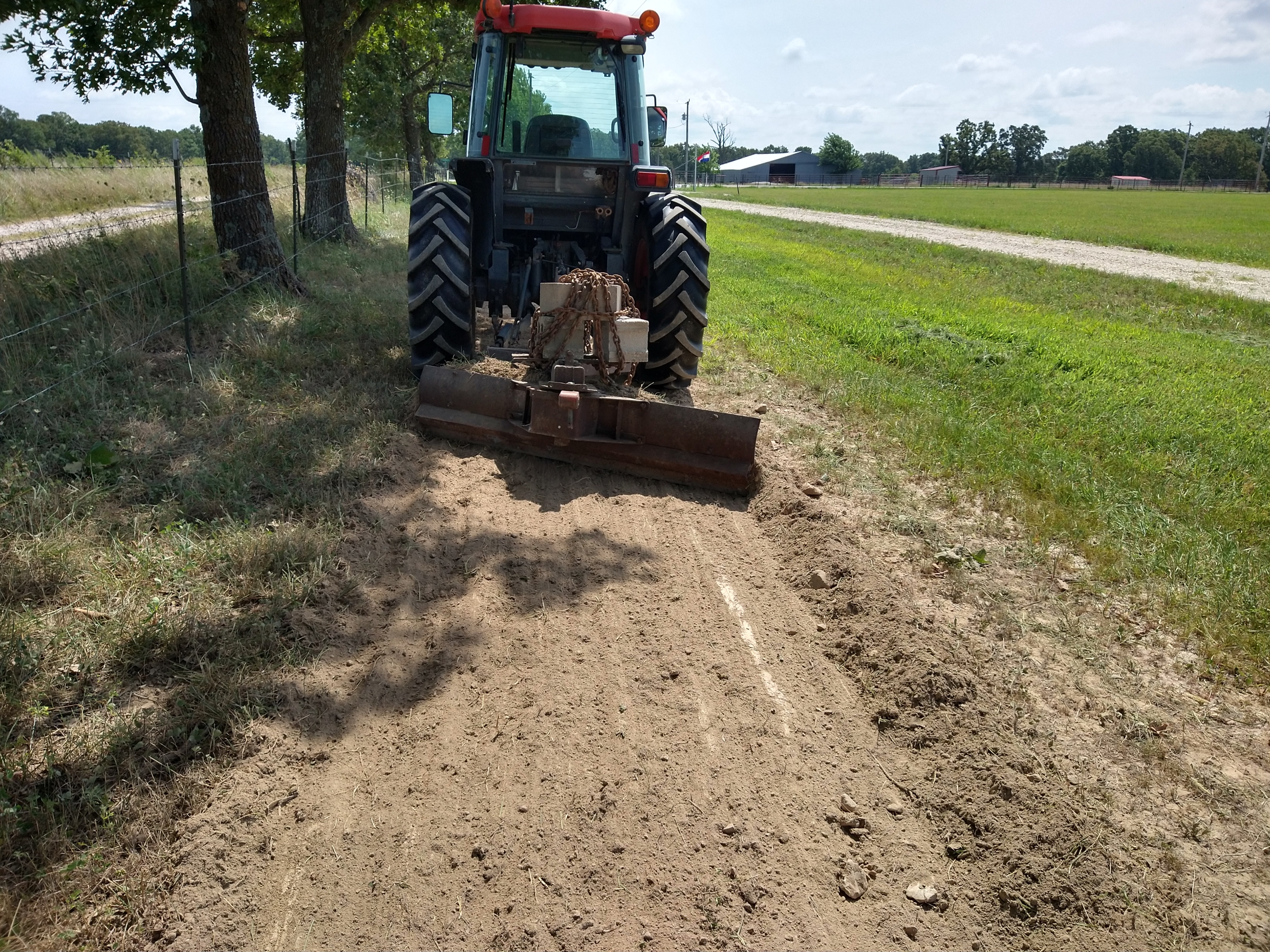

I pulled that exact same 6' blade with my bigger tractor, no filled tires, steel wheel weights, or additional weights either, like the little Massey has all three ... Doesn't even know its back there!
Full and overflowing ... Even has extra weight on the blade, didn't spin a tire in just two wheel drive, and no ... Axle wasn't locked either!
Of course my Kubota weighs a bit more than my Massey Ferguson, and has much larger tires too ...
Weight is a tractor's best friend most of the time, especially in traction challenged situations.
