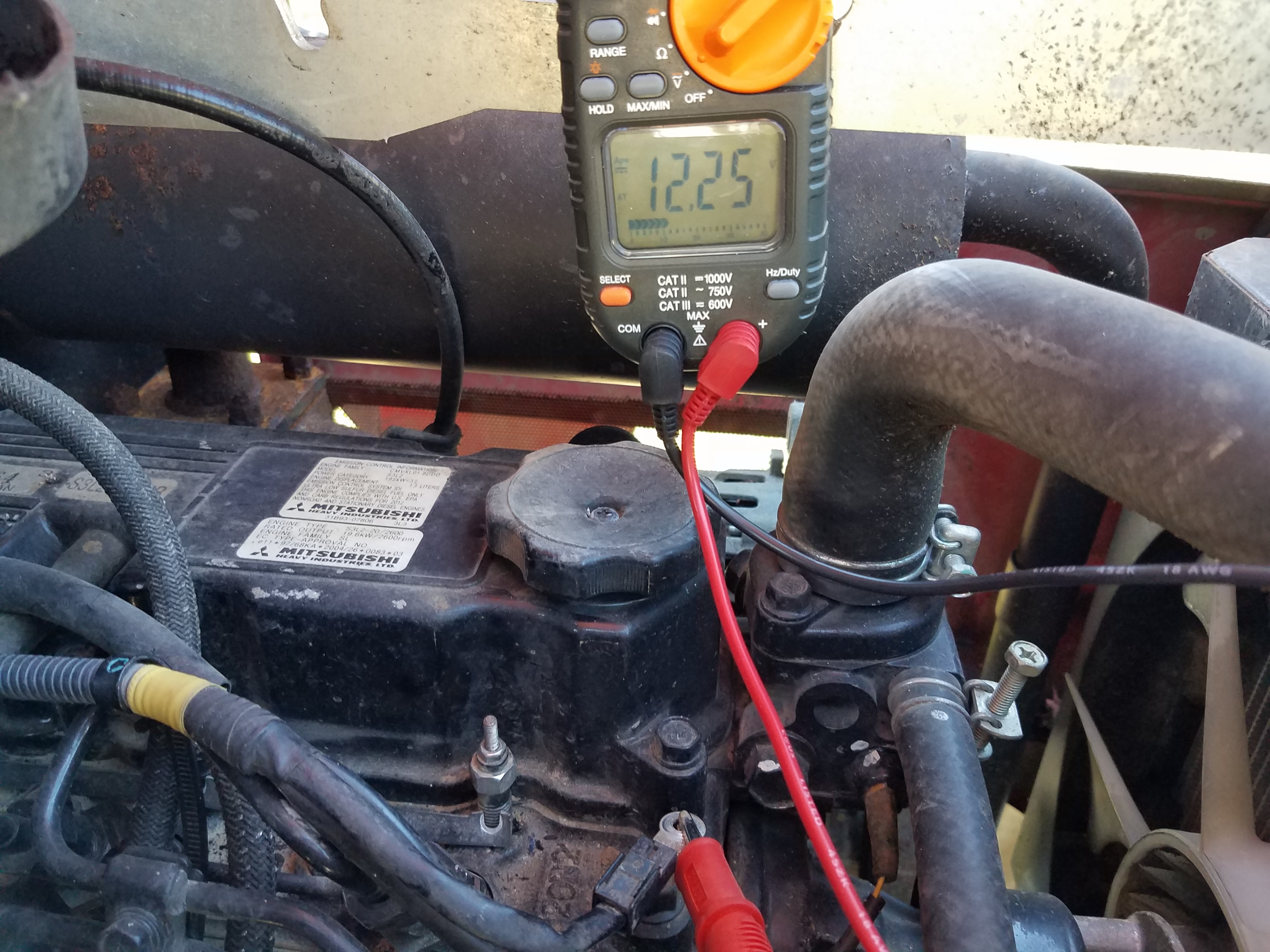

Morning everyone,
I have a 2013 3016 with 265 hrs on it. We had a cold front blow through over the weekend and now I can't start the engine. I am presuming it has something to do with the glow plug system as I can crank the engine but all I am getting is white smoke.
The glow plug light cycles as normal and I can hear the relay clicking as normal. However, I have been noticing that it has been taking a couple extra seconds to start even over the summer but this weekend was the first time I recall seeing the white smoke.
So does anyone have some advice or instruction on troubleshooting to determine exactly which component is the culprit?
Thanks in advance.
