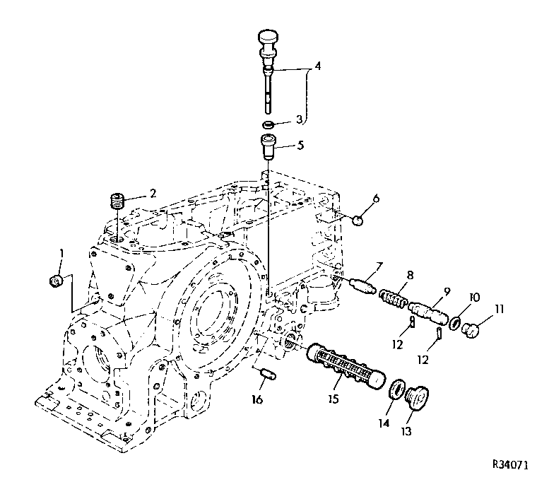

/ 301-a #3
DItto what jd110 stated. Here's a photo showing screen location in trans housing. IIRC ind tractors have a hyd hose attached to screen retainer fitting.
