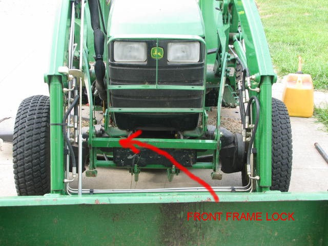

Chris,
Did you get a chance to see if the front frame of the loader
is locked to the tractor? The loader locks on the frame,
and if yours is fully or partially locked on the tractor,
i don't think you would be able to move much of anything.
See if the green square bar, that locks on top of the tractor
front frame is engaged with the frame, or rocked forward..
