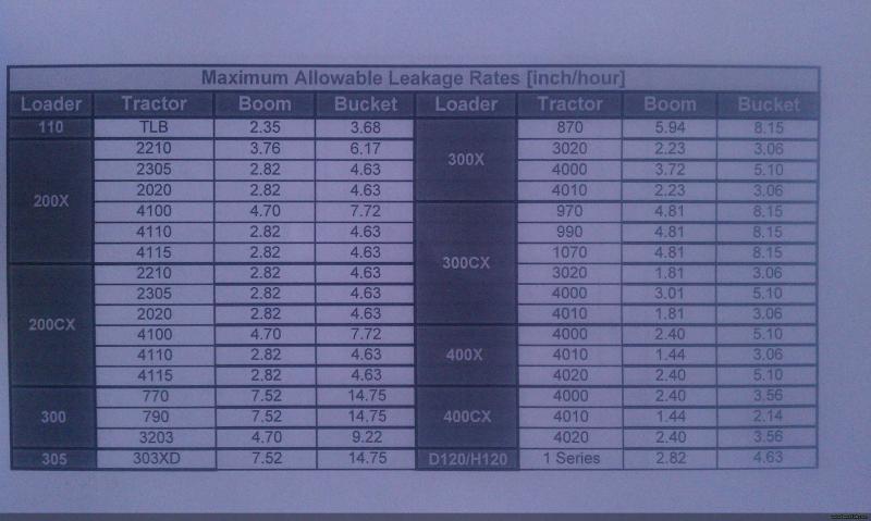

brand New loader. Im aware that these units leak down a little, however, im unaware of the rate. I had about 400-500 pounds suspended in the air with chains on my bucket while doing some welding today . I had to go back to the machine and start it up every 5 minutes to recurl the bucket because it kept drifting. Not the lift arms, only the curl feature.

That may/may not be excessive. You can discuss your observations with the shop supervisor at your dealership. He's got a 300CX technical repair manual which includes a max/min leak down time for the curl and boom cylinders. He can provide that info to you and...
You can test the loader at home and record the time and rely that info to your dealer. Depending upon what you learn... they may elect to repair the cylinders.
This is what Deere thinks to be acceptable

I had this same issue with the loader on my 2520 leaking down (main cylinders not bucket) and deere said it was within tolerances. Interesting to know that it varies by the tractor and not just the loader. Says to me that the leakage is occurring more in the tractor valve than the cylinders.
Surprises me that a 45 loader on our old 630 two cylinder, will stay up for days with a load on it without leaking down. I'm sure those cylinders and the hydraulic valves have had 30 years of use without being rebuilt. Just designed for a different time.

Yeah no leaks. Yeah I'm gonna time it tonight to be exact and send an email to service manager. I can seriously watch the bucket dump on its own
/ 300cx loader dump cylinders leak down
#12
ok so heres the video for those that are curious. the video is sped up. It is dropping at 3 inches a minute. send email with video to the service manager.
